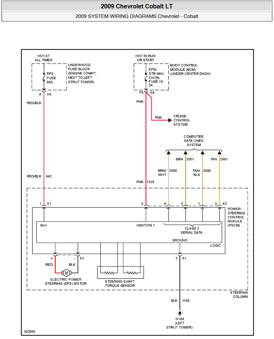

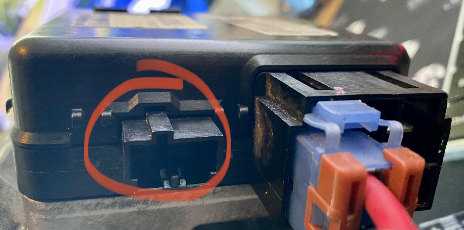

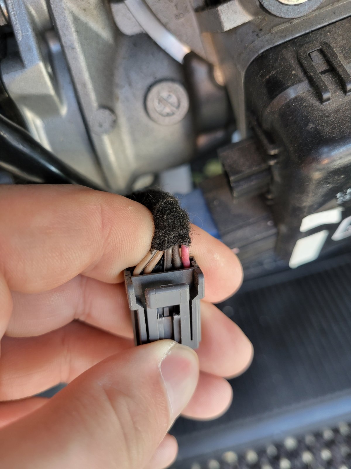

Can someone show me their power-steering data-wire plug so I can "re-pin" and hard wire them into the power steering unit? I cut mine during the build process with other plans in mind, but am adding power steering back in.
I have 5 wires, the wiring diagram the pin locations are listed below... I don't want to trial and error this, and I cannot find pin# listed on the unit itself.
| COLOR | USE | LOCATION |
| RED | Ignition | #6 |
| BROWN / WHITE | Data | #4 |
| BROWN | Data | #5 |
| TAN / BLACK | Data | #1 |
| TAN | Data | #2 |
