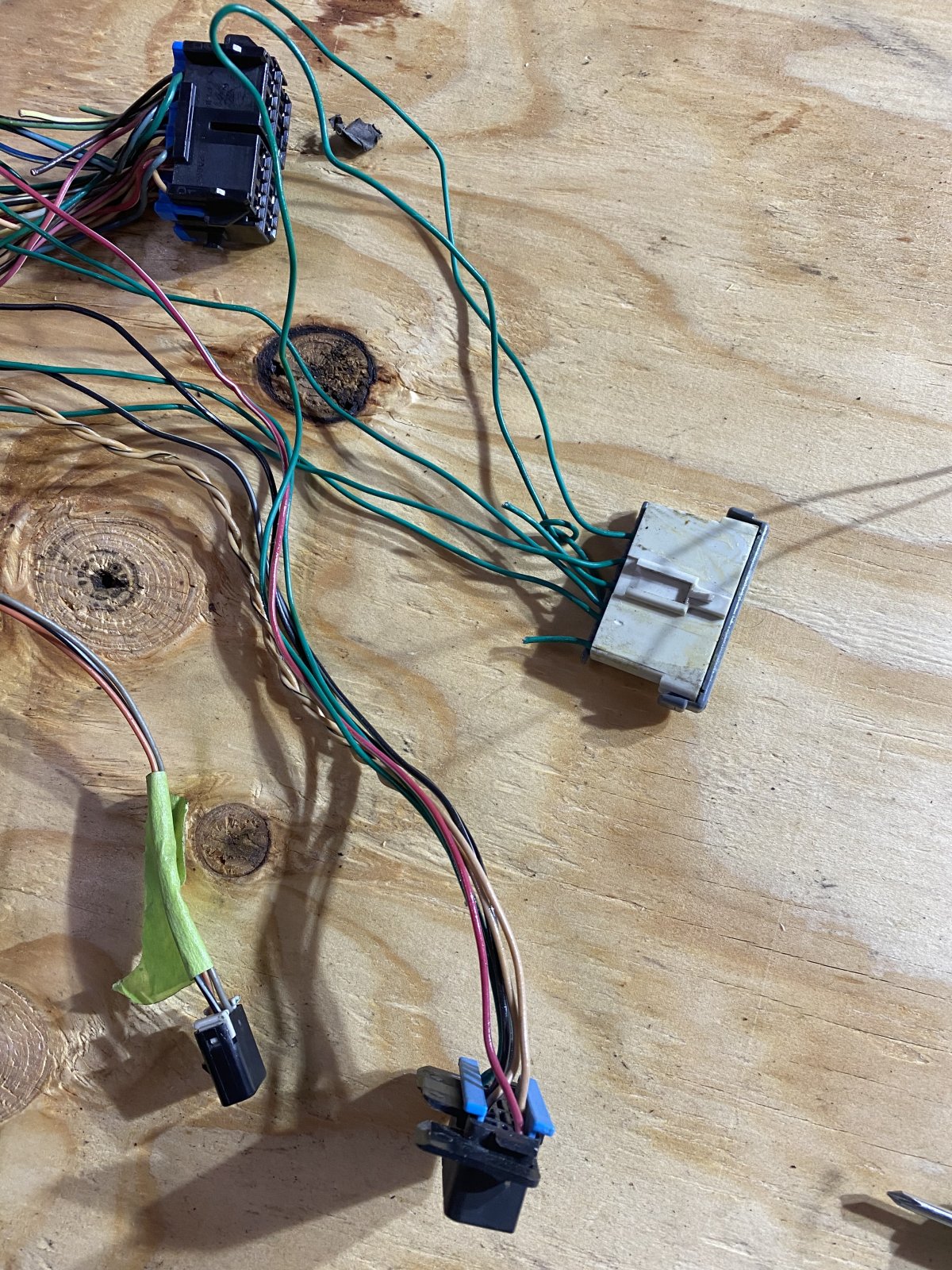

I’m not sure if this helps at all, but here’s splice pack from when I was thinning the harness. Maybe you see something.

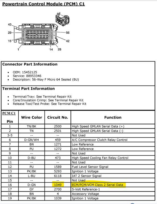

I have 4 wires in my LSJ low speed. You are missing the PCM C1 pin 16.

- PCM C1 pin 16

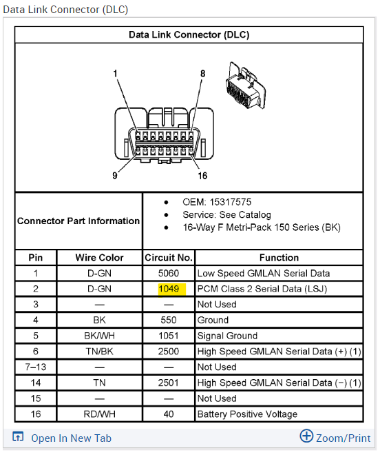

AllData shows that PCM C1 pin #16 going to the ODB port pin #2. I'll check that but are you sure it's tied into the LS Data bundle?

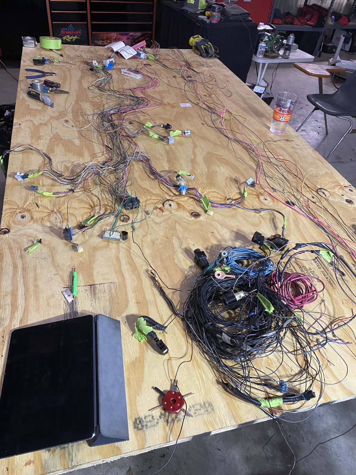

Pictures show the wires cut out and those soldered together. Does that help at all?
Thanks for that, but that's all stuff I've tried a bit. That does confirm that the two I was getting no continuity to C1 pin 18 and 36 were just completely removed.
