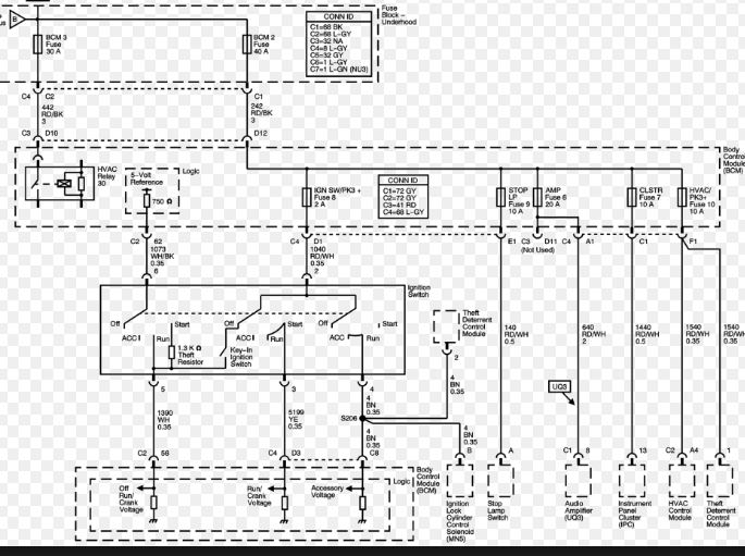

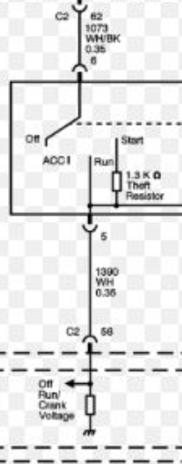

The wiring for the original key switch I found to be quite different than expected. This is the beginning of the difficulties, although it should still be very doable. The first thing I noticed is that the Cobalt has a 5V logic line for the start command and not just a simple 12V switch. I assume this is to prevent others from hot-wiring the car and stealing it.
Sorry the image is so poor, it's the only one I could find and I had to do a screen capture of it. If you notice on the far left side, the BCM has a 5V reference line that runs through one leg of the ignition switch. From there it goes to the switch where there is a 1.3K ohm resistor ( I actually measured 1.8K on mine) for the start circuit. While the car is in the Run condition, the 5V reference is fed back to the BCM until it's turned off. This is by far going to be the fun part. The rest of the circuits for the ACC and Run are simple 12V switched and the unit will work well with those.

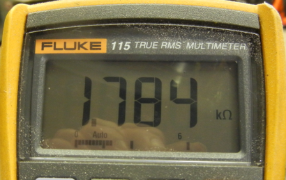

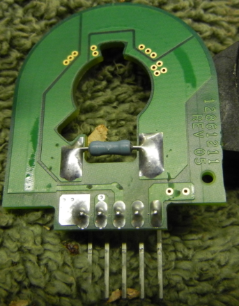

This is the Theft Resistor and what I measured.

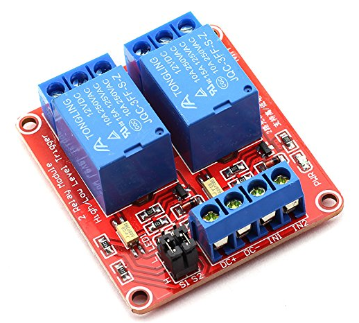

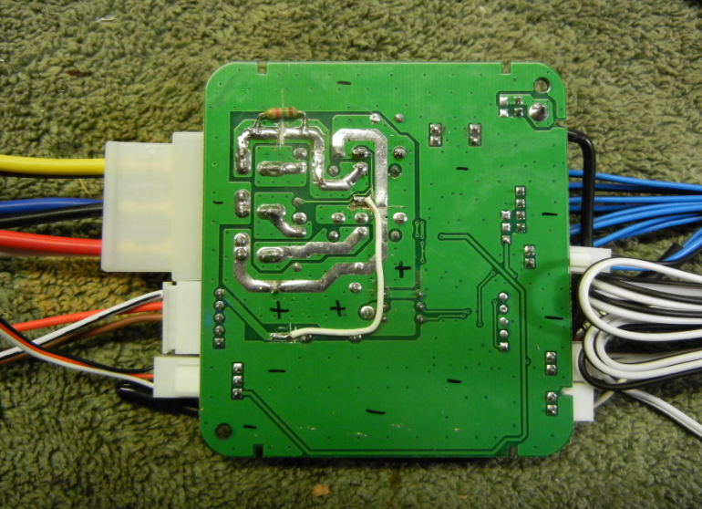

Since the push button start unit is designed to work universally, it just switches 12V to all of the outputs. As stated earlier, we are dealing with the 5V logic line. So I started to modify my circuit board in an attempt to inject the 5V to the relays instead of the 12V and include a spare 1.8K resistor I had. The hope was to make this still a contained unit and simplify things. Unfortunately I didn't fully realize the diagram of the relays until I was quite ways in to the modification. You can see them here, but there are four relays in the middle and the pin outs are really weird! In the process of using the reflow to remove one of the relays, I apparently destroyed it in the process. So I now I have a replacement on its way from Japan (read major hold up to this project).
I now fully realize there is no work around using the circuit board and I will have to move on to plan B. That will be two external relays just for the Start circuit.
https://www.amazon.com/gp/product/B0721M34CM/ref=oh_aui_detailpage_o00_s00?ie=UTF8&psc=1

Without knowing the exact inner workings of the BCM and the security circuits, I don't know how it could be made any easier. Because of the Theft Resistor, if you were to bypass it or ignore it and just jump start the engine, I don't think it will start or you would possibly be missing many of the accessory circuits for other things to function. At its core, I'm just trying to replace the actual key switch exactly as it is in the car. You may see in the diagram, there are actually three complete and isolated switches in the key switch unit.
Is there a chance that the 5V and the resistor are only used for the chip in the key?
There is a separate ring (the black plastic unit) that reads the key. This is part of the VATS system. I have that currently unplugged and the car starts fine. This was the point of the VATS thread, to prove that the VATS was actually disabled. I'm quite certain the 5V logic line will have to be functioning in order for the car to start. However, I could remove that pin from the switch to see if that is the case. If it were to start without it, that would make things a lot easier! But I just don't really think it will because there is nothing else wired to the Start position of the key switch, so there is nothing else to tell the car to start. And the resistor is not really an issue, just the signal line instead of a simple 12V engagement.

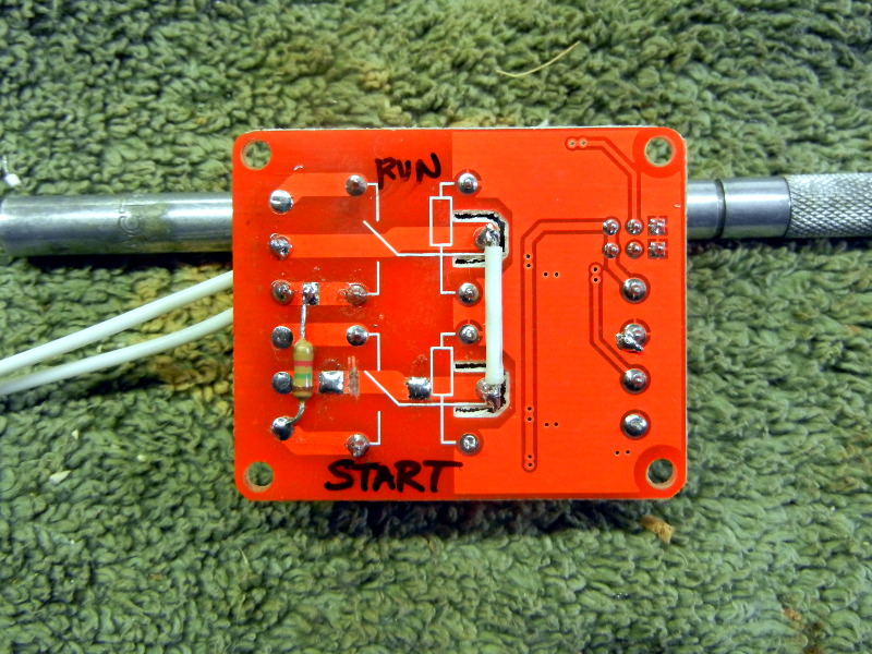

I changed out the very heavy gauge wires from the main plug to a much more manageable 20ga. I just couldn't stand the very heavy 12ga wires that are going to have to be connected to the car's 20ga and then try to wrap them up neatly. This also gave me the opportunity to add additional 12V and ground wires to power the relay board (not seen here).
From there, I had to modify the relay board just slightly. Quite frankly, it didn't have to be modified and the same effect could be had by just trying a couple of wires together, but injecting the resistor into the circuit is where the modification really helped.
I tied the COM of the relay together and the output has to be tied together. The only reason for the relay board is the need for two different paths of the signal; one path (relay) is for the RUN command, and the other path (relay) is for the START command (with resistor)

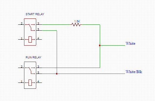

What would a wiring diagram for that look like?

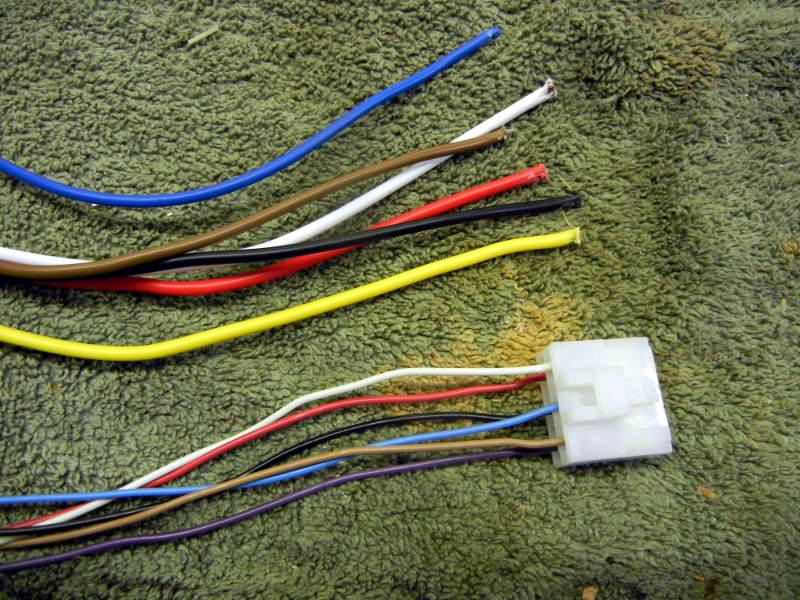

This is what it would look like. You will have to use two automotive relays because of how the start system works in this car. The start command uses a 5V reference and not a 12V. Also the start command is looking for a resistor around 1.3K-1.8K in my experience. I used a 1.5K without any issues so far. Your car may be different???? The resistor is found inside of the black switch and the end of the key switch unit. The pinout referenced here are the on the connector (see photo) on the black key switch.
The ACC and the IGN/RUN will be toggle (latching) switches while the START will be a momentary push switch. To start the car, one needs to turn on the ACC and the IGN/RUN switches (I don't believe the ACC has to be on in order for it to start). The engine will or will not start according to the safety circuits of the clutch/shifter, etc.
I have not actually wired it up this way and there is always that possibility of something not as one might think, but I have successfully wired up my more advanced system using the same diagram and understanding and it's working fine.

This is very helpful, thanks. I’m working on this now and it will be very basic. No key fob, just an ACC switch, IGN-run switch, and push button start.
I just don’t understand what your “run” relay is doing in the above schematic. Once I switch pins 4&5 to 12V it should be ready to start. Pin 30 of the “start” relay to pin 6 of the wiring plug should utilize your 1.5k resistor and run the starter. What am I missing?
JSATX
Actually never mind I think I see it. You have wire 5 connected to wire 6 directly until the start button is depressed, changing the resistance of wire 6 and starting it. I think.
