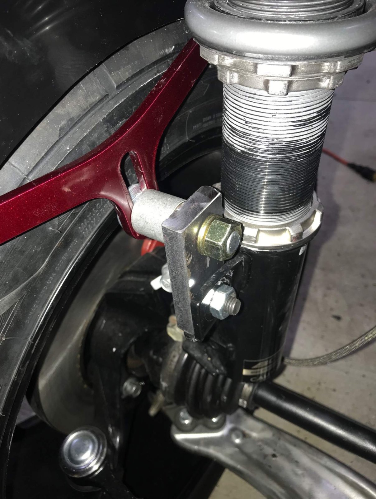

Does anyone have photos on the rear fenders installed with the coil over springs? Not clear how it's supposed to work, seems like there isn't quite enough room to make it fit.
CaptFrank2001

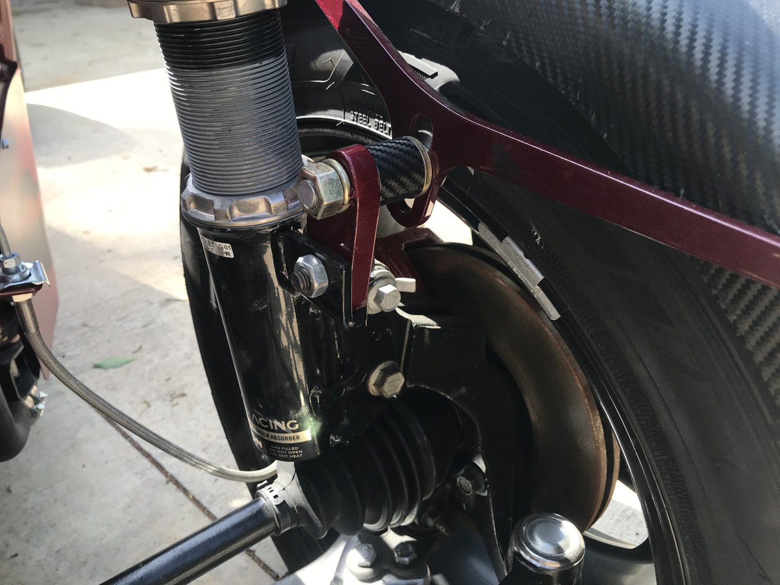

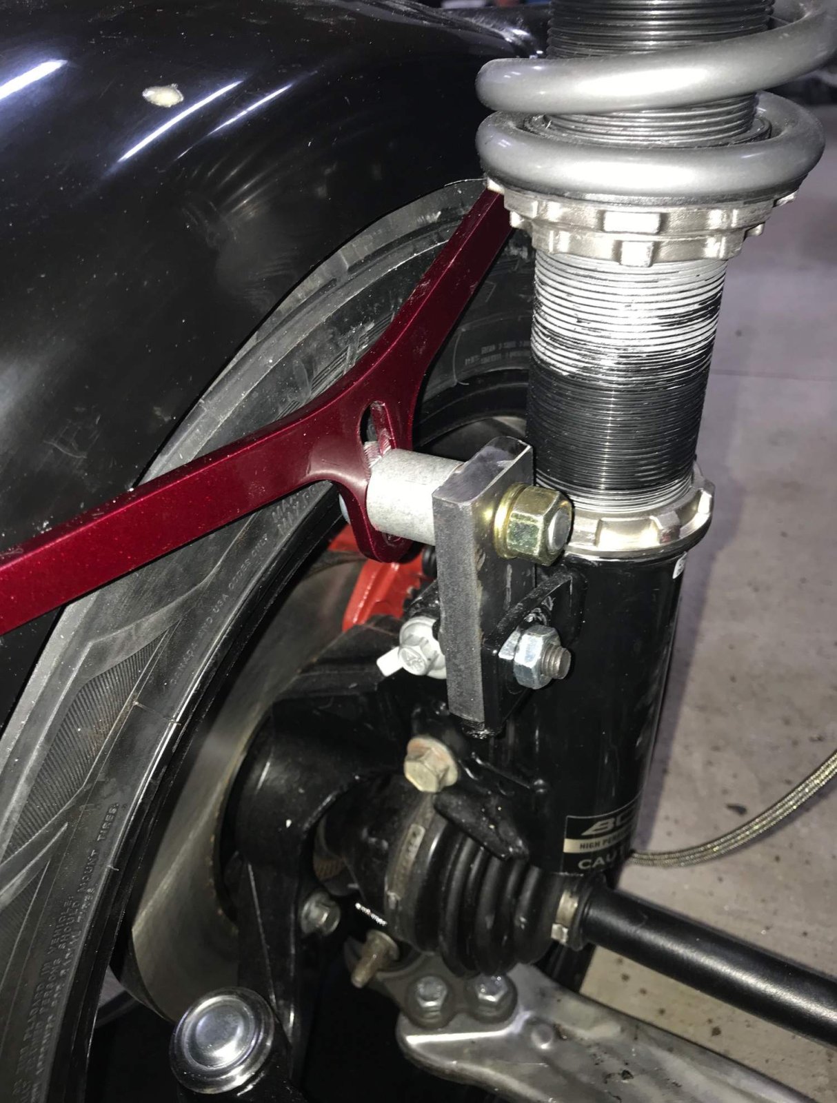

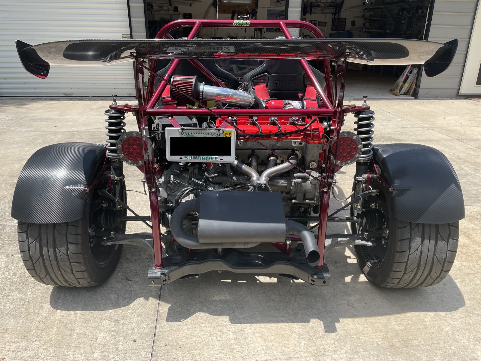

I put on larger tires and had to widen the rear fenders. I had to make my own custom adapters to make it all fit. Maybe these will help you out. Good luck.
