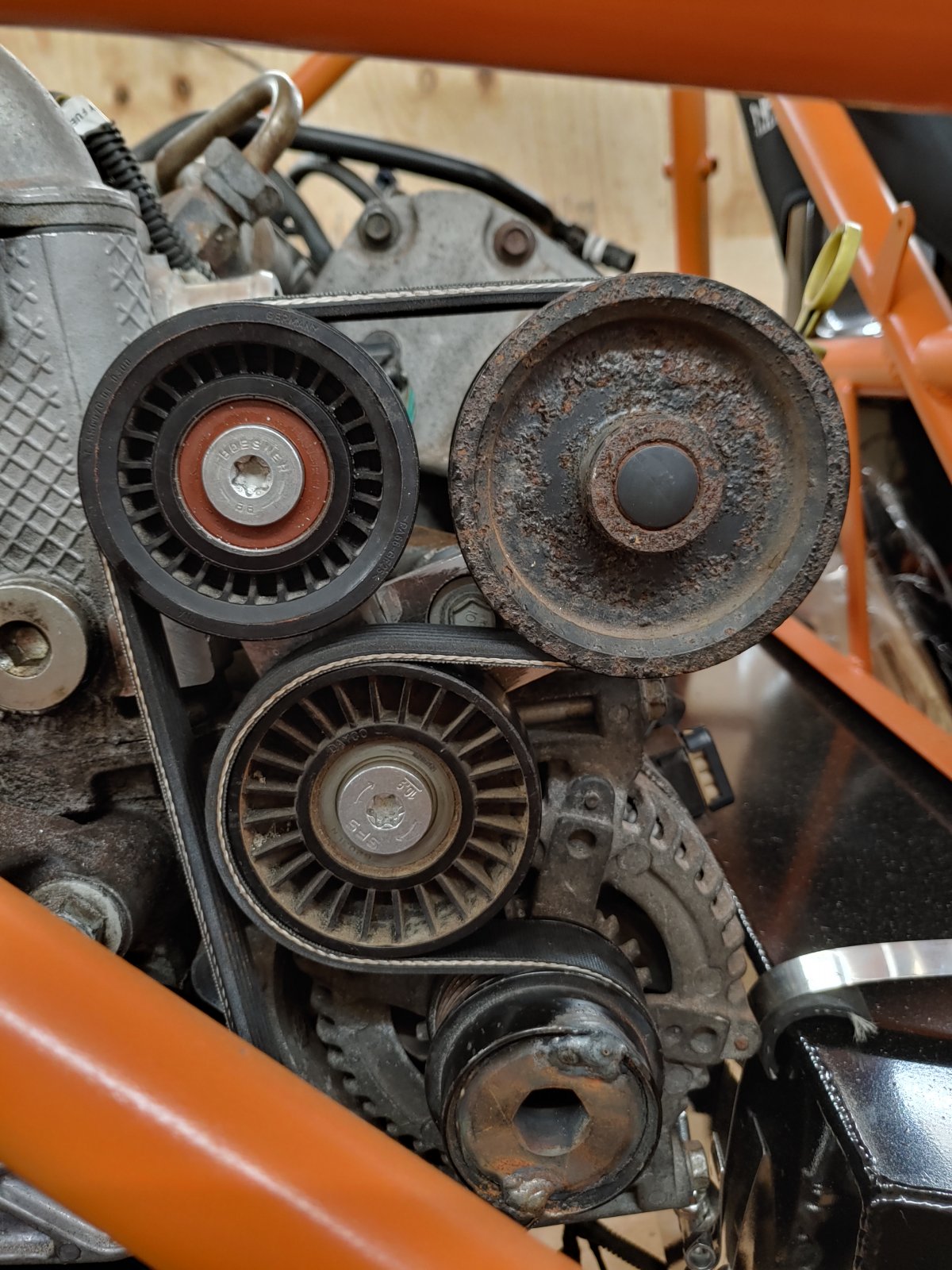

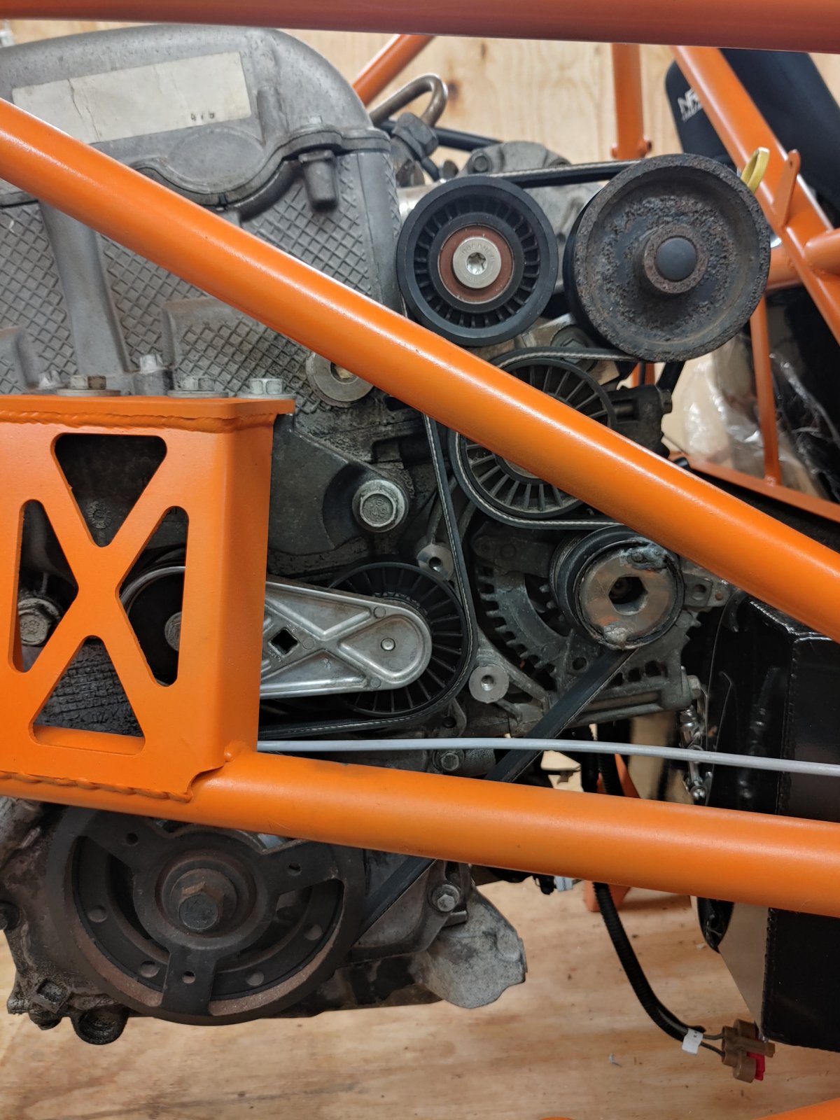

I thought about it. One of the biggest drivers of my consideration is that there's not a straightforward way to entirely eliminate the AC compressor on an LSJ due to belt routing. I gutted my compressor (actually following Ross's advice, if I recall correctly).

You can completely remove the A/C pump..
I have read this but I was more looking at the option of keeping it and utilizing it to my advantage.

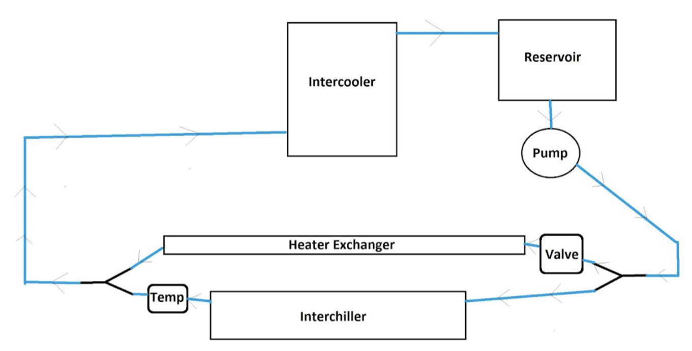

I reached out to FI Interchillers not to long ago to discuss a road racing application.
The main problem is volume of cold water that can be stored. They recommended a 5 gallon storage tank and to run the interchiller in series with an Air to Water intercooler.
Also, the AC compressor disengages at high RPM, so it would need to be under driven.
Here is their response:
The AC compressor cannot do engine RPM.
In addition, if you did underdrive the compressor to then be at a normal speed it's a case of try it and see we don't know your heat load vs cooling capacity so we do not know what temperature it will level out at.
Under normal circumstances (drag racing/daily driving/mile racing) we are cooling a volume of fluid down and then relying on the volume of fluid to see us through the period of wide open throttle.
For circuit racing what we do suggest is:
Run a 5gal tank combined with the chiller
Retain a front mounted water to air heat exchanger on a temperature controlled bypass valve.
When the fluid temp is 70f as example the fluid will split 50/50 heat exchanger and interchiller.
When the fluid temp is under 70f the fluid will be 100% interchiller, see below image.
