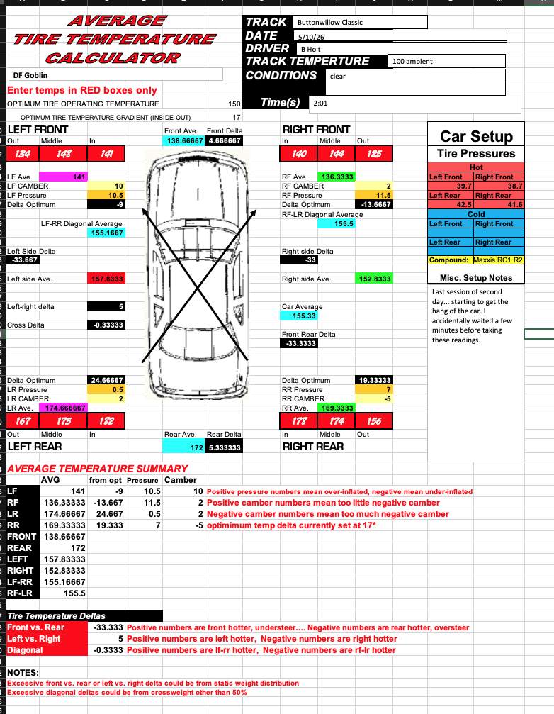

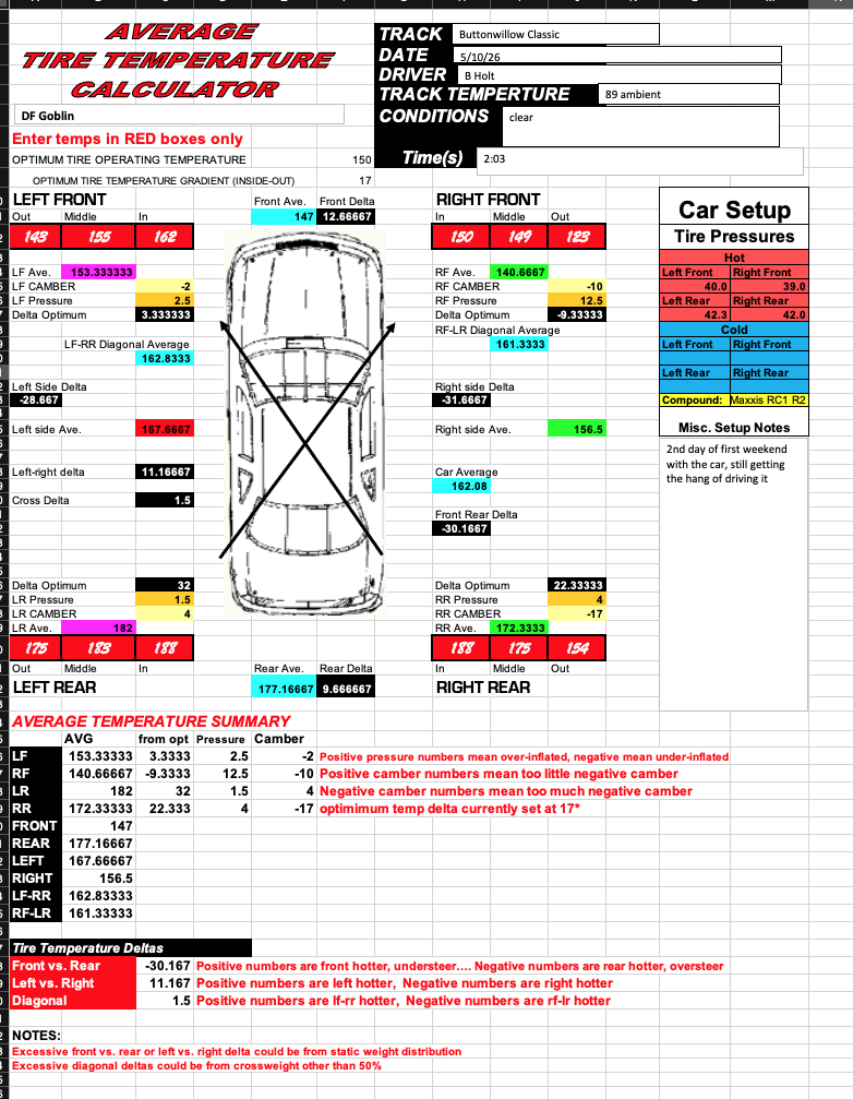

I'm not running the tubular subframe, but I'm running 300# F/R with the following alignment settings:
Front camber: -1.8
Front toe: 1/32 in
Rear camber: -2.2
Rear toe: 3/32 in
Wheels/tires: 15x9 w/ 225/45 RC-1
Here's my pyrometer data, I need to gather more data and average it, but other than decreasing tire pressure 1-2 PSI, the data seems to say this is in the ballpark. Data says I could use a hair less camber, but I don't plan on decreasing camber as there's still a lot I'm leaving on the table since I'm currently learning how to drive the car, and I'll definitely "grow into" the extra camber as I get quicker. A couple notes, look at the temperature summary area for digestible info, and I currently have optimal temperature gradient set at 17*F.
