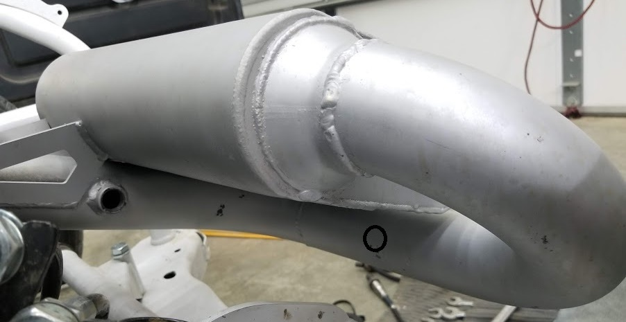

The wideband O2 sensor goes in the exhaust pipe. The factory narrowband O2 sensor in the exhaust manifold/header stays, but the next O2 sensor is the post-catalytic converter O2 sensor, which we will remove, and put in our wideband sensor. It goes in the exhaust pipe bung:
15881
To make my O2 sensor last longer, and not overheat, I also bought this Kinugawa Thermo-Isolating O2 Bungs (Screw In). $32, but I could have welded an new bung further away from the exhaust ports, where the black circle is in the picture.

My wideband sensor recommended at least 18" away from the exhaust ports. Closer gives less lag in your O2 readings, but also gets the sensor hotter, which shortens its life. Dyno tuner guys just stick it in the end of the tail pipe, as they are tuning for wide open throttle, and don't care about lag.
