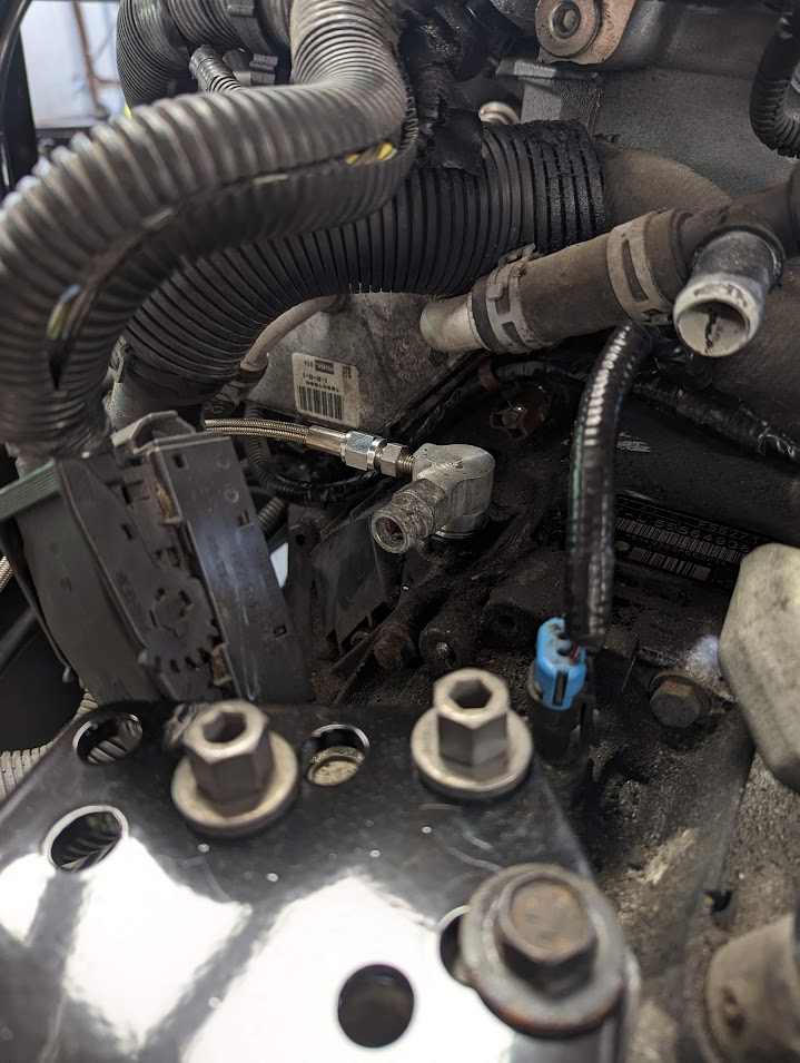

Can anyone snap a couple of photos close up of the blue and black Reverse Sensor Connector? It should have a pink and a yellow (Neon green maybe?) wires coming out of it. It's on the top of the transmission under the fuse box and close to the shift mechanisms.
This is the best shot I have on my phone, if you need a different angle, I won't be able to get it until this weekend.

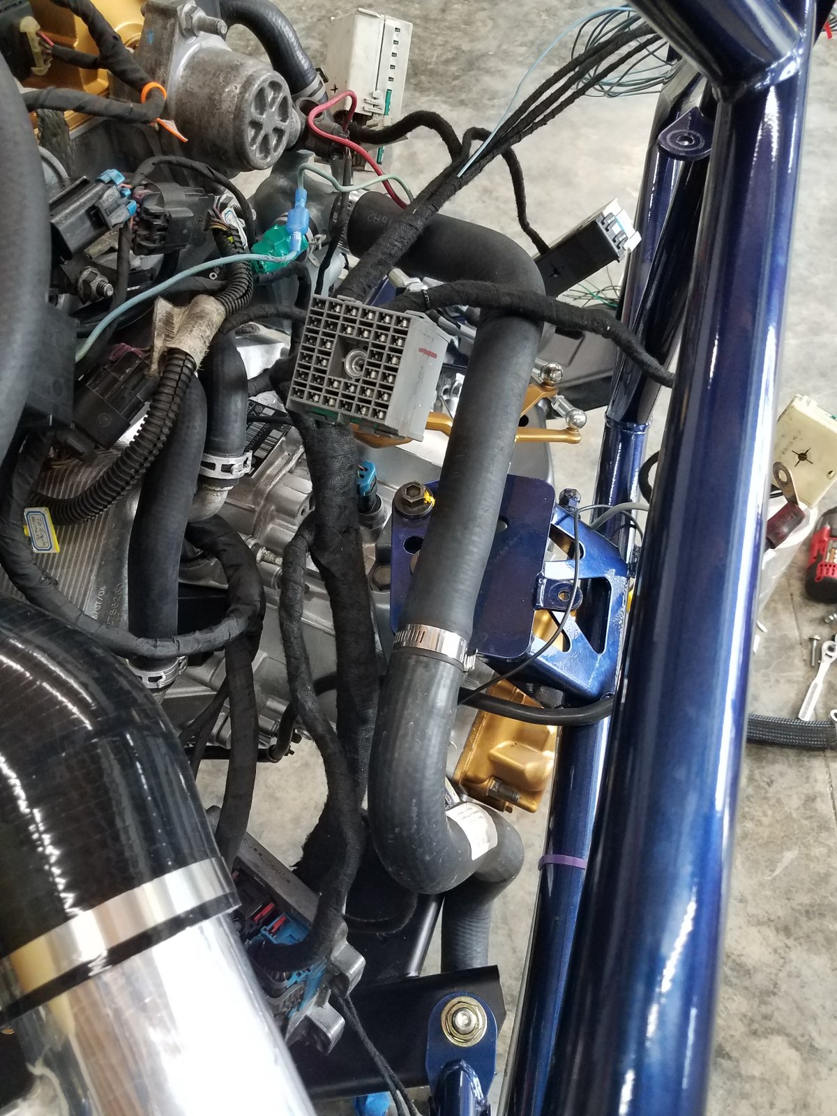

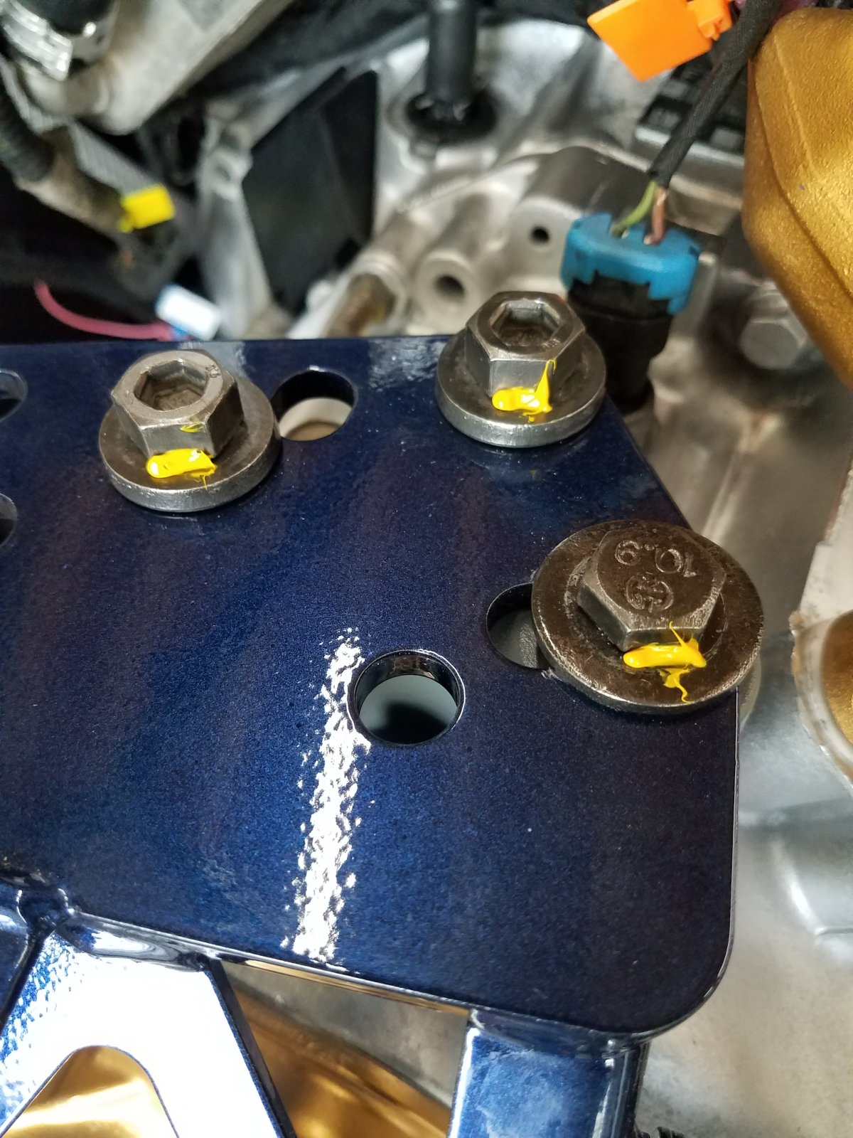

I think with a combination of the photos I can get what I need, that last one is pretty clear though. I ordered a new connector and just need to see which wire goes to what side. This connector I'm having a hard time to find on AllData.

FYI: Pink and Yellow twisted pair is speedo sensor, Tan and Lt green is reverse sensor. These pix show F35 reverse sensors. Speedo sensor plug is similar and may plug into the reverse sensor unit!
FWIW: The speed sensor is close to the reverse sensor! Speed sensor is further back and down, near the D/S output. The actual plug for the speed sensor is the same as the ambient temp sender under the driver side headlight.(different harnesses, so it is hard(impossible?) to mistake AT for Speed.)

The pictures the guys provided above are the correct sensor plug that I'm needing. Thanks everyone, this issue is closed for me.
