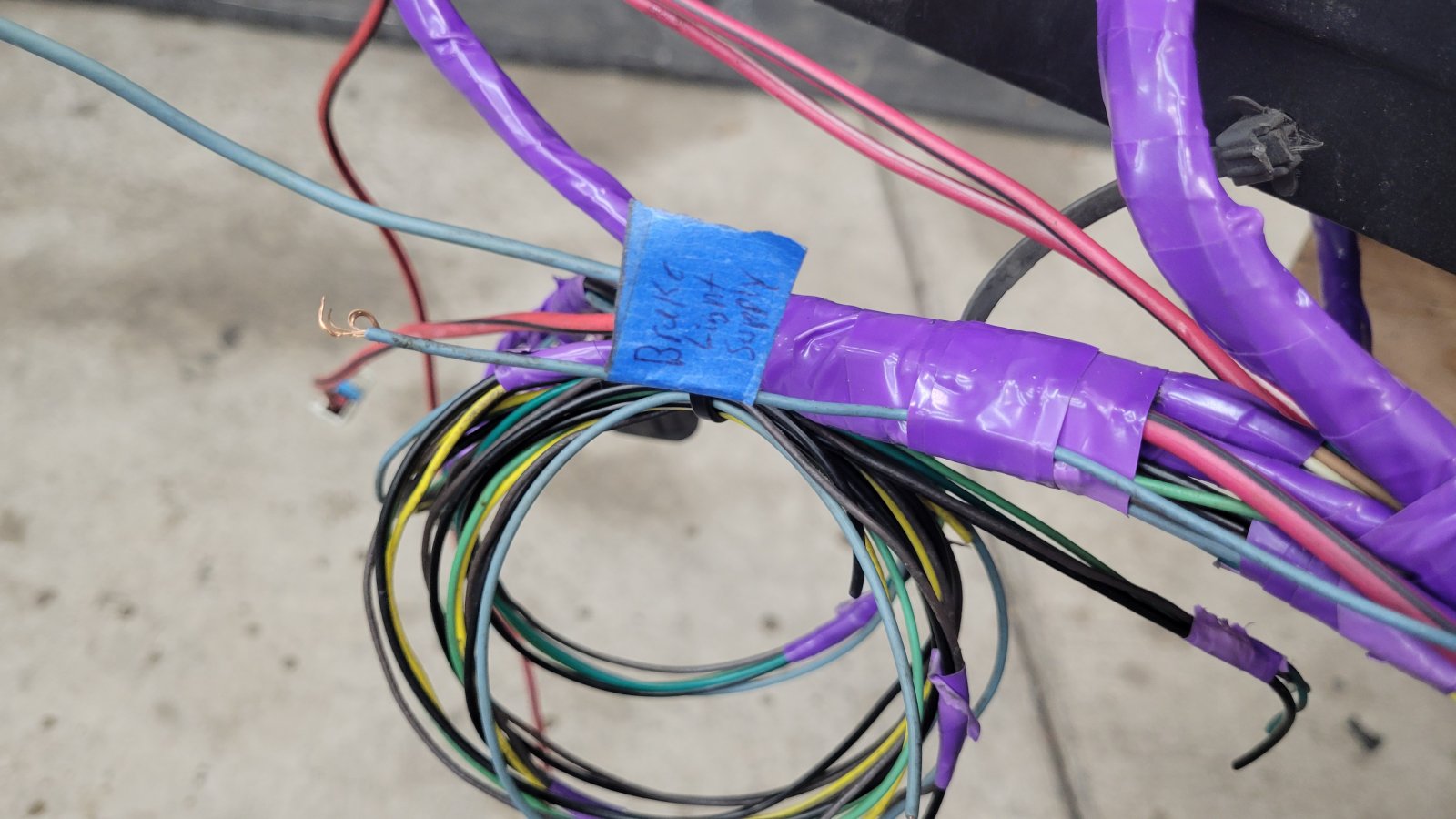

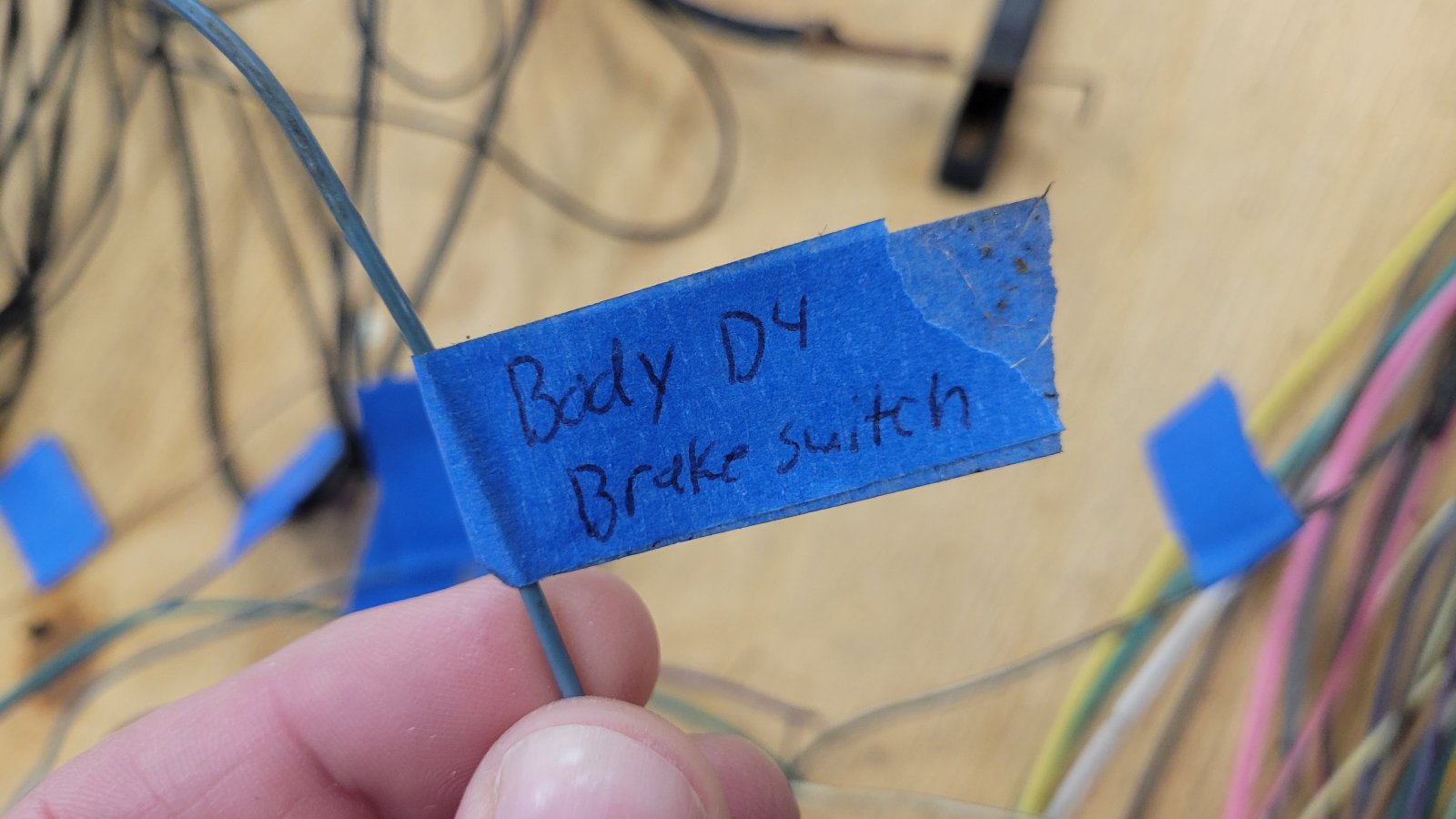

New builder here. Having some trouble with a few extra wires left over from organizing the harness. I have a couple light blue wires that are connected to F3 and F4 on the fuse box C5 connector. One I labeled as body harness D4 and they are both showing as brake supply voltage. Any idea if these are needed?

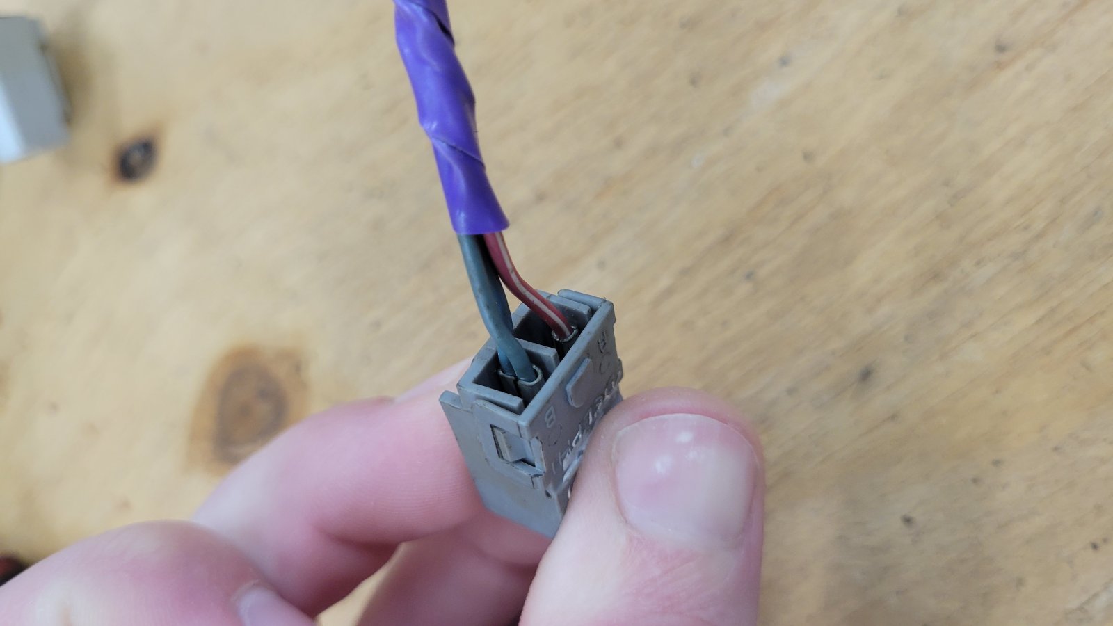

I also have an extra light blue wire coming out of the one brake pedal connector. There are 2 light blue wires connected to the same pin. Can I just remove one?

I did find some schematics and it looks like F3 and F4 go to the EBCM and the high stop lamp (3rd bake light). So I'm assuming I don't need either of those?
Looking for that brake pedal connector to see what those 2 wires are in the one pin.

3rd brake light wire is needed to operate cruise control if you have / plan on using it. Some, myself included, installed a 3rd brake light for more visibility.

Ahh got it. I do like the idea of a 3rd brake light. Not sure I would ever use cruise control anyway.
