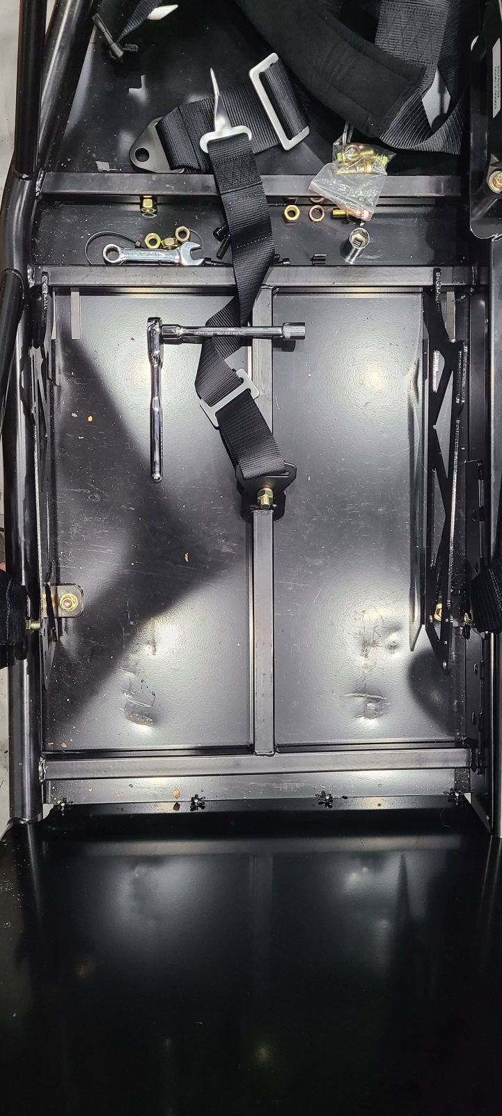

So no matter what configuration I am doing with the seat brackets nothing is lining up. How did you all mount the seat brackets. I have corbeau fx1
Kenny123
Here a shot of how we have the driver side
RouteAbel
I’m in the same boat, nothing lines up for me either. Even if I could get it to line up it would have my seats too far back. I have the extended frame so not sure if that factors in here.
ccannx
I skipped brackets and ended up welding u-channel all the way across the rear, could have just bolted it to the Df goblin tabs. Wound up cutting the front hooks off the stock seats and bolted right up to the sliders. The seat hooks under the front bar and mounts to the rear U-channel and can be adjusted side to side if needed.
