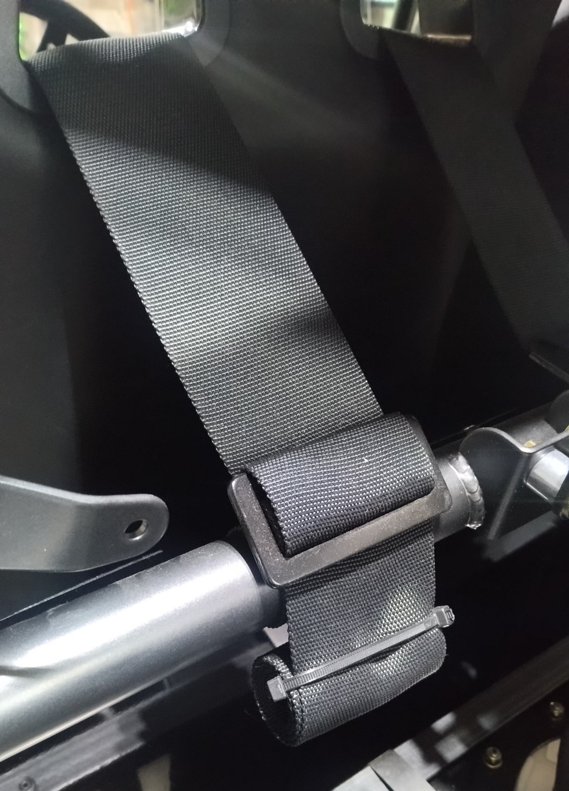

P PHENDERSON Well-Known Member P PHENDERSON Well-Known Member May 24, 2022 #1 Does anyone have pics of how the Corbeau harnesses are attached to the Goblin behind the seats?
G Gtstorey Goblin Guru G Gtstorey Goblin Guru May 24, 2022 #2 I assume they wrap around the bar? If so just google bar wrap safely harness and you will find how to do it properly.
ColoradoCryptoTrader Well-Known Member ColoradoCryptoTrader Well-Known Member May 25, 2022 #3 i did like this using the hardware that came with my Racequip belts
SmsDetroit Goblin Guru SmsDetroit Goblin Guru May 28, 2022 #4 Just remember to roll up the extra length don’t cut it. Some tracks won’t let you on of you cut anything off your harnesses even if it’s extra
