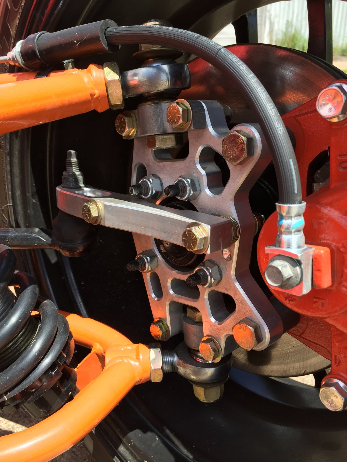

It seems like my lower control arms are not wide enough to fit over the frame. I have the single bend tube towards the front, shock mount pointed down. The distance from one face of the rod end to the same face of the other is about 10.5", but the distance across the bushings welded on the frame is about 11". Am I missing something here? Seems like all the pictures/video I have seen show the control arms being flush with the frame.
Torchandregdoc
It seems like my lower control arms are not wide enough to fit over the frame. I have the single bend tube towards the front, shock mount pointed down. The distance from one face of the rod end to the same face of the other is about 10.5", but the distance across the bushings welded on the frame is about 11". Am I missing something here? Seems like all the pictures/video I have seen show the control arms being flush with the frame.View attachment 15919View attachment 15920View attachment 15907
This was covered in Sasqwatch's build log. Just stretch it out. They draw in a little when welded.
