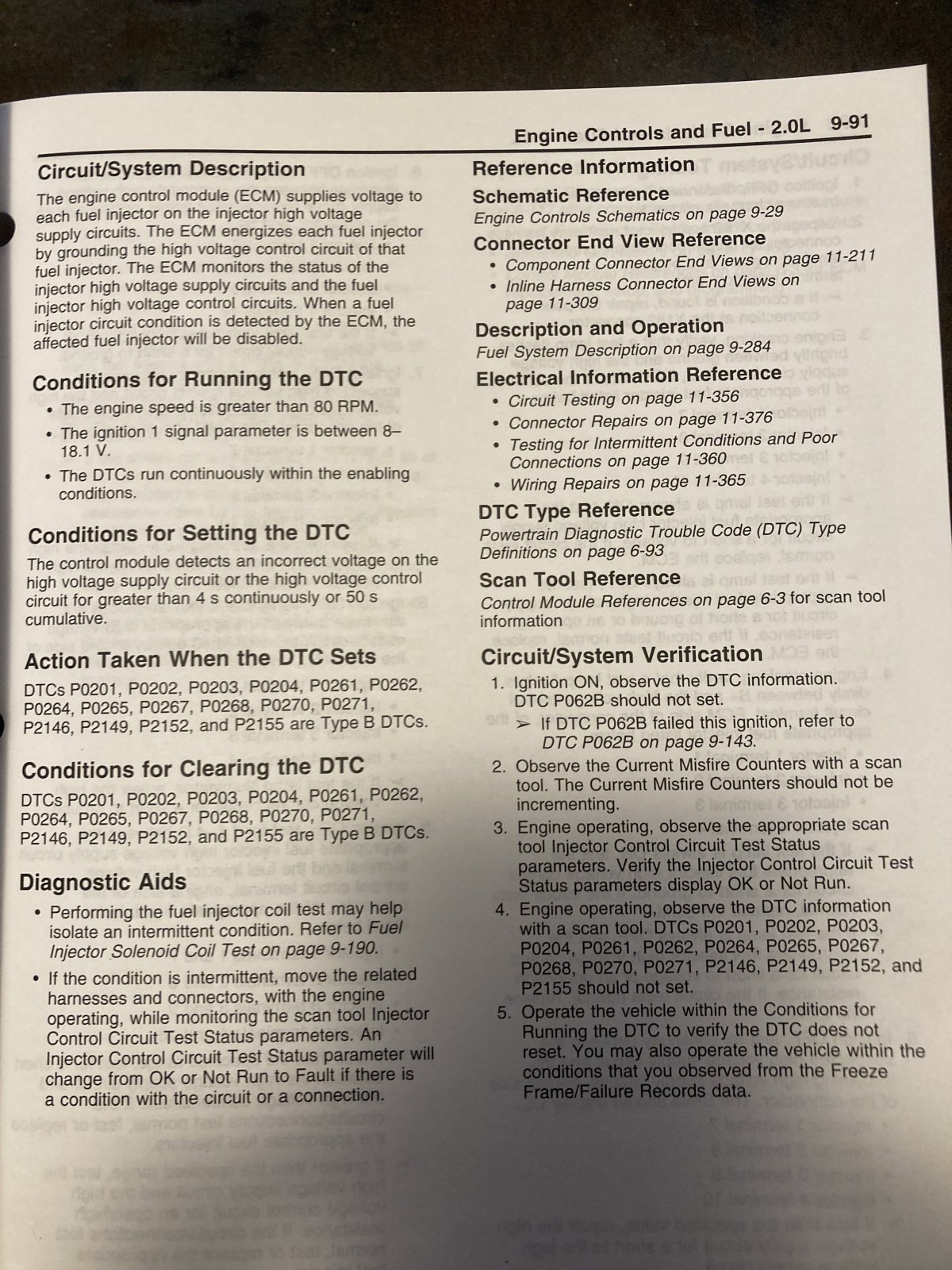

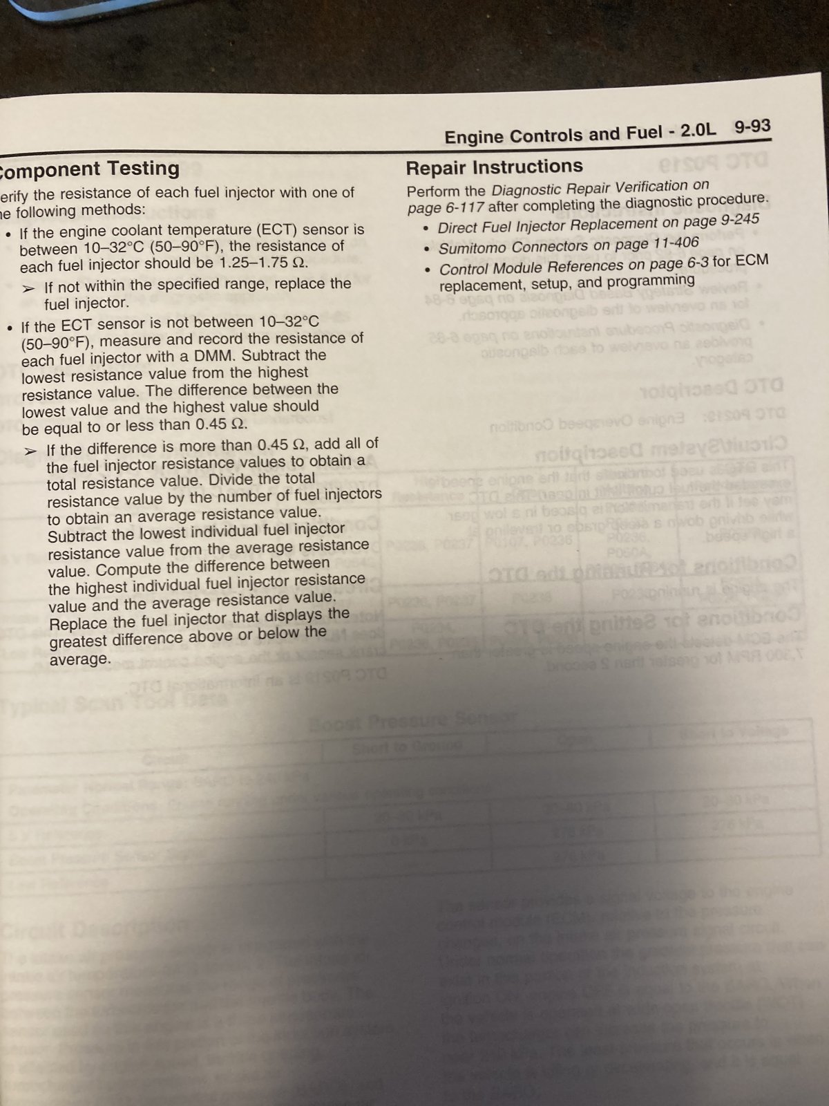

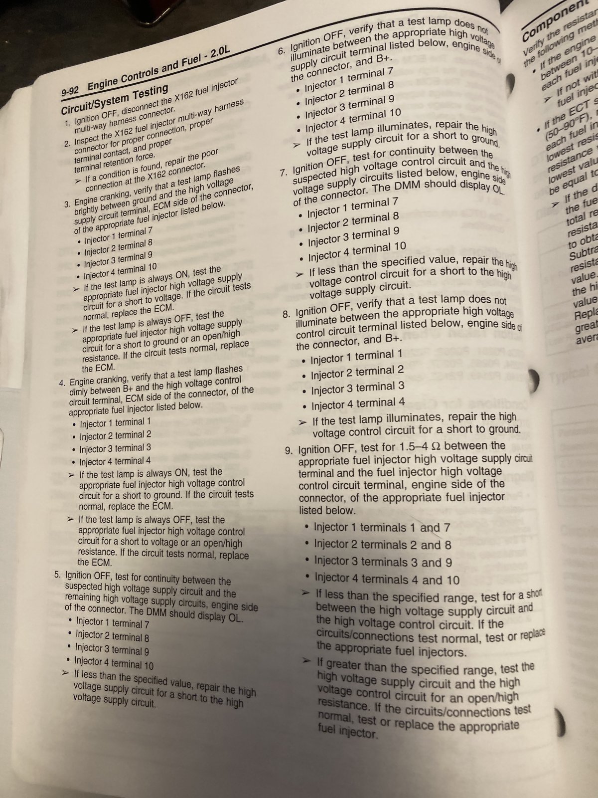

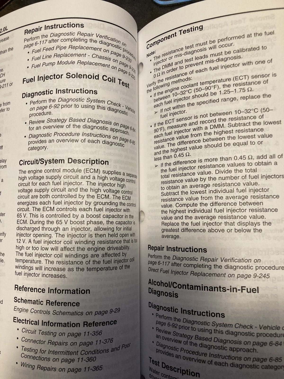

Nice. Now you are narrowing it down. Not sure on the #4 injector problem. Gotta kind of start over. Could be as simple as a coil or injector. Don’t discount wiring though.
The others codes are caused by the p0204.

I started out looking for loose/intermittent connections. I found that, when I would clear the error codes, the car would run smoothly for around a minute, then the P0204 code would come back and it would run rough. Moving a harness around or jiggling a connector didn't seem to make it worse or better.
For my next step I used the troubleshooting guide provided by Gtstorey in post #143 (thanks so much!). I didn't have a troubleshooting light, but have a DMM so used that instead. Step 3 on Circuit/System Testing is looking for the signal at the ECM side of the X162 connector. I found that under cranking I had a good signal for injectors 1-3, but there was no signal for injector 4. Hmmm... We've checked the engine harness for continuity between the ECM and the X162 connector, so seems like that signal may have a problem coming out of the ECM.
So at this point I'm leaning toward ordering a new ECM. Looks like it would be about $700 to get one from Flagship One. Any additional thoughts? Thanks again for your thoughts and advice.

I still think it's strange that you got one injector to work by fixing a bad connection but not the other. I guess the bad ground may have caused one of the drivers to overheat. Have you back probed the wiring at the ECM while connected to confirm no power to the injector?

- Forum recommended checking wiring and grounds. I found the ground between the engine wire harness and the block to be loose. Upon tightening, the car would start and run but continued to have a misfire code but only on injector 4. I confirmed using the GTStorey's procedures that I wasn't getting a signal to injector 4.
- Per GTStorey's recommendation tried to back probe the ECM connector but found that either my probes aren't long enough or the connector is sealed, so back probing wasn't successful. Didn't want to try to pierce the wire in the engine wire harness.

- I used GTStorey's procedures again this time had positive signal to all 4 injectors at the engine wire harness connector.
