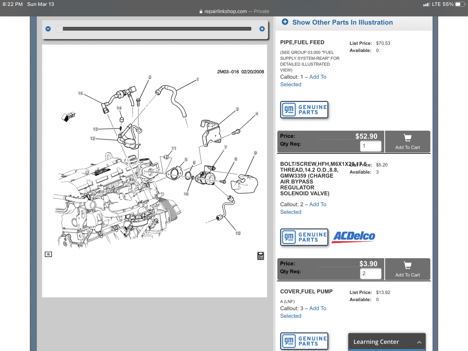

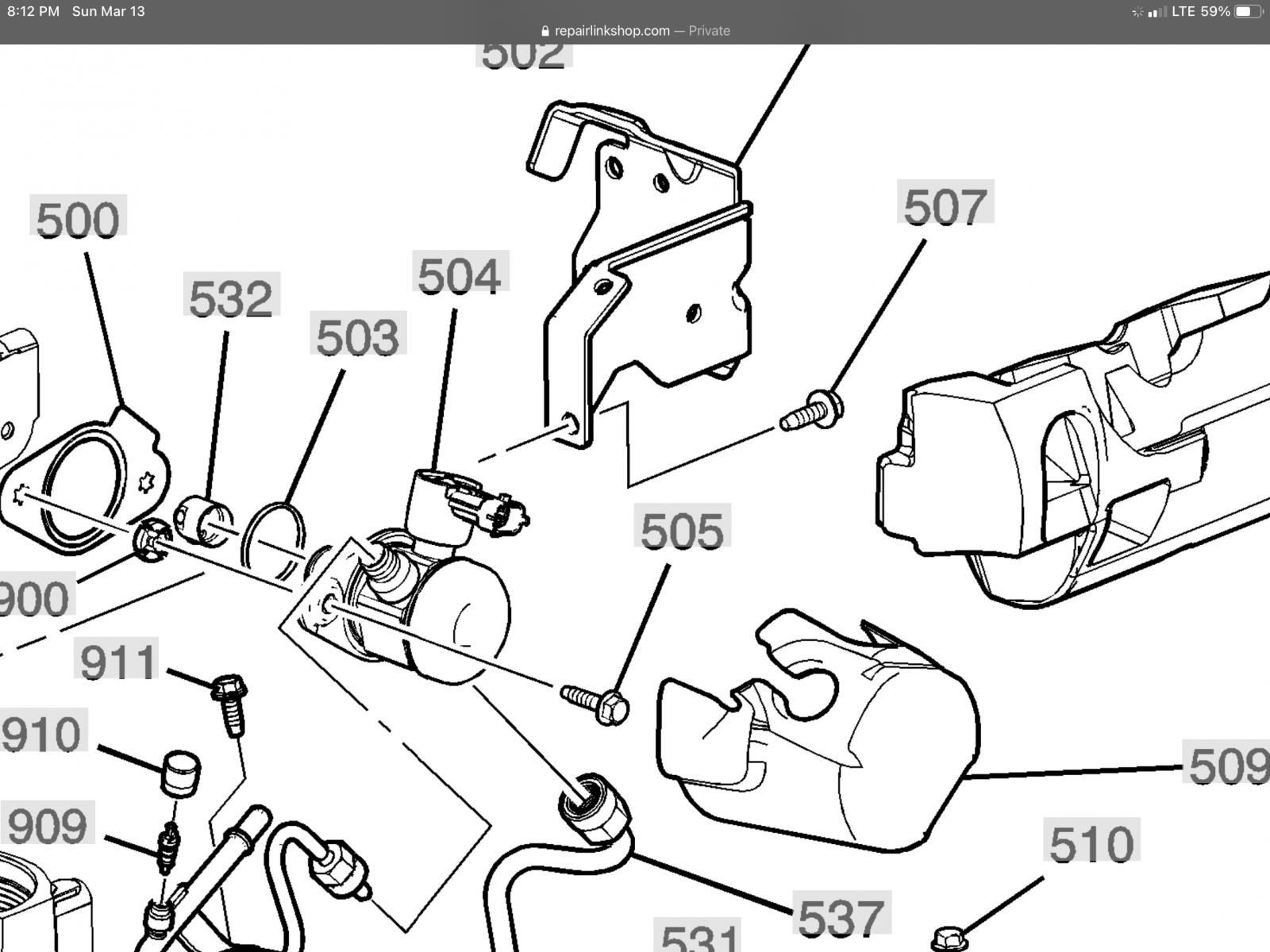

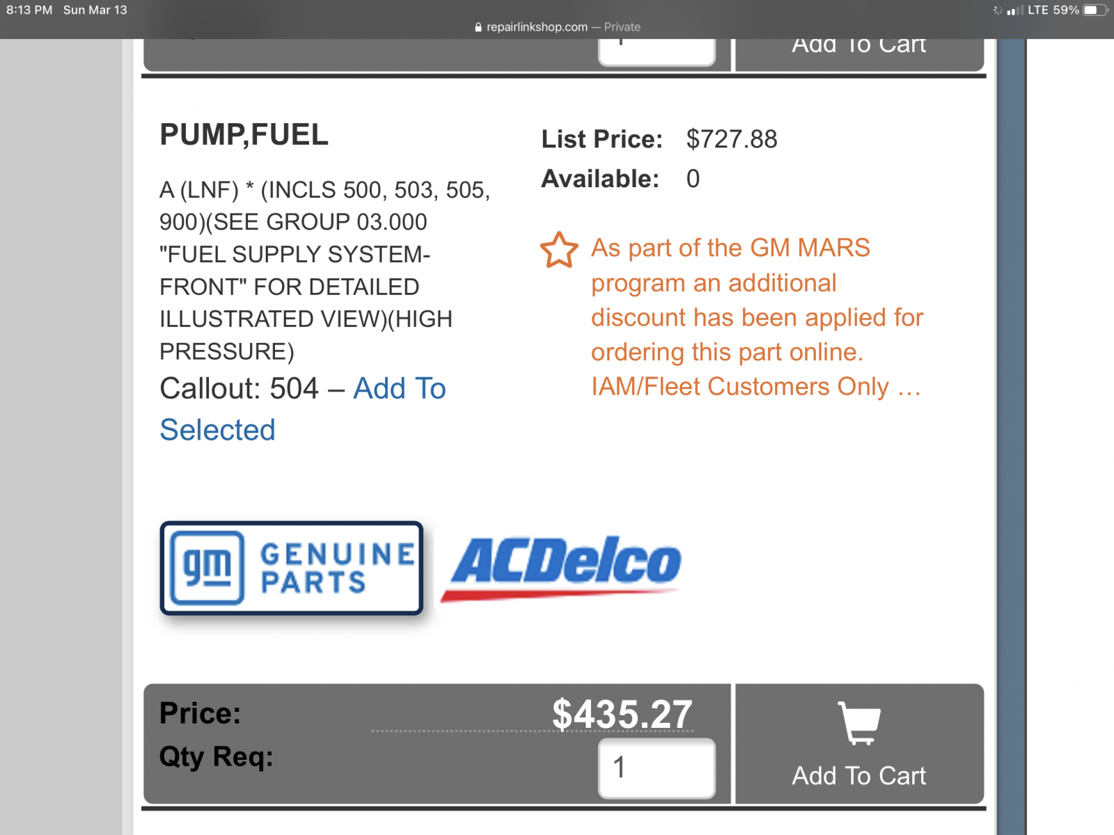

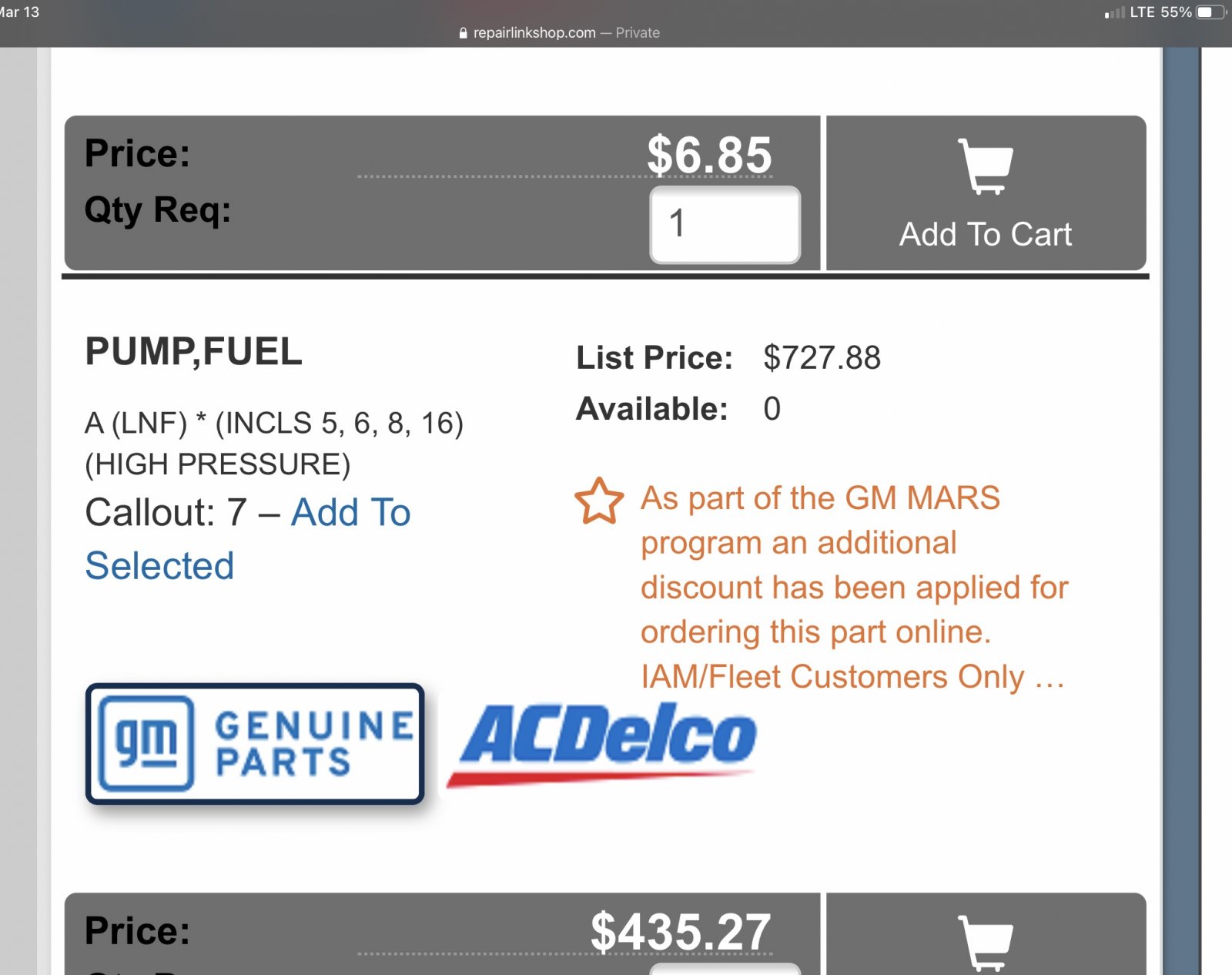

The SS/TC cam-driven fuel pump has a plug on it, I broke this plug during my engine reinstallation this weekend.
Question: Can I replace just this sensor? I cannot find it on a GM parts list, just the pump assembly itself... really not wanting to spend $200+ just for a new sensor.
I would guess that it isn’t designed to be replaced. Doesn’t mean that you can’t soldier wires to whatever is left.
But I haven’t tried to take one apart.
Yep. Looking up “fuel supply system front”, you get the same thing, unfortunately.

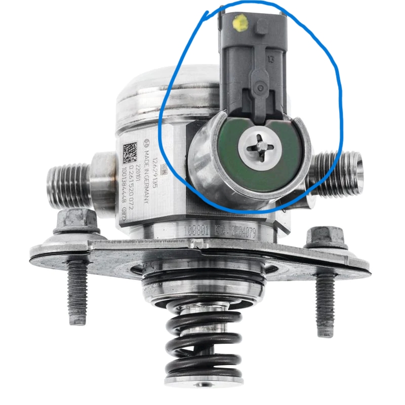

If you just need the sensor, buy a cheapie off ebay and remove the sensor. The GM parts list identified it with its own part number so it has to be removable. :D Example from ebay:
