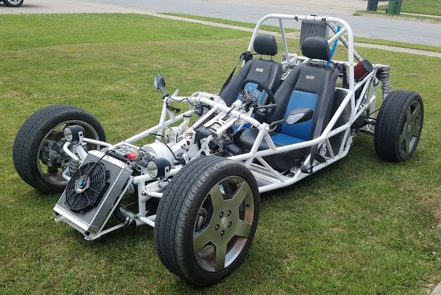

I started with a very inexpensive build, and then upgraded afterwards. My objective was to get it driving and road legal first, then come back and make it nice. Here is my basic, legal car for a starting point:
32780
To keep it cheap, it has no body, Cobalt tires, wheels, hubs, Cobalt seats, Cobalt shocks and springs on the rear. Ebay motorcycle lights, mirrors, licence plate holder/light, trailer tail lights. Then added the nice stuff later. Luckily, I drive to Dallas every year or so, so shipping isn't an issue for me. I should have ordered the full cage frame from day 1... my wife likes it much better.
