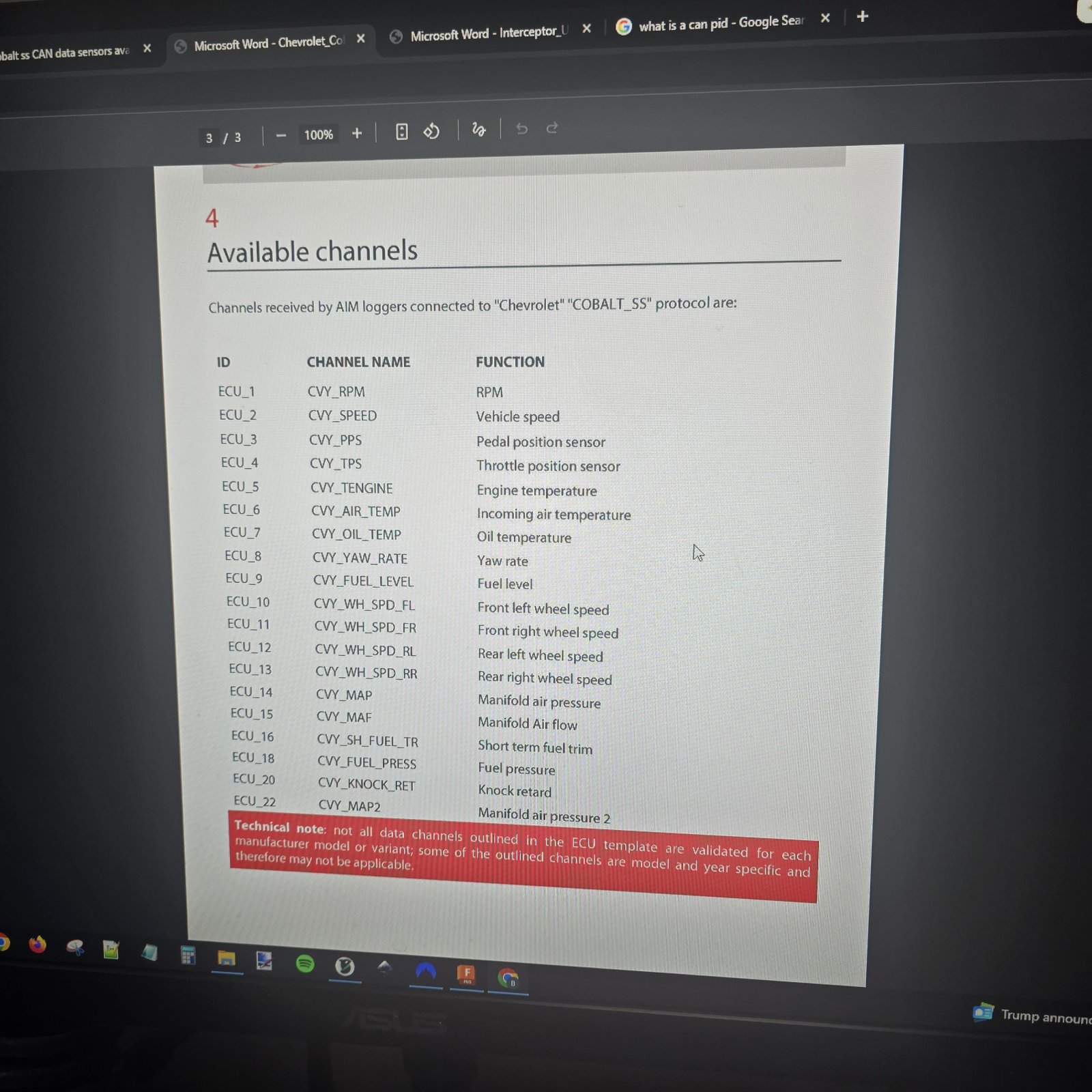

Really depends on what CAN PID's are included in the CAN data stream and what you plan to add manually, as well as the PID and channel capability of the particular dash. The aeroforce supposedly supports a bunch of PID's, where the AIM (pictured) is somewhat limited by both channels and PID's for Cobalt-specific application.
As far as additional analog channels, I retrofitted an oil PSI sending unit and am running that through a programmable analog channel, as the Cobalt only uses an oil PSI switch. I also wired the security indicator, turn signals, low coolant, brake warning and high beam indicator through the analog channels.
