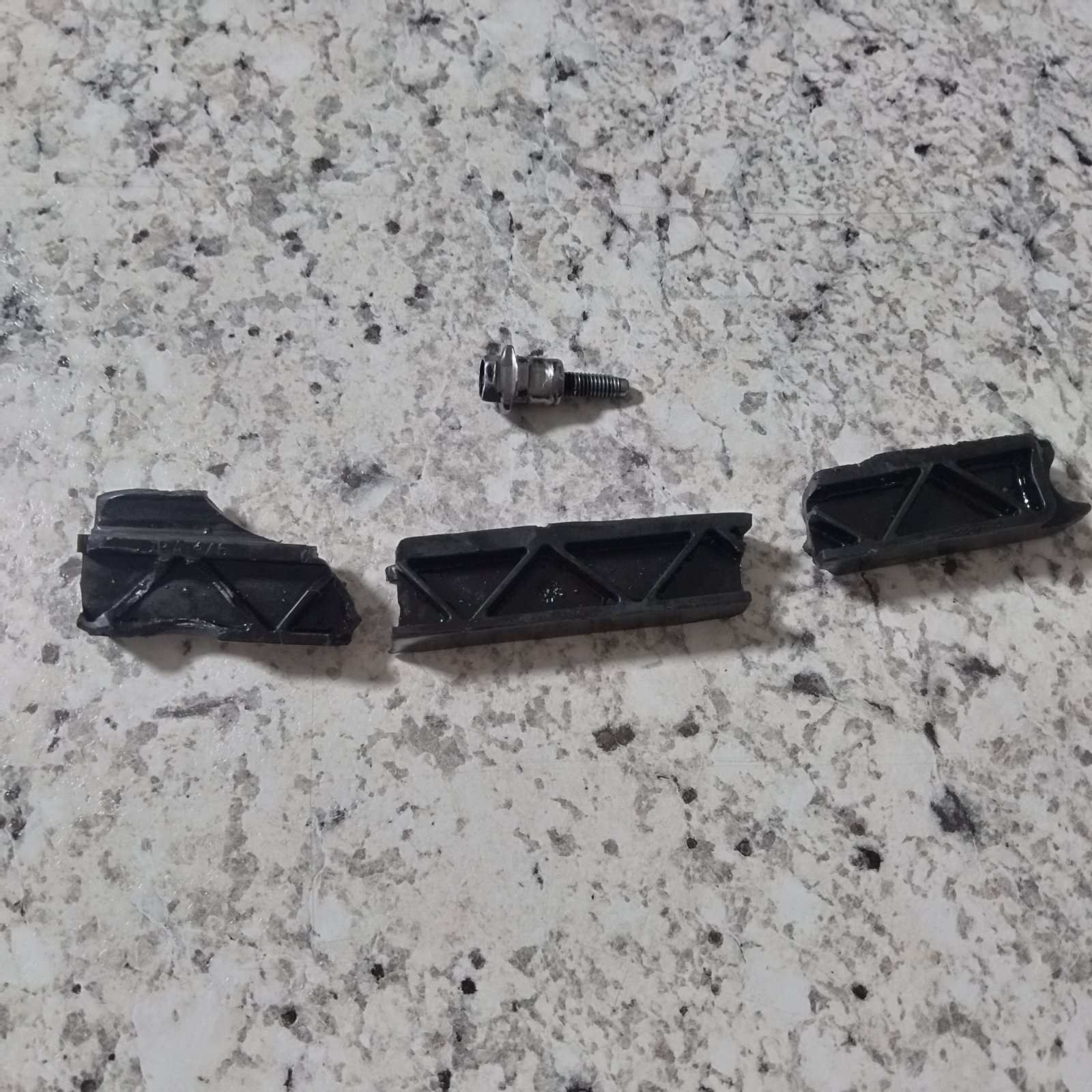

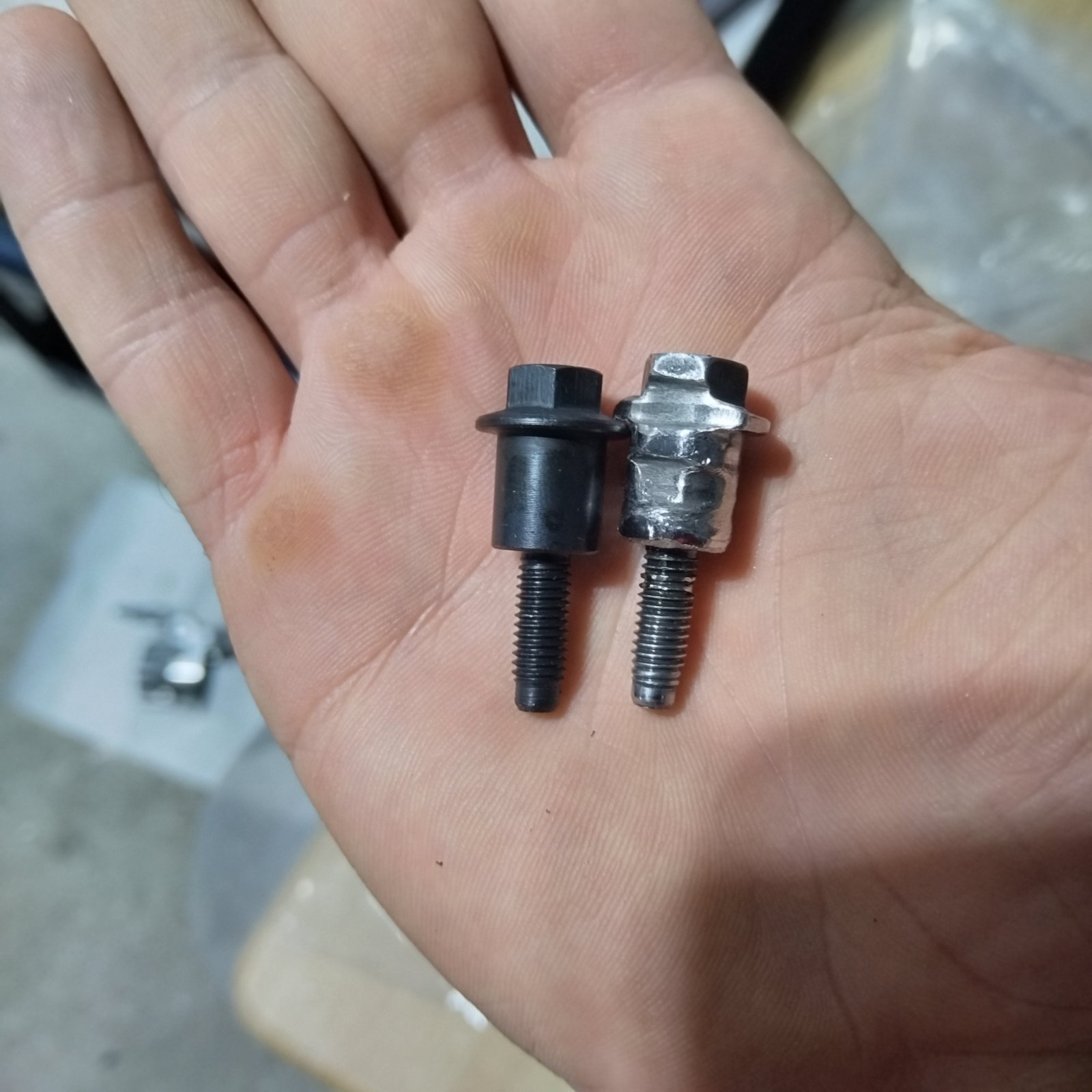

Looks like I am taking the oil pan off to go fishing for the remains of 1/2 of an M6 bolt and a few plastic bits of a chain guide.
:mad:

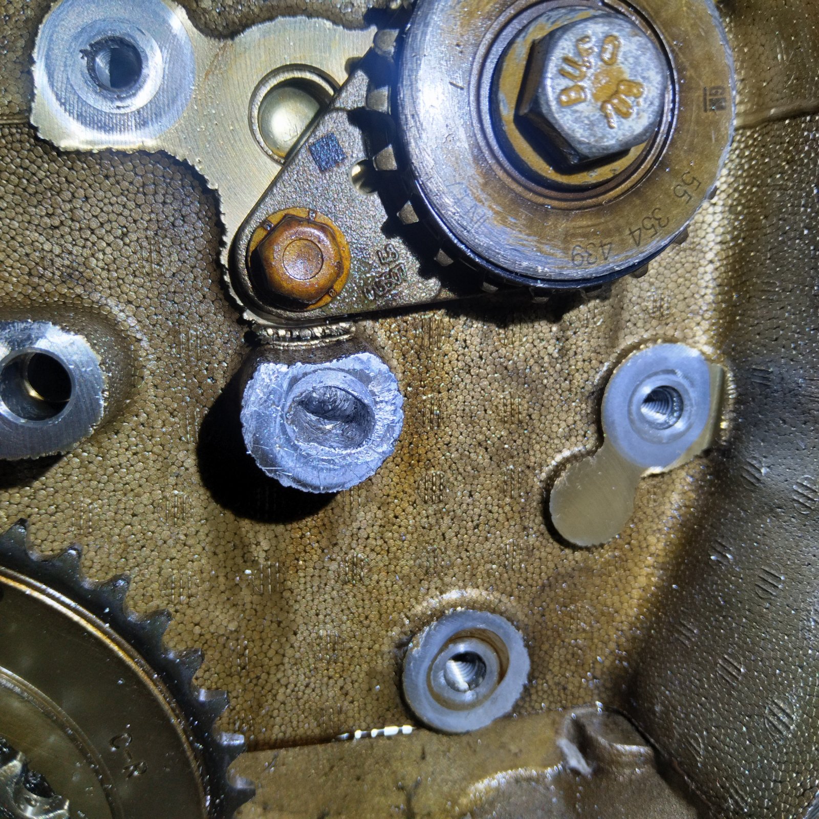

going to try to enlarge the threaded hole from M6 to M8 and add a helicoil and make a custom bolt with spacer for the chain guide. I drilled the broken M6 bolt out but the hole is all messed up from the failure :-(

Perhaps helicoil or threaded insert of some type? Would save you from making a custom bolt that may (or may not) create other issues.
Goblinfanclub1234
The hole is too big for a 6mm helicoil now I think I have to go up a size to 8mm.
I am also searching to see if there are any M6 inserts out there can I could JB Marine Weld in after oversizing the hole and mounting up the guide while the epoxy hardens.

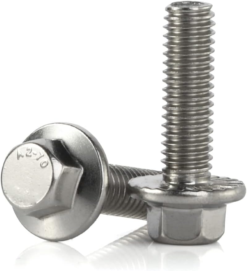

this isn't the upper bolt, it is the lower bolt in the same guide.
I too was thinking it's a different bolt. I'm not aware of any kind of "upgrade" bolt for this one...

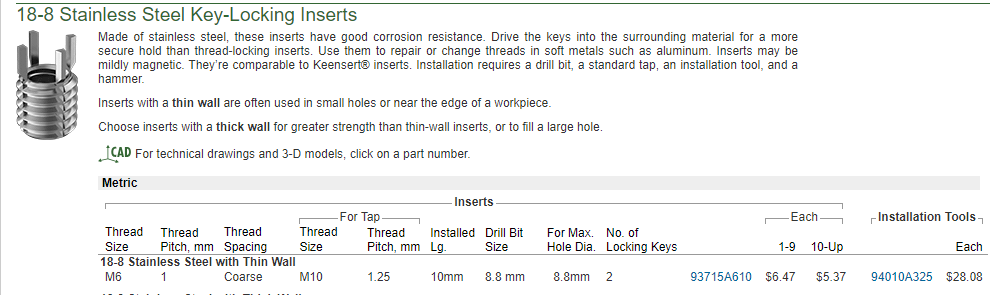

Mahkoi
Something like this may be an option? It's an m6 thread repair but the insert is an m10. Ive used these in the past with success on other things I stripped
*not sure if the one I linked is the correct pitch for your m6 so double check*
E-Z LOK EZ-450-6 Threaded Inserts for Metal, M6-1.0 Installation Kit, Steel, Black Oxide https://a.co/d/49O0TtY

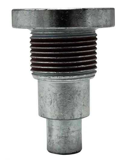

Can the LNF use the Dorman bolt to fix this, like I did on my LSJ?
I am using this for the top bolt.
42887

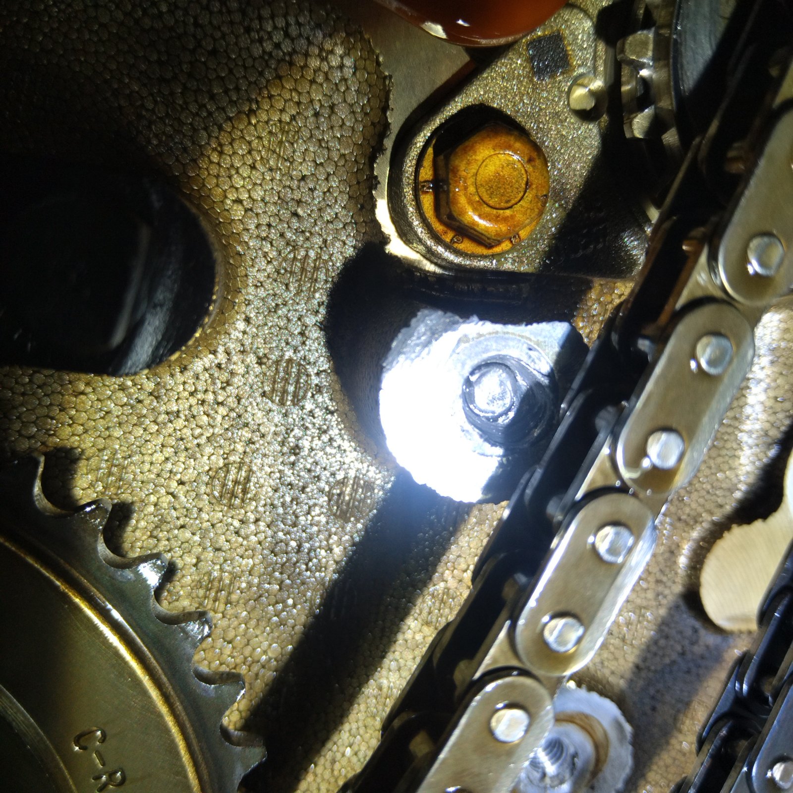

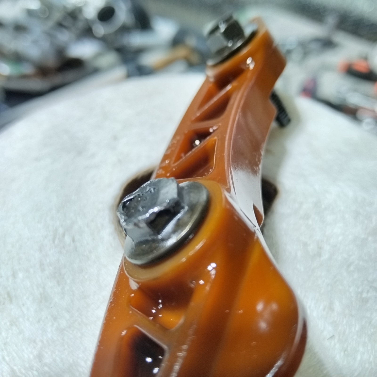

but the bottom bolt snapped right off and I had to drill it out. I am going to use an 8mm helicoil that takes an 8.3 mm drill bit. I will swap the bolt that holds the guide to an M8x25mm flange head bolt with a high temp bronze bushing (8mm ID, 12mm OD, 12mm length) as well to hold the guide.

wish me luck I will post updates later.
If I have to I will epoxy a threaded stud into that hole and add a thread locked nut to install the guide.
Goblinfanclub1234
this might work!
I ordered a couple different options and I will look at everything and decide how to do it. keeping the 6mm bolt would be ideal for sure. I got upgraded 6mm guide bolts from ZZP that wont break off like the OEM crap did.
