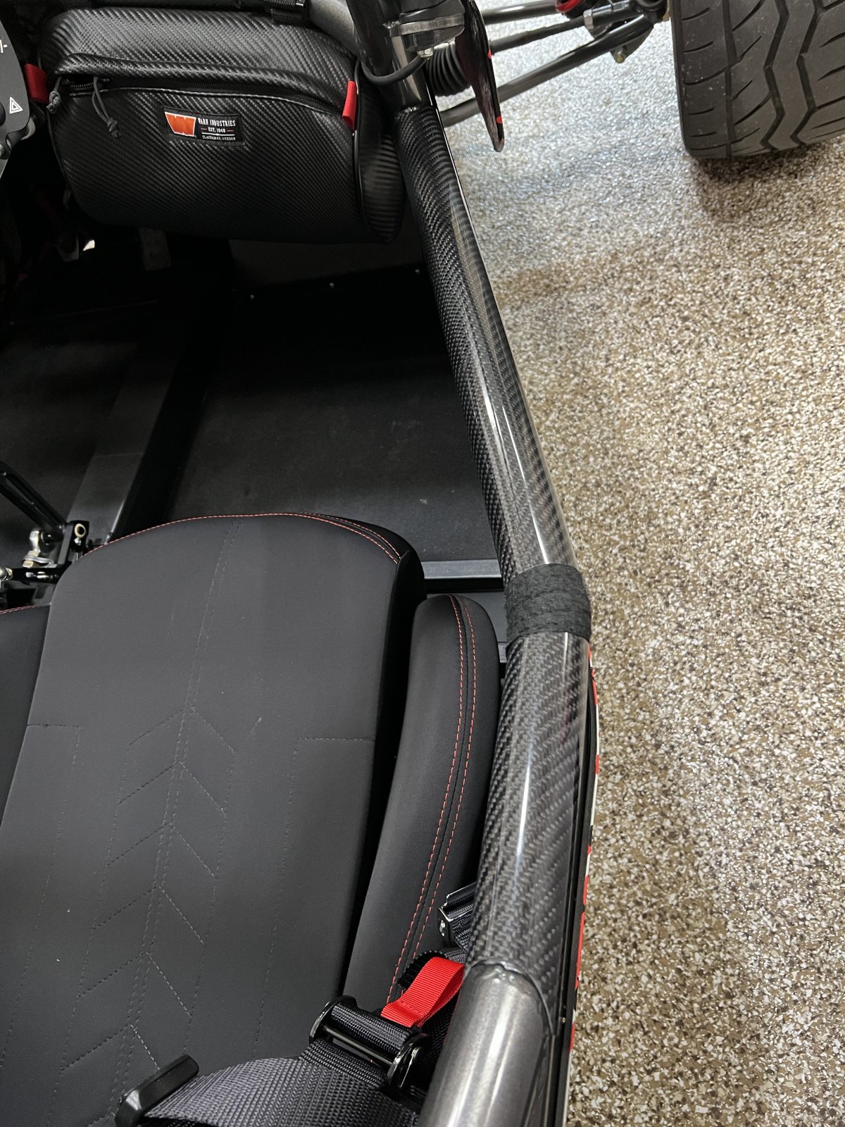

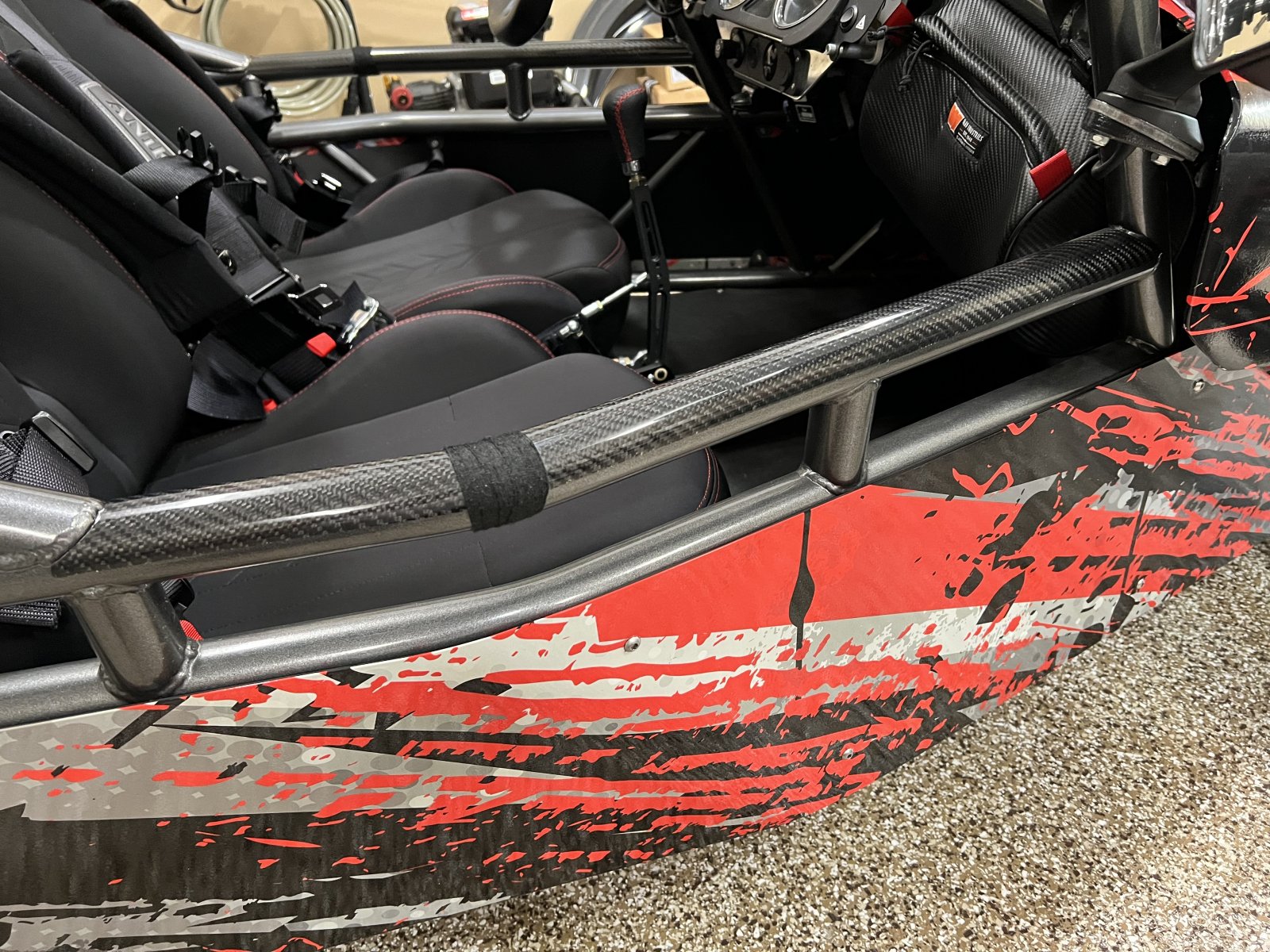

I did carbon 1/2 tubes. Started with the black foam bar wrap (noodles) but they started to crush and tear from entry/exit.
These have been holding up really well so far. Used 3M tape to attach them, and Tesa tape to cover the seam between the 2 pieces to keep them from catching on pant legs. Going to try to find a cleaner looking alternative to the tape, but it has worked well so far.
