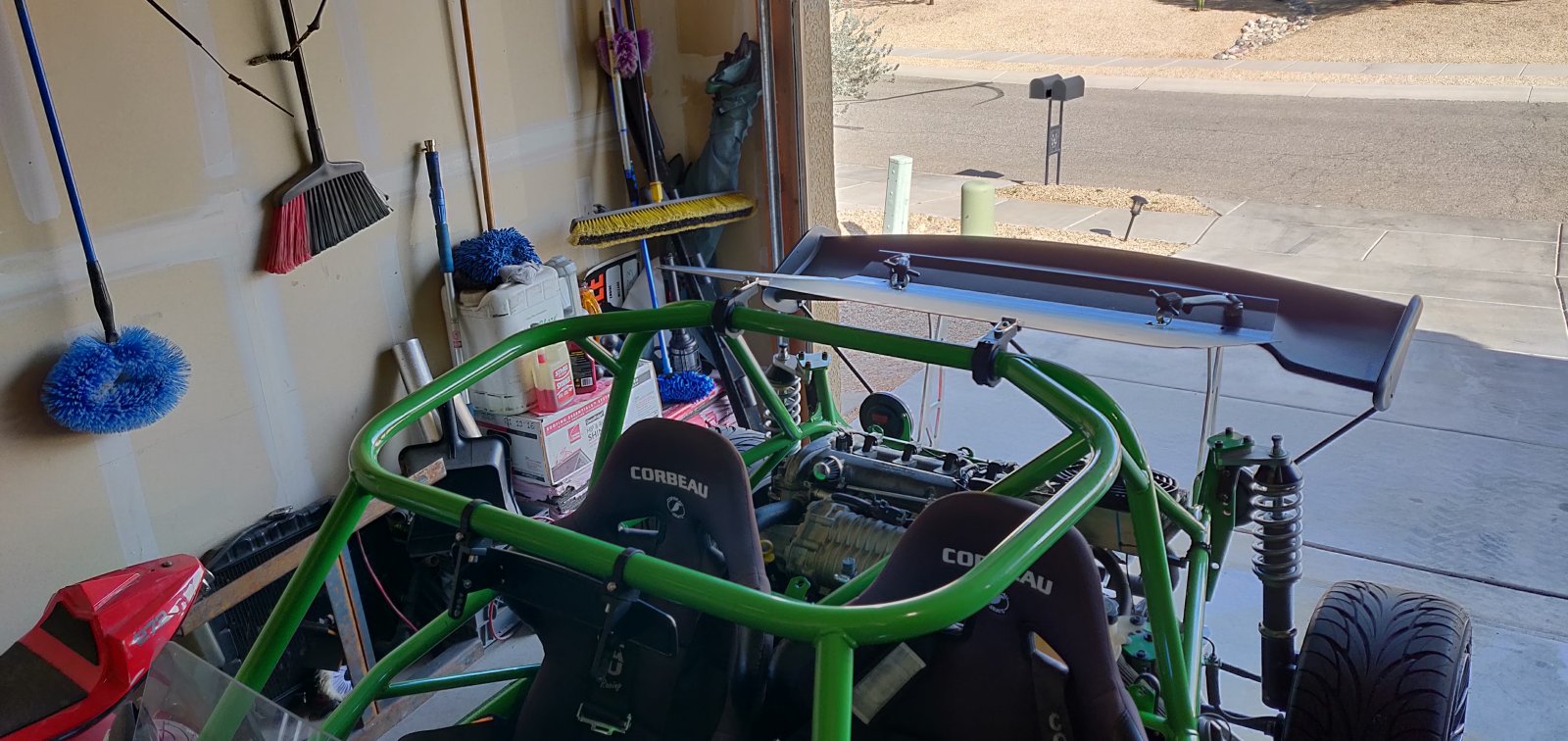

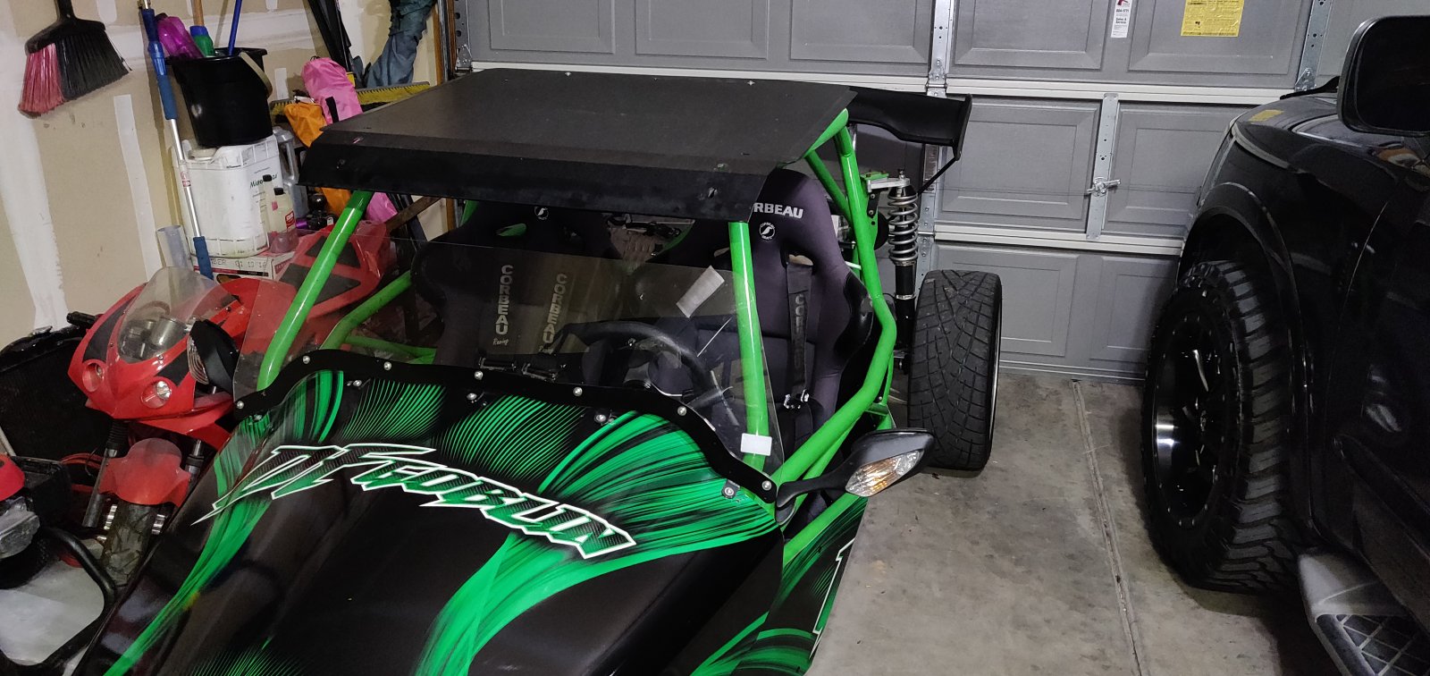

I ended up buying a used Polaris rzr cage and roof from Craigslist for $60 and figured I would see what I could do with it.

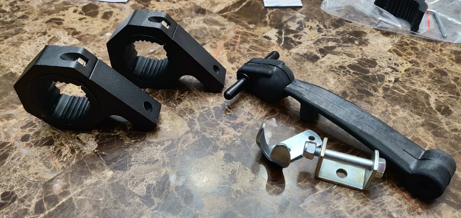

I'm not sure if this is going to work but heck I thought you guys might be interested. I have ordered some tube clamps, strap hinges, and a rubber hood latch.
Once I get those delivered, I'm going to install and try to create a system where I can hinge the front or back of the roof panel and latch it with the rubber hood latch on the end that opens. That way I can still climb in and out through the top. I hope that makes sense and I'll post pics this weekend once the parts come in. Hopefully it won't be a disaster!

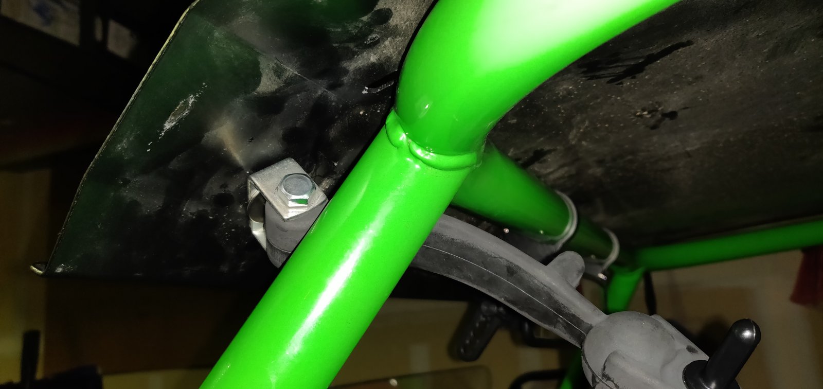

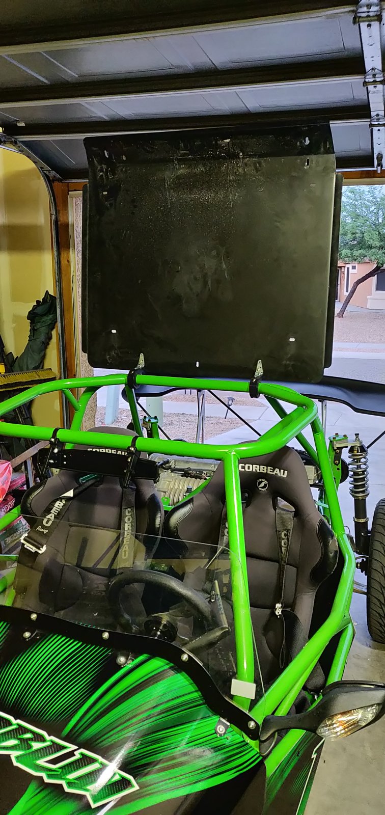

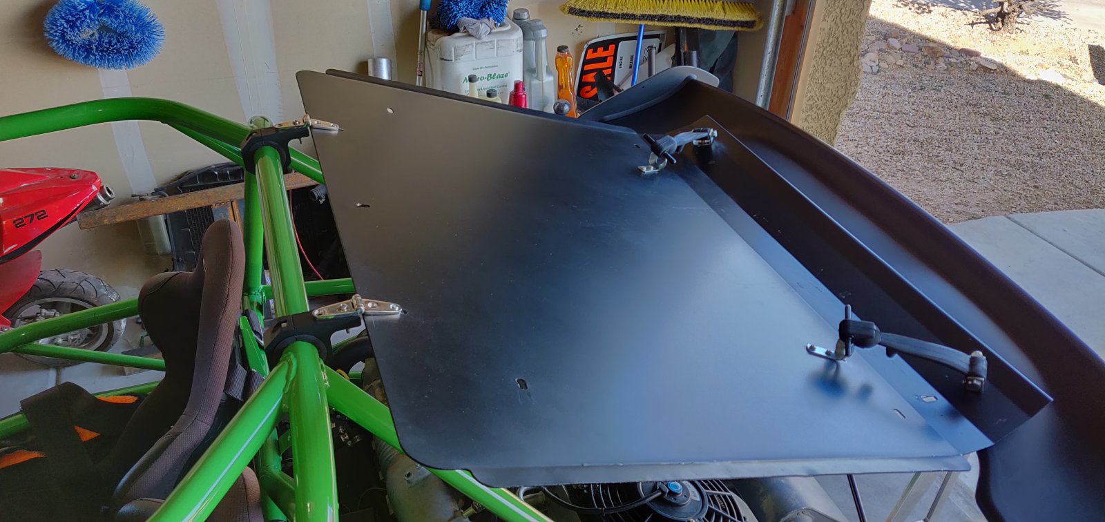

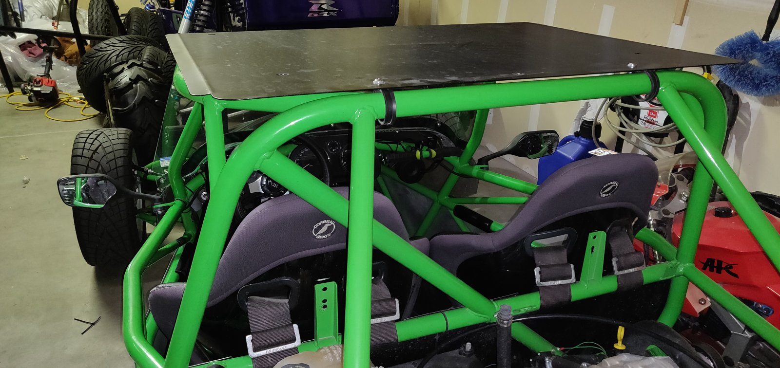

Here are some update pics. The strap hinge holes are offset, which is annoying, and made the roof an 1/2 inch off from being center. I will need to special order the correct hinge or try to file out the hole in it to give me some adjustment. It will work for now.
I was going to use just one peterbilt hood strap on the center of the roof in front, but seeing how it would interfer with the mirror, I decided to put one on each side. Will need to order another one of those as well. So far, I think this is going to work out.

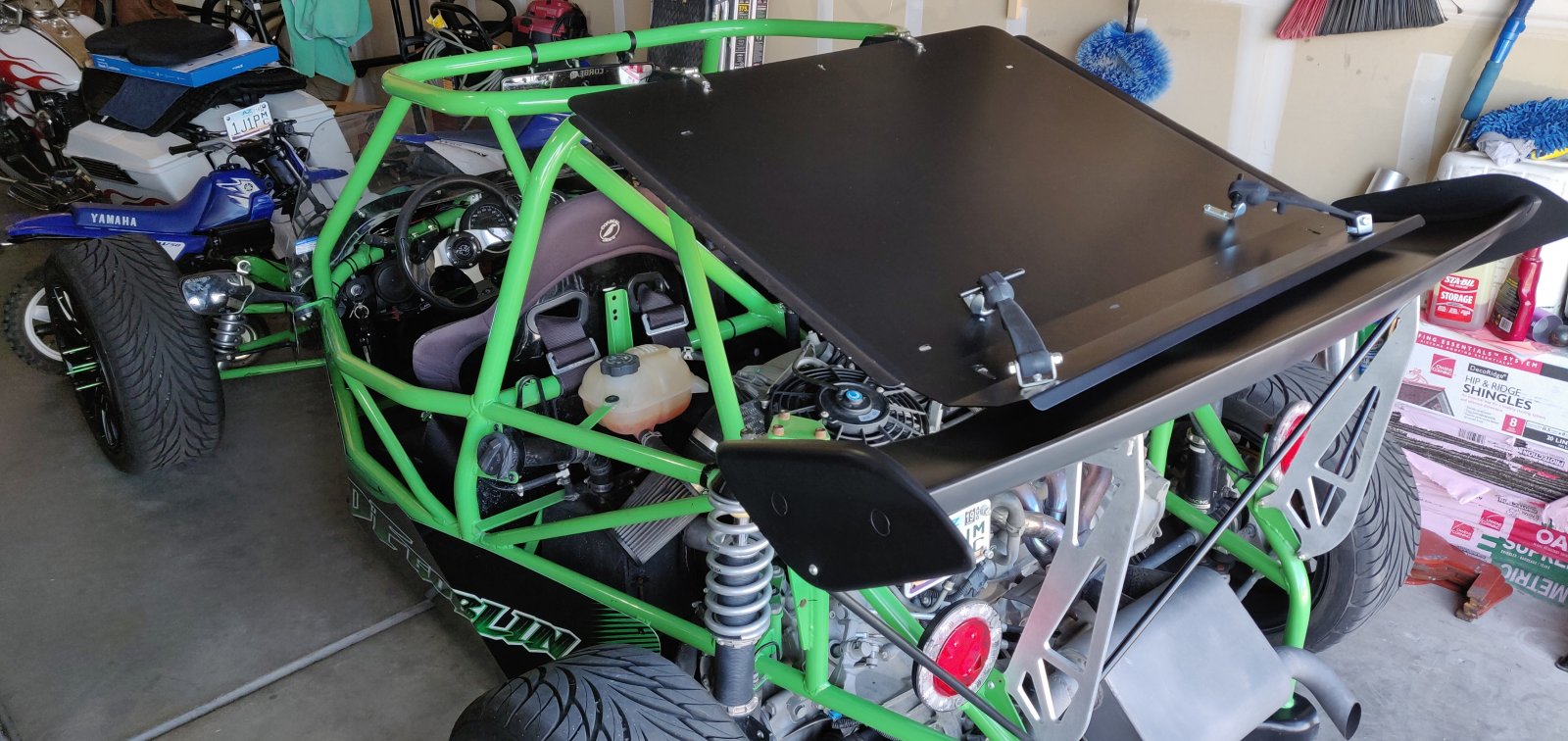

Just an update. Well after a few small changes, I would say that the roof is a success. It holds up very well at high speeds (75mph) on the freeway and blocks out most of the sun.

Turned out great! I think you did the right thing by putting two straps. Now you have backup protection from the wind catching it. I like the simpleness of it and it easily removable.
