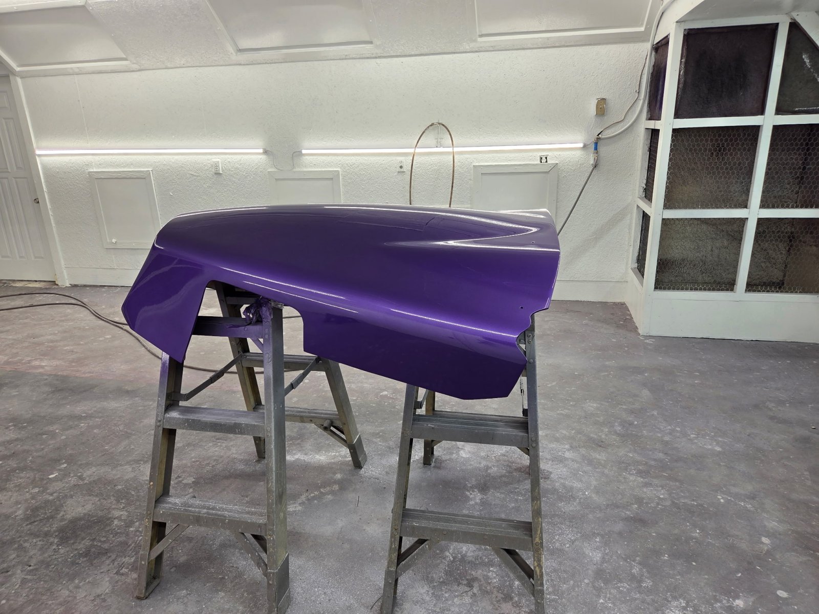

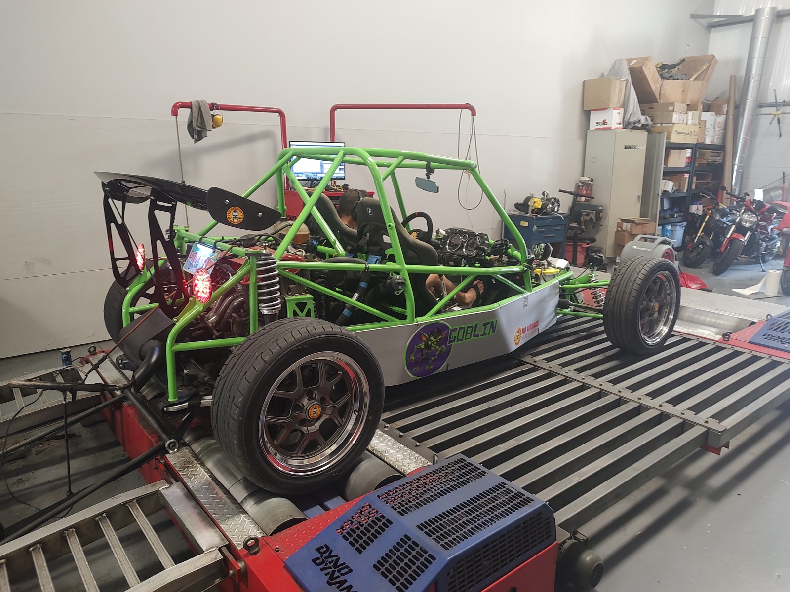

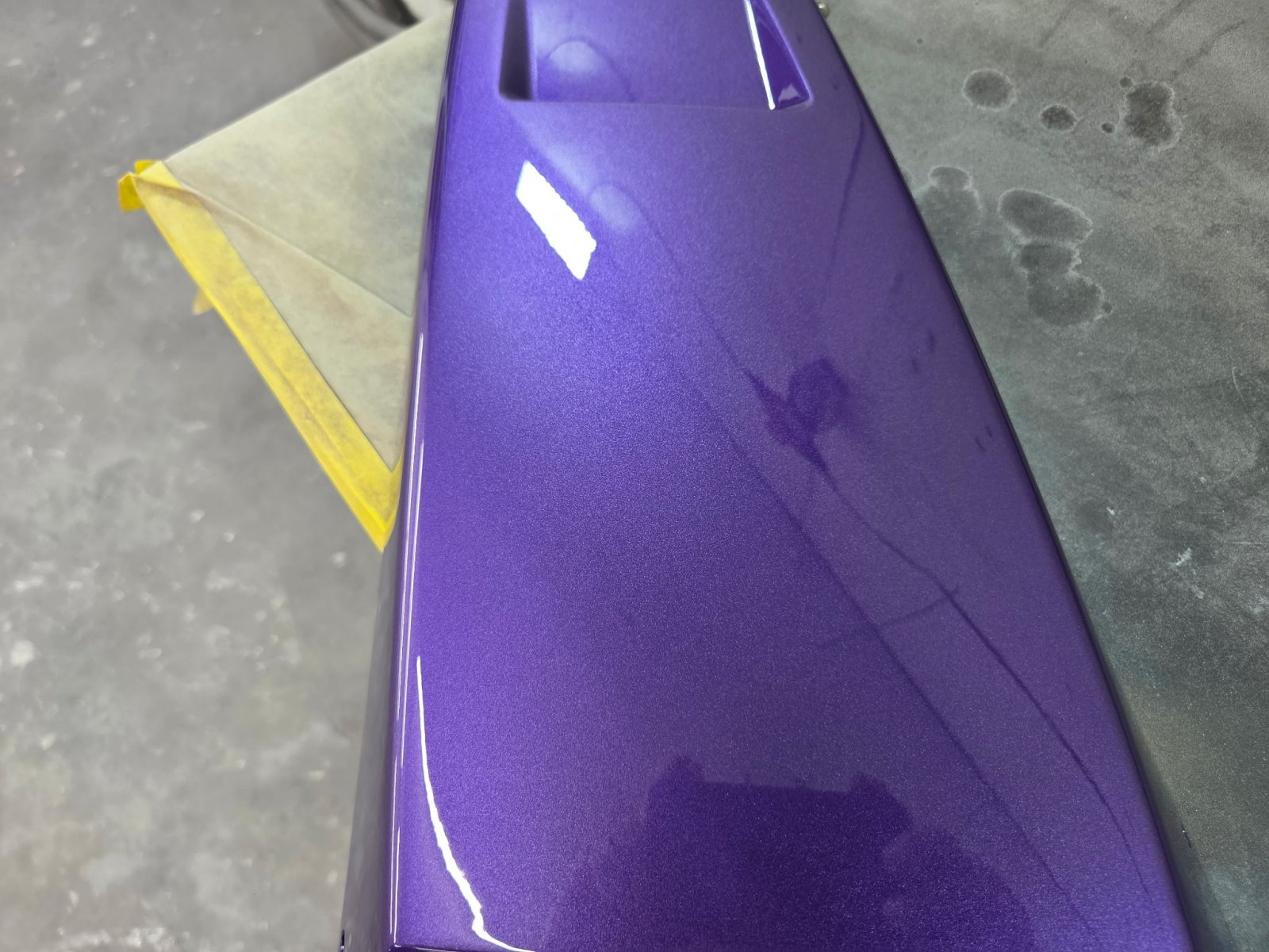

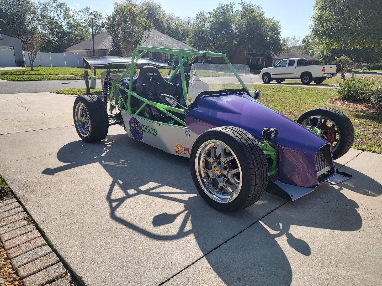

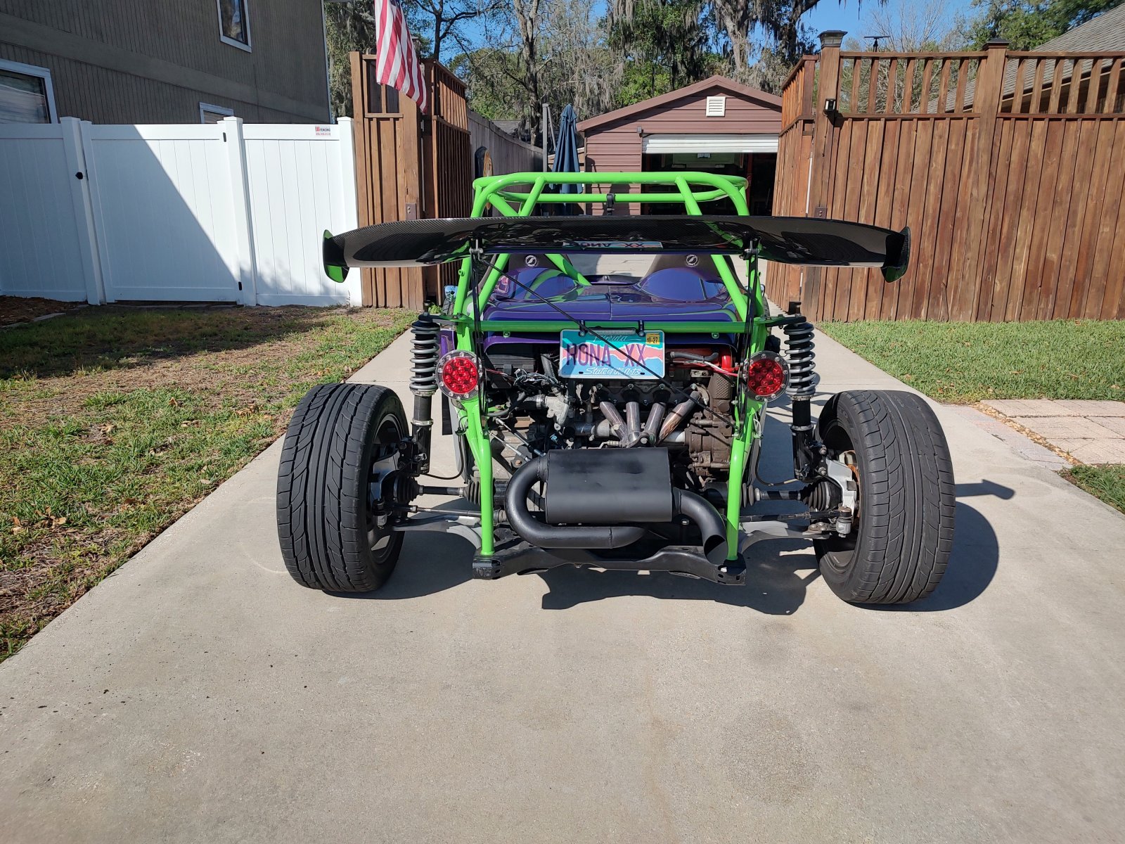

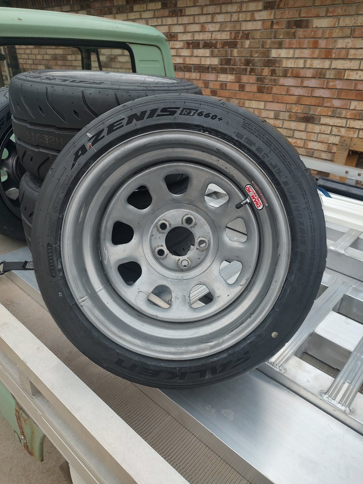

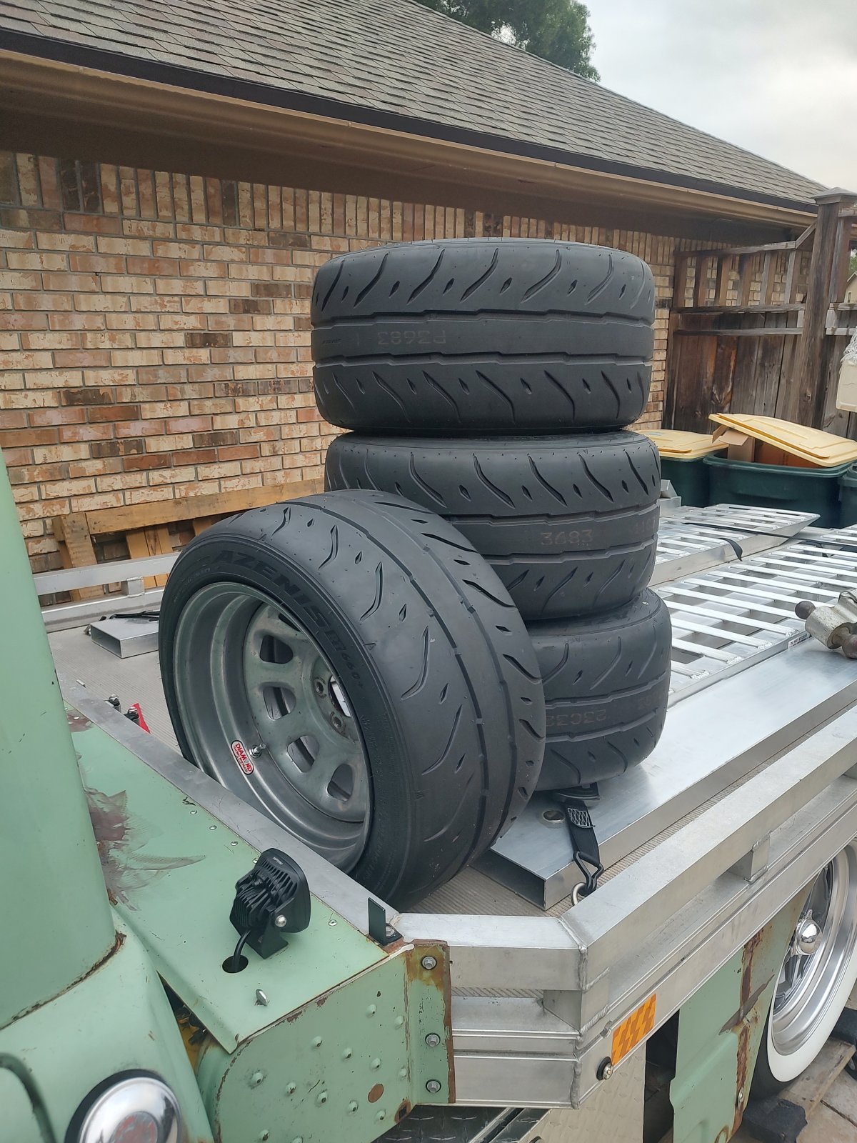

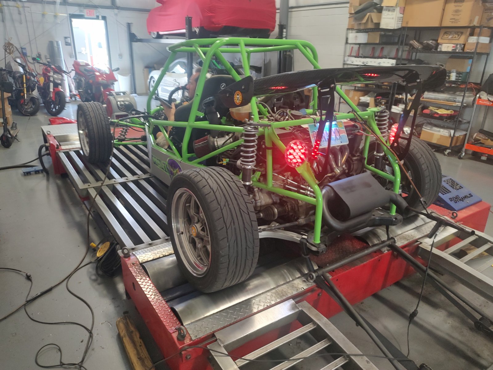

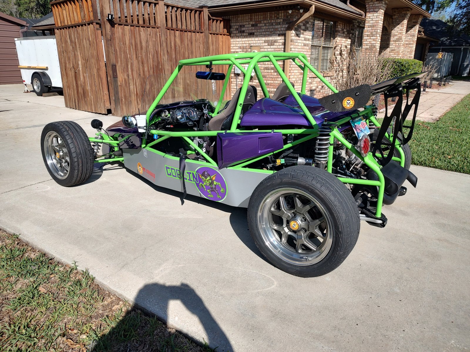

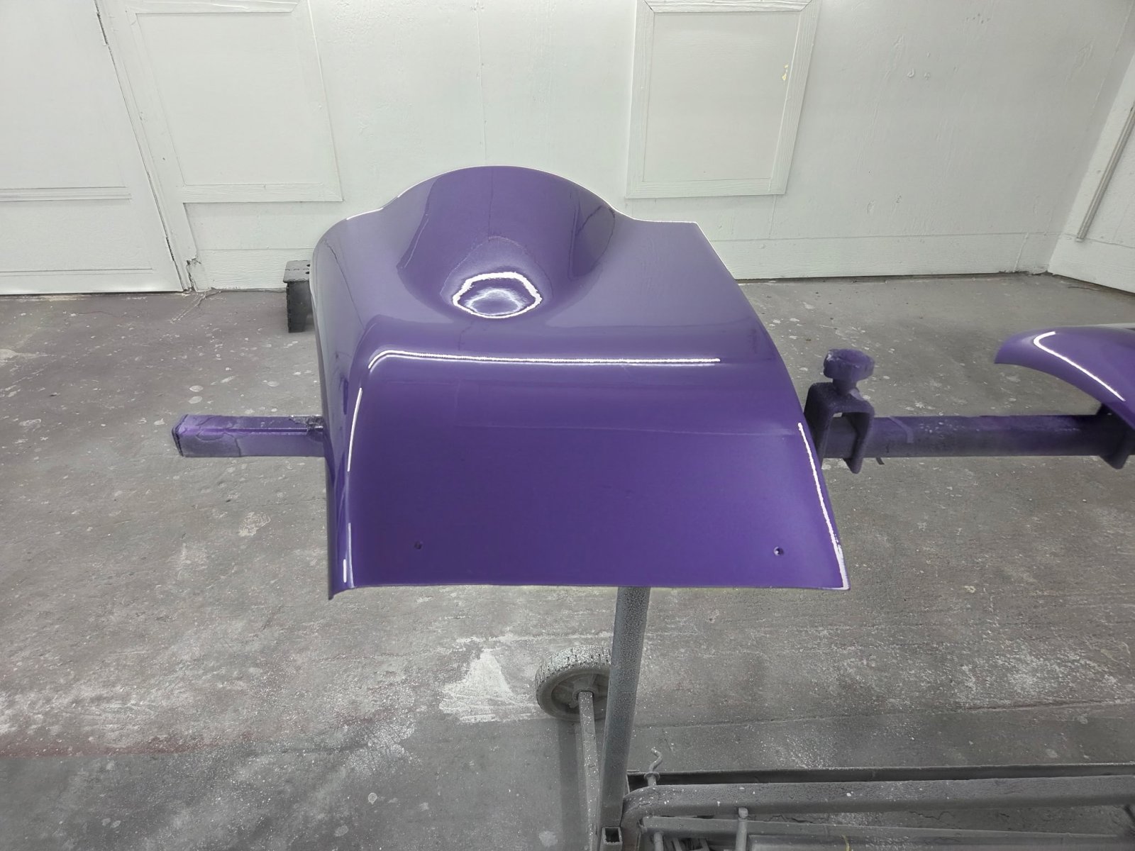

Well... Got the goblin tuned on Tuesday, all codes are gone, richened up the lower revs and got rid of the horrible over rich in the higher revs... Drives much better, out 220hp to the rear wheels, not bad for stock SC motor I thought. Also will be picking up the body panels from my painter on Thursday, got rid of the " rhino" coating and now it's Plum Crazy purple. So excited. Ordered me new track tires as well, had a set of 15"x10" race rims, so I think I'll be ready to do some testing once I figure out the brake proportional deal.
15"x19" race rims? Do you mean 15"x9" wheels? Or are these some crazy 19" wide wheels with custom tires?

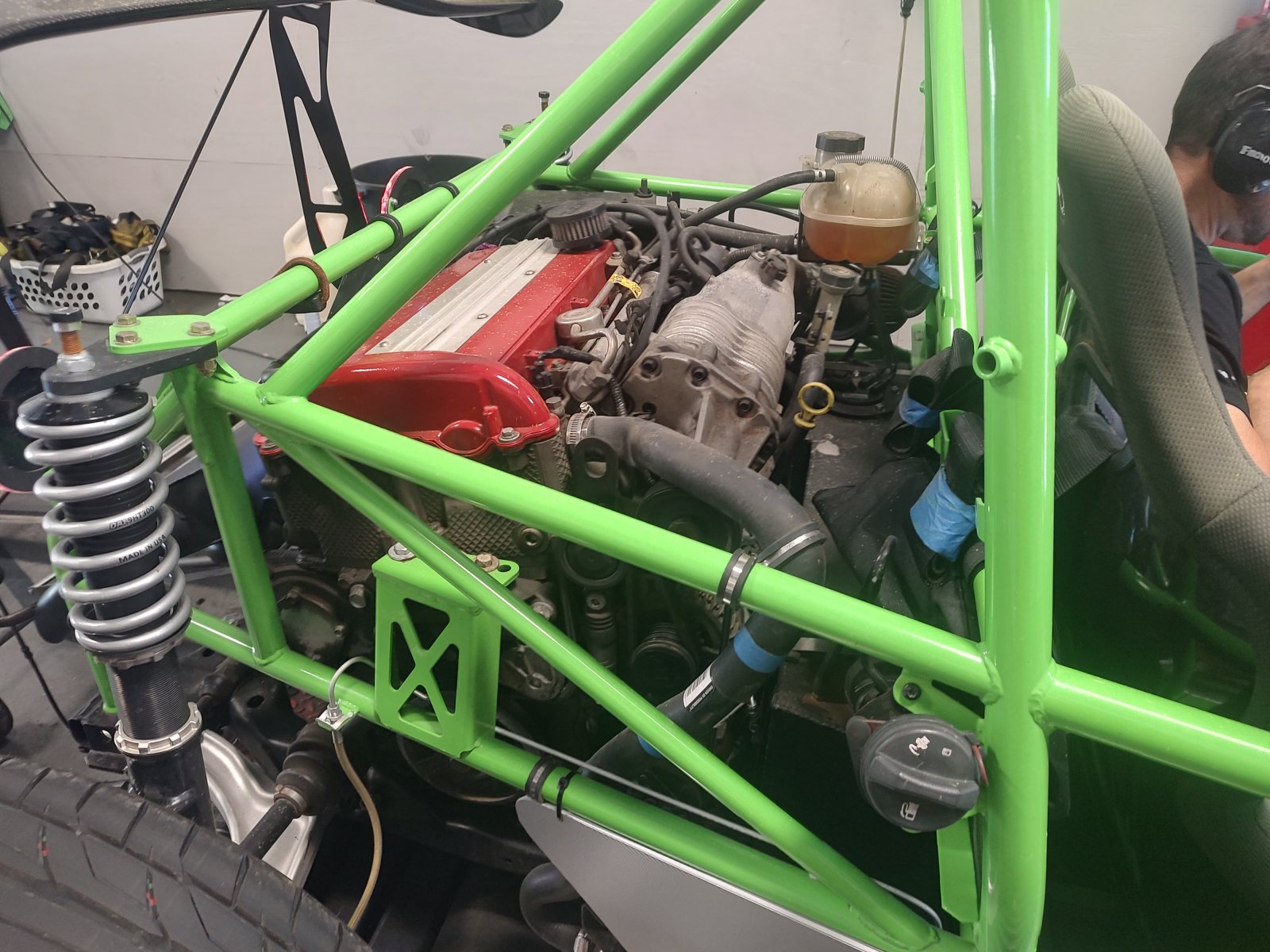

220 is healthy for a stock pulley LSJ! Do you know if you're on stock injectors too? They would be green in color. How high did they rev it?

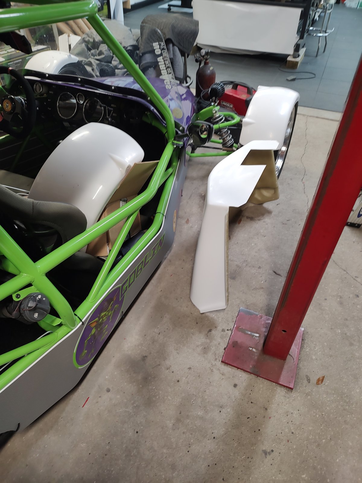

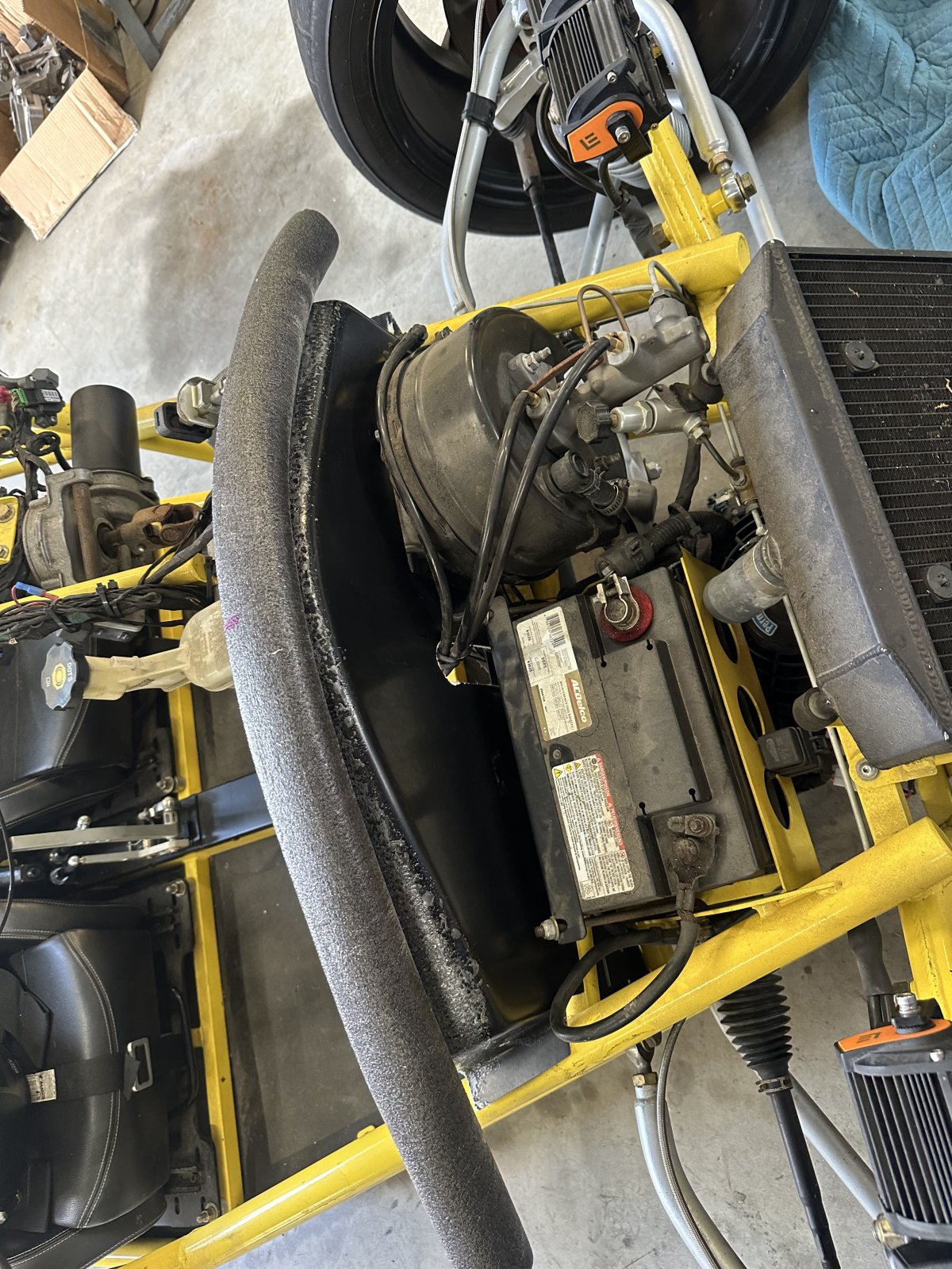

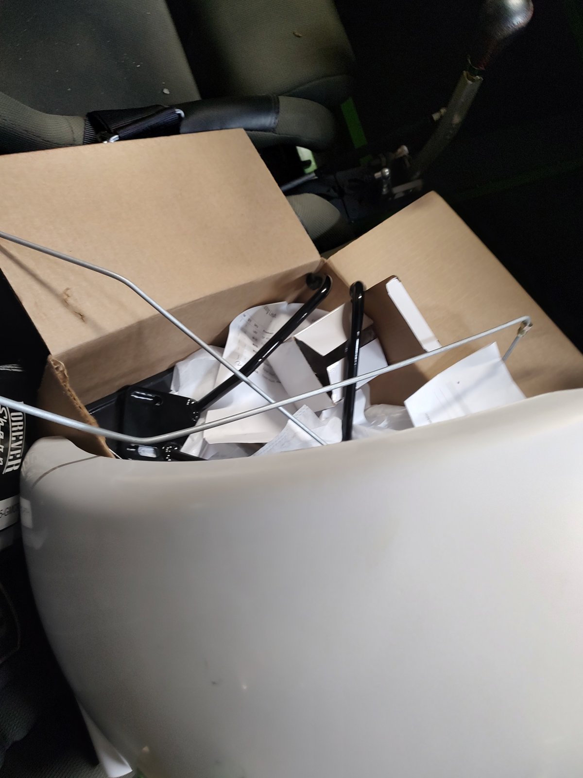

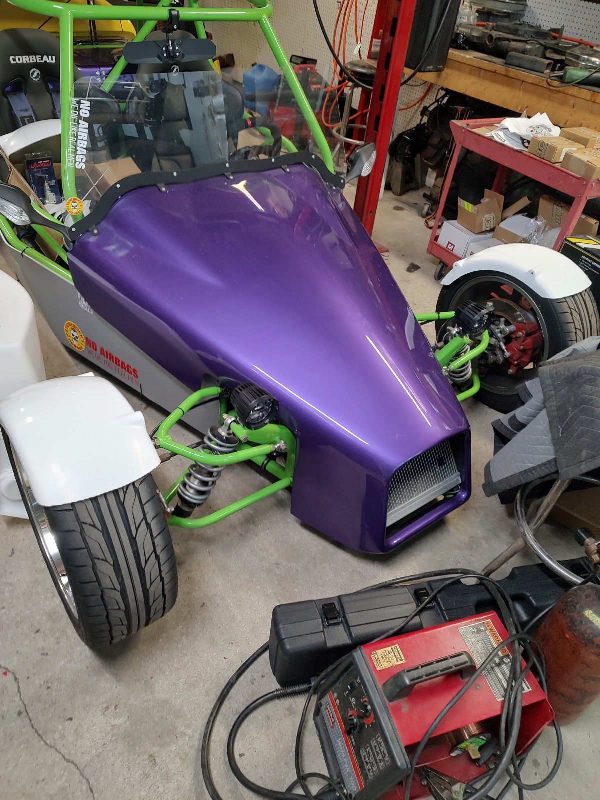

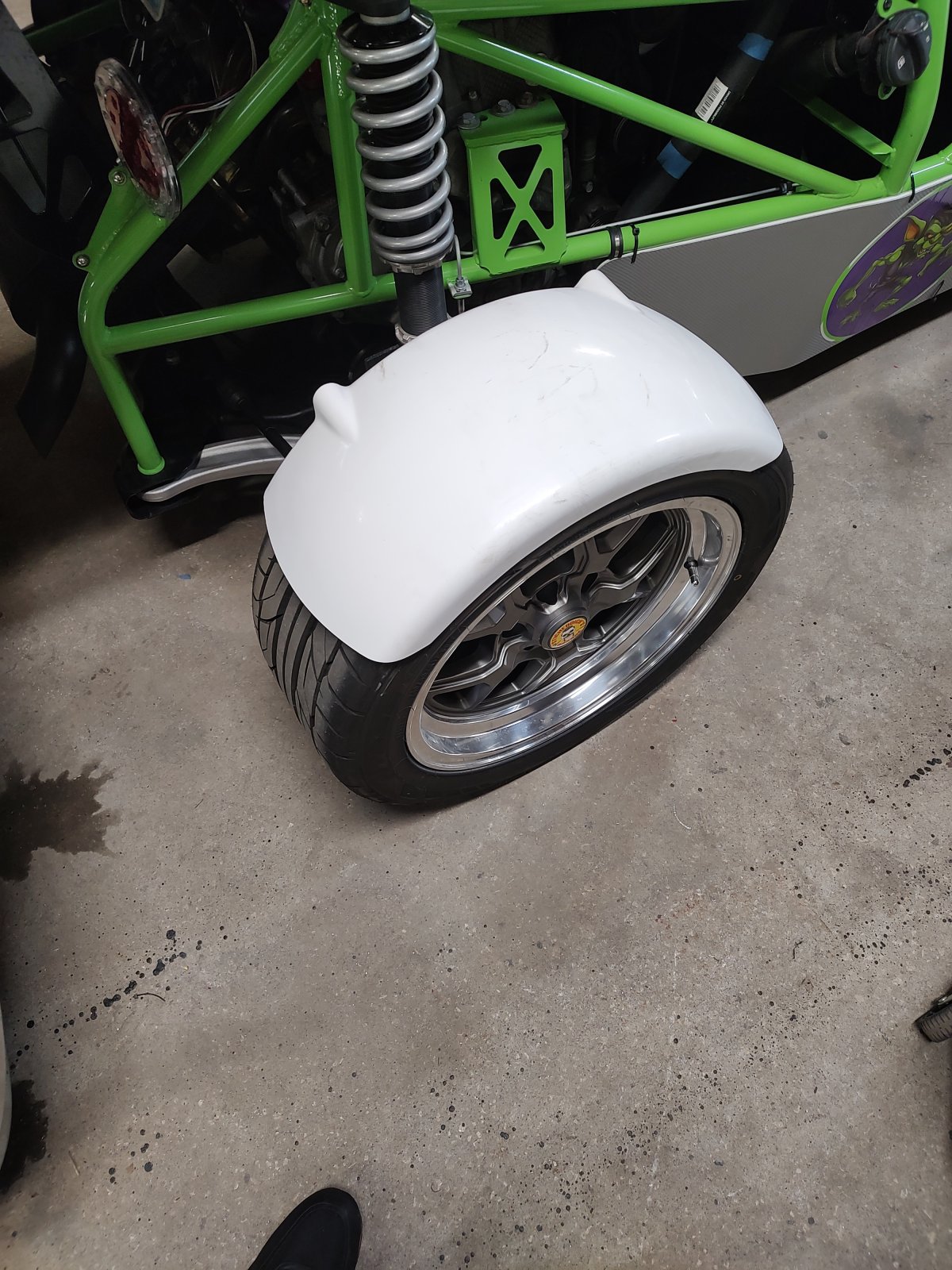

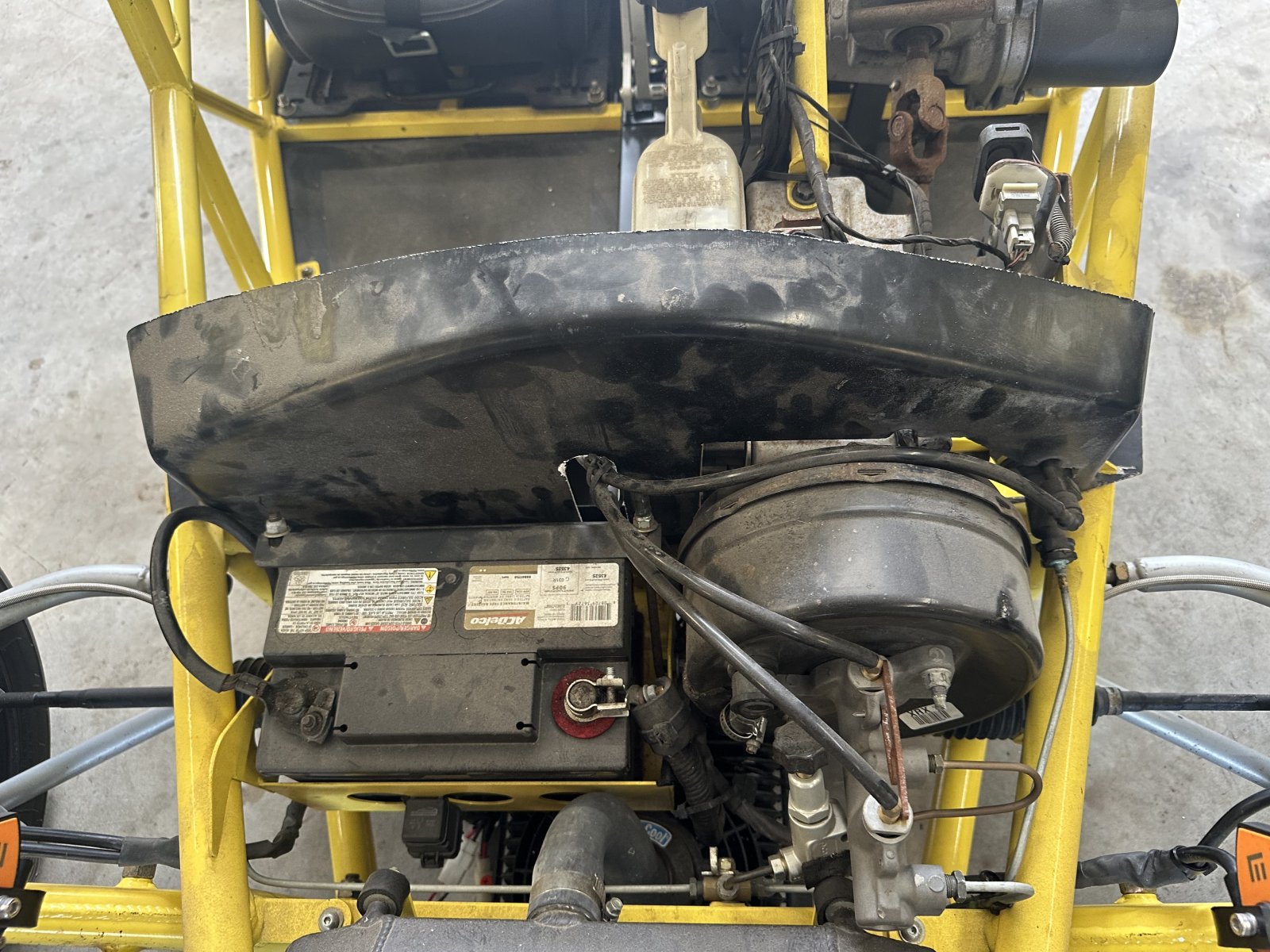

Ok .. I got my fenders and the under the hood thingies and the proportional brake controller. . Where do I find the instructions for install? HELP!
Under hood thingy will need to be cut down to work right. I cut mine way down and added pipe insulation to stop radiator heat from coming into the cab. Side note, take it off for winter driving so you have a heater.
Here for brake prop valve.
