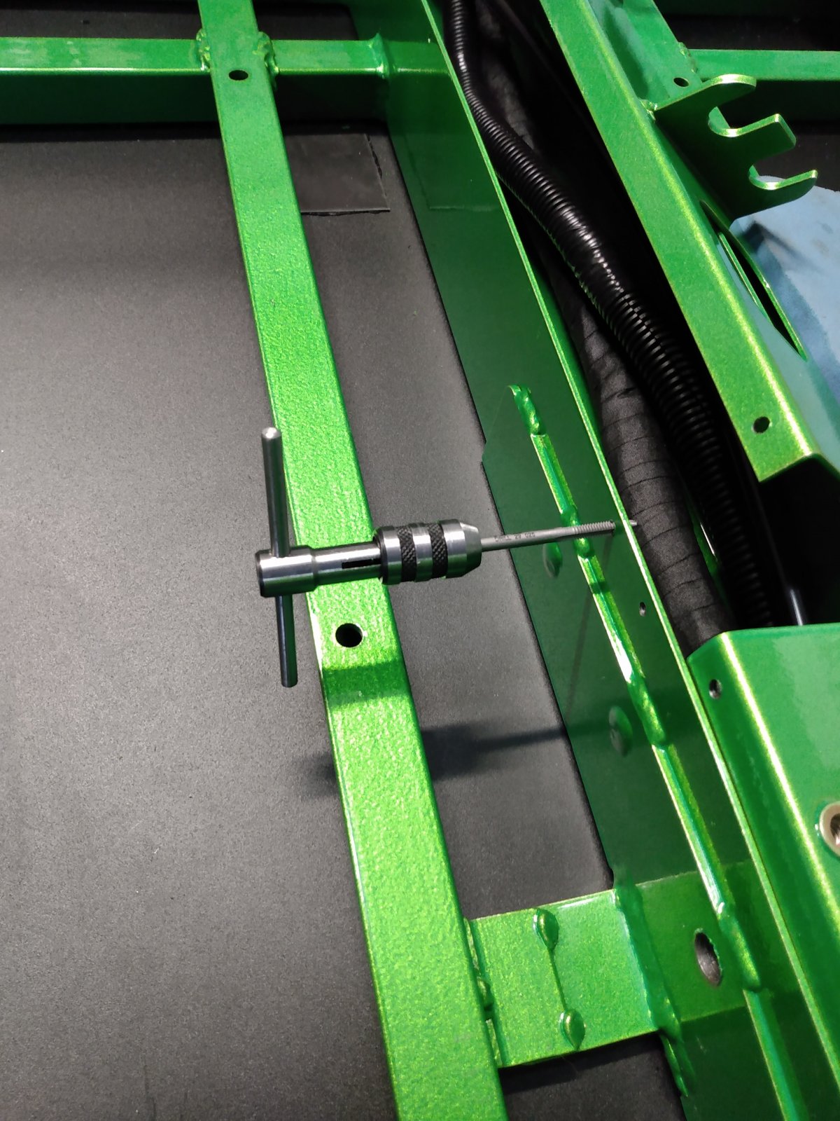

I wanted to use rivnuts in place of the rivets but the holes in the tunnel were so close to the top of the steel I was worried that by drilling to a larger size the edge would tear out. I have used M5 rivnuts for all of the floor pans and rear firewall though. Perhaps smaller rivnuts would work better to hold the tunnel pieces down.
