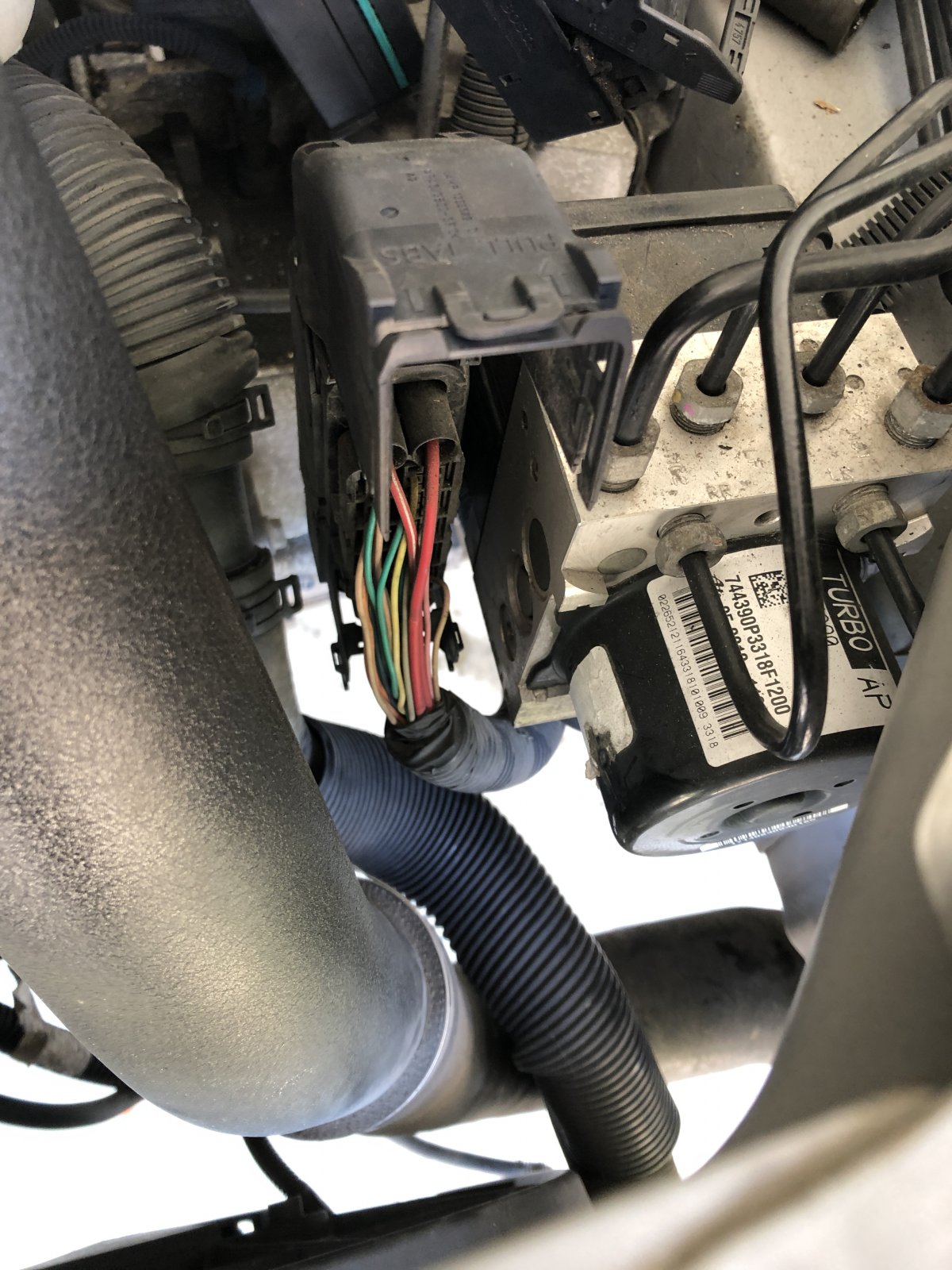

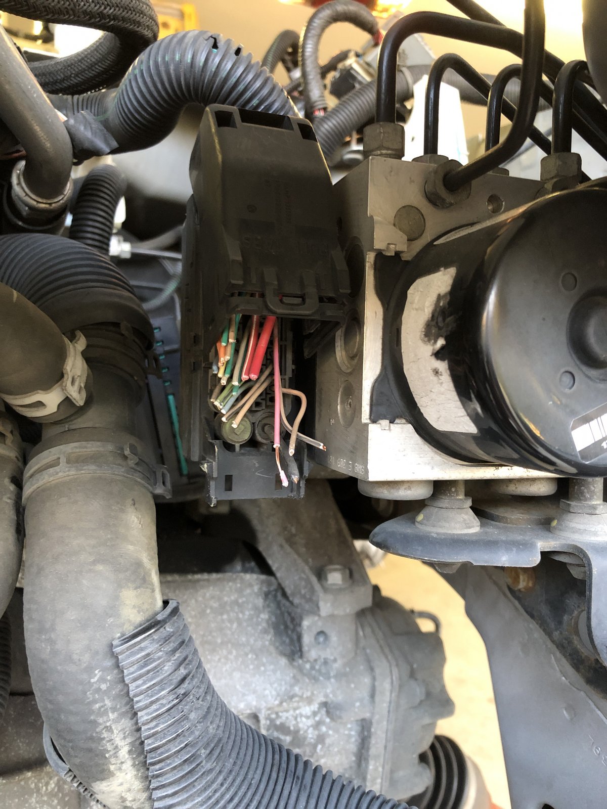

Aaron, please look at my post for the ABS Plug Wire Removal in the Electrical section. The plug has a couple sliding tabs that retain it on the ABS module.
Remember to keep the tan data wires that go from that plug to the ECM. They will eventually be extended and attached to the BCM when you rework your wiring harnesses.
