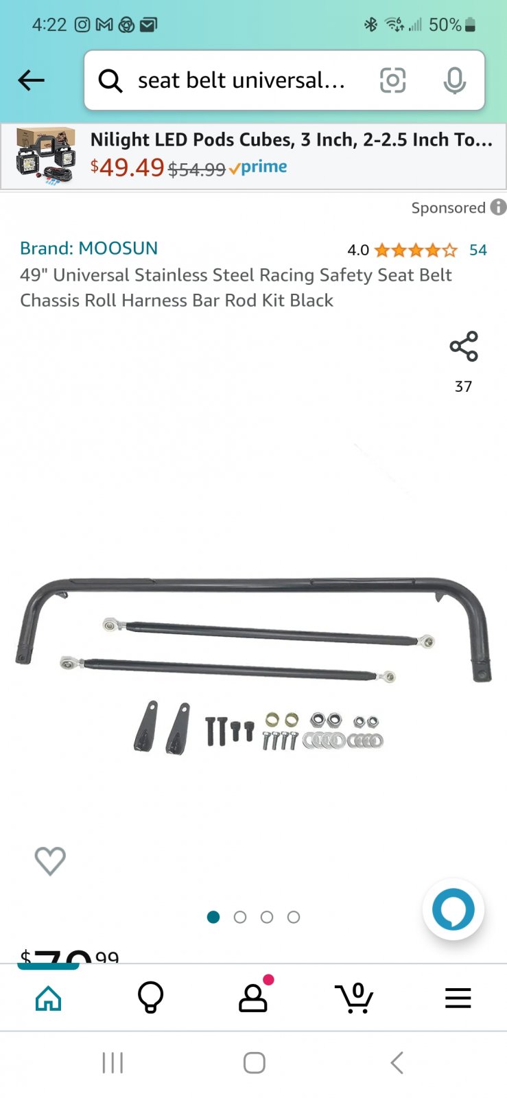

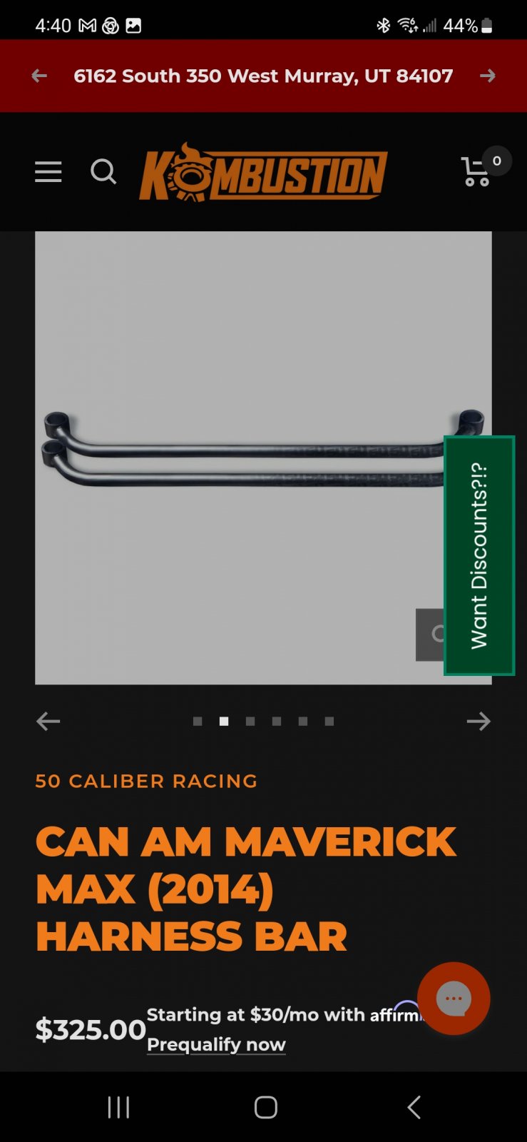

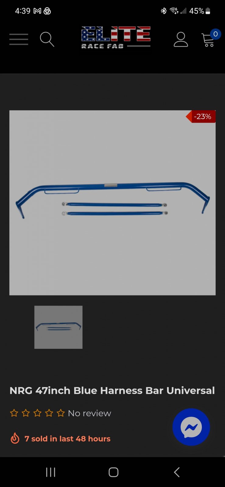

Has anyone purchased a universal bar for the 5 point seat harness? I'd like to grab one so the harness is directly in line with that. I have noticed most "universal" bars are 49" which is way too large IMO.
The measurement is 42.5" between the mounting points (I believe something around 45" would be the max).
If you are using a bar, could you let me know where you got it?

Those are not really able to be used in a Goblin. They are designed to be attached to stock seat belt shoulder mount points and then the other bars attach in rear seat belt mounts.
