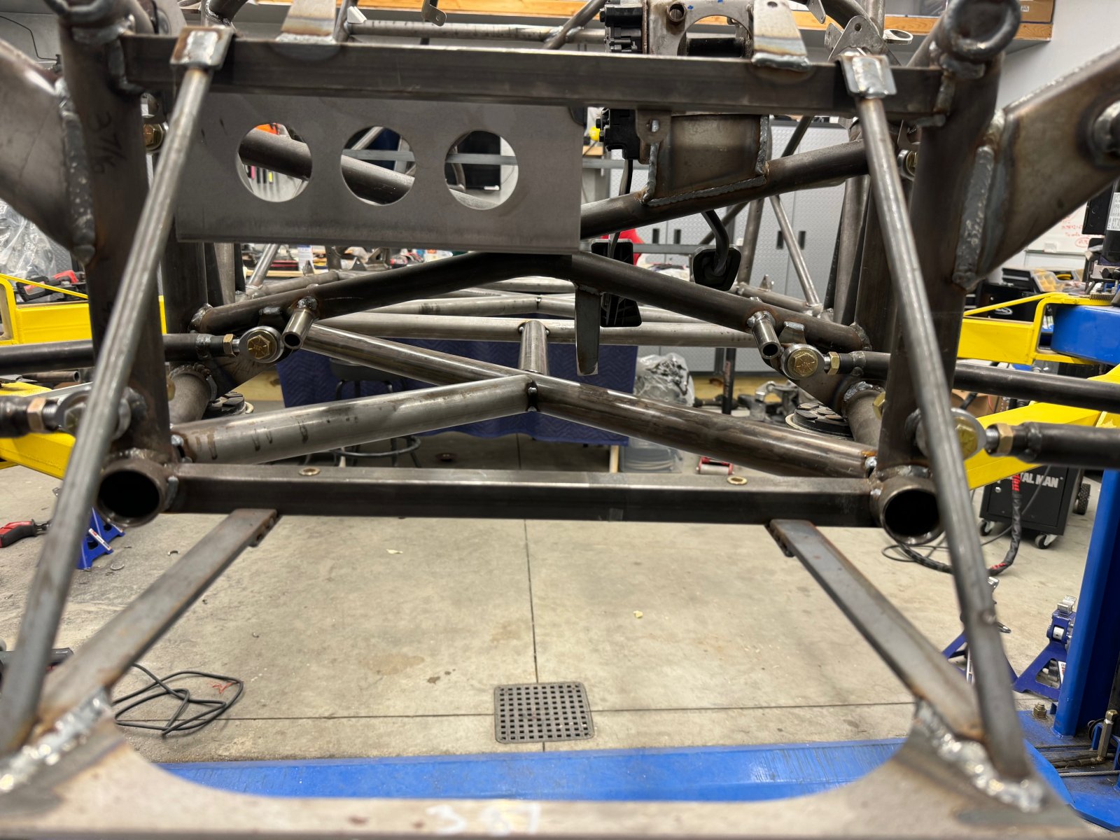

I have stiffened up floor of car all the way to nose from stock fuel tank location.

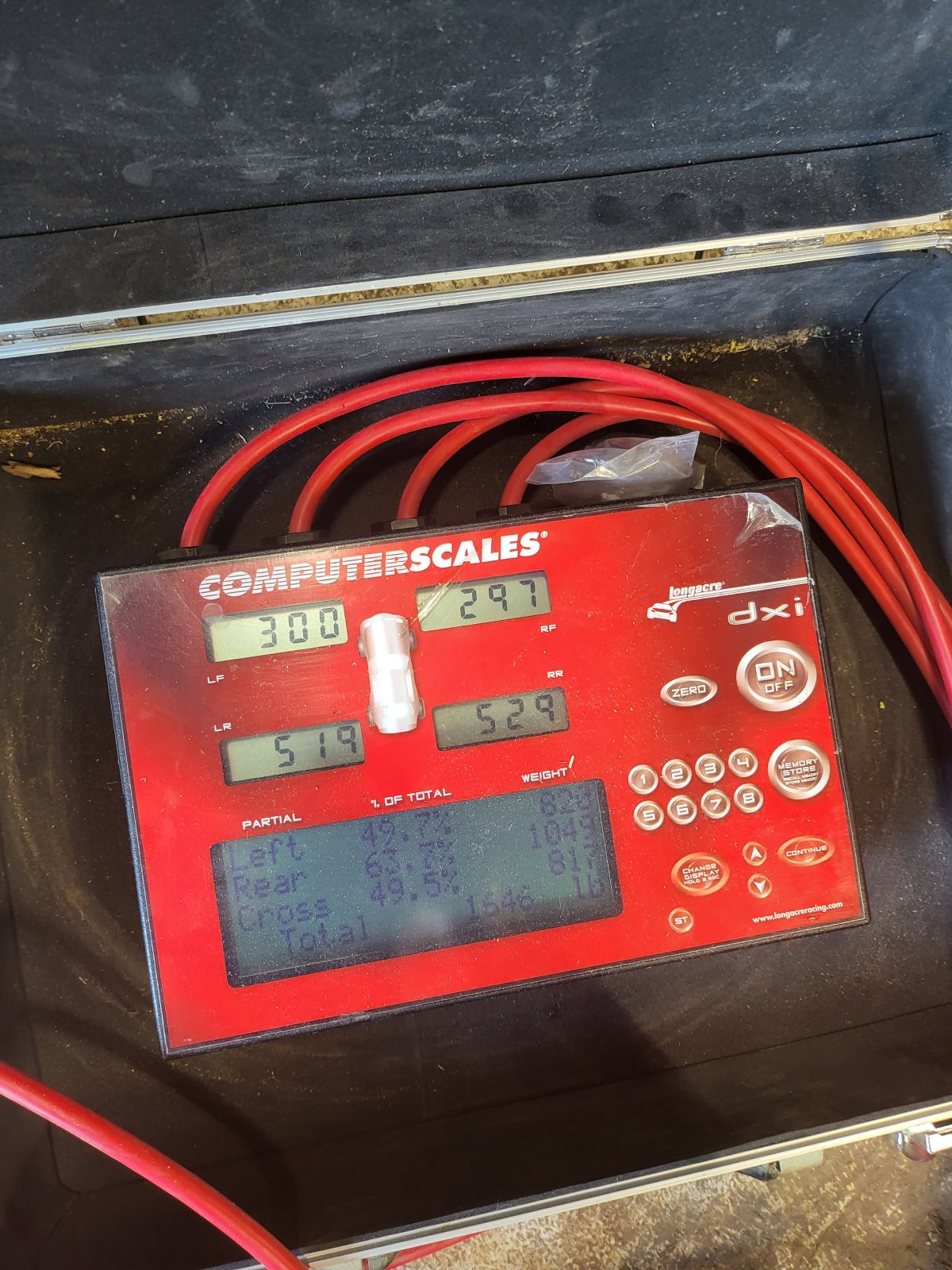

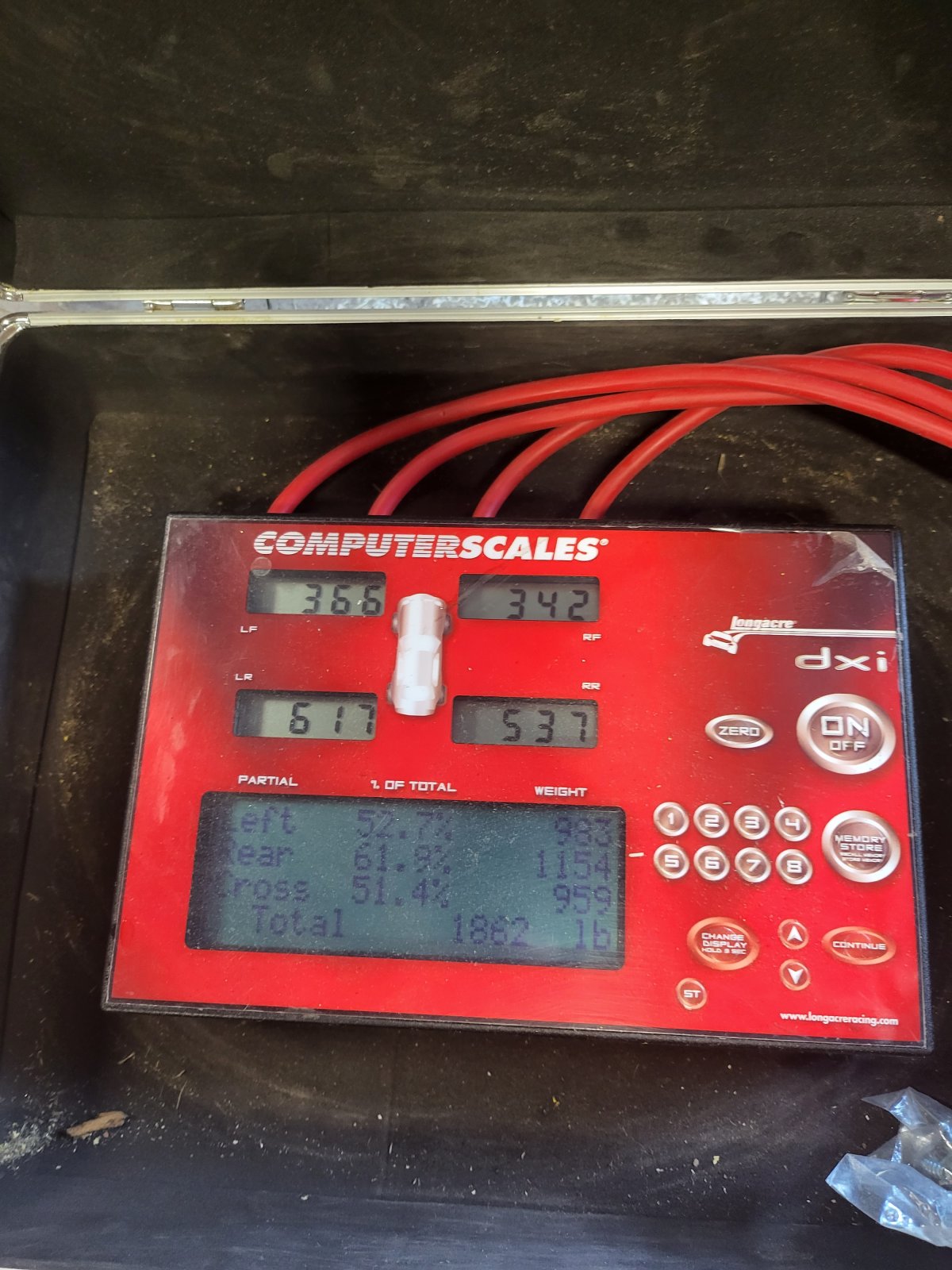

Does anyone have corner weights on a completed Goblin that they feel handles decent?
Might help me figure out a few things.
thanks
C
Heres mine with me in it, and one empty.
It handles fine, but is still a little tail happy. I'm hoping staggered tires will help.
