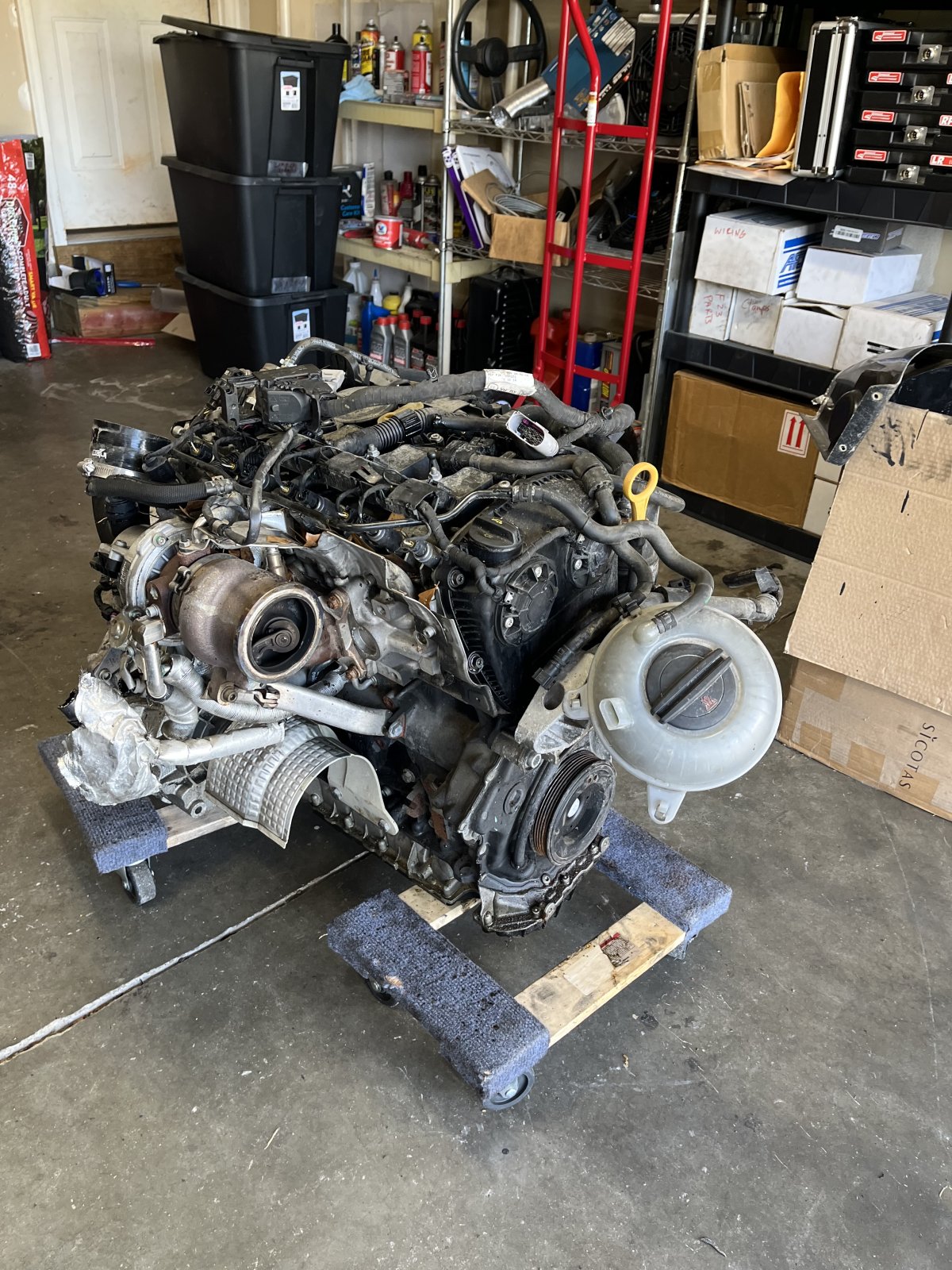

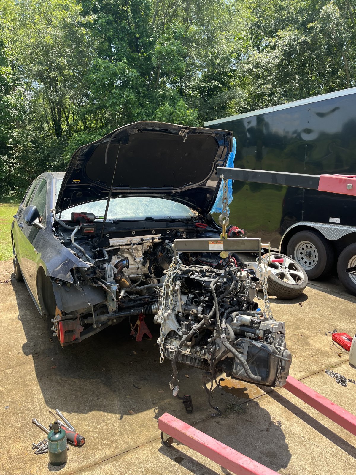

Since this is an all out race build, a built engine is a must. Started with tearing down the donor engine and sent the block and head to the machine shop.
Block and head arrived back honed and measured. He also measured crank, rod and piston tolerances for me. As well as ported the runners in the head and lapped the new valves.
