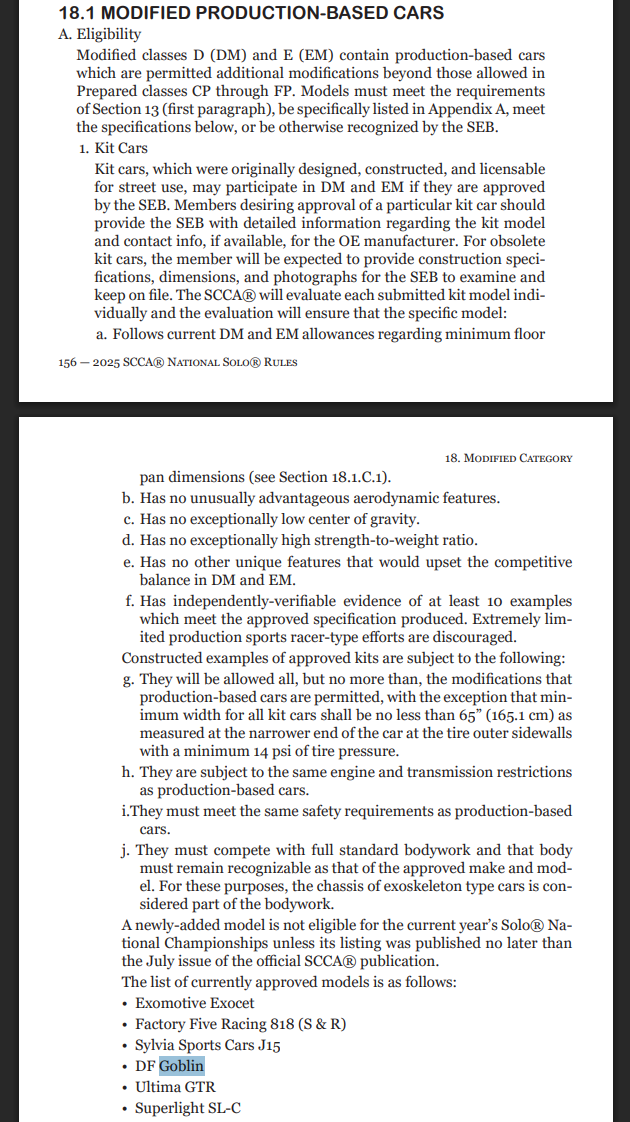

The goblin was specifically named in the SCCA Solo rule book for XU class this year so long as you have 200TW or higher tires. If you intend to run a race tire lower than 200TW you would be in EM. As for specific legality I don't really know as most local regions will mostly group you with the prepared classes. I intend to bring the goblin to nationals either this year or next depending on current finances
I couldn't find the XU mention in the rules specifically but here is a post from back in December: SCCA autocross move from EM to XU

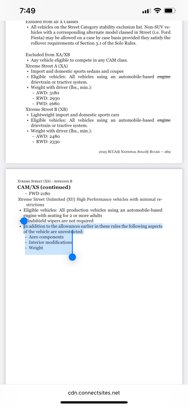

Oh man, XU is a run what you brung class on 200 TW, sounds like some F1 inspired aero to me

Unrestricted!! I can attest to how good 200tw can be, and with unrestricted aero and enough power to push through it, should be buckets of fun

Yeah the goblin should still fit into EM but it’s a loss no battle with PAX in scca. You technically cannot run a wing on the goblin in EM because it is too light. I am switching to XU this year personally to have a more level playing field
Yep. you can make them legal in EM, but it’s tricky (or take the penalty). There’s less rules on 200tw tires. On slicks, It can mostly be done, but there’s still controversy about “the engine must be sealed from the passenger compartment” And how that can be done on a goblin. PAX also kills us. Locally, it’s just us goblins and a tube chassis LS swapped Miata, so we just run EM. We are all about the same speed, so it works out. If we get on a national stage, I don’t see us really passing tech, not to mention, we will get smoked by the big boys that have been doing this a long time. :eek: Switch to XU and do whatever you want as long as you are on 200tw tires.
