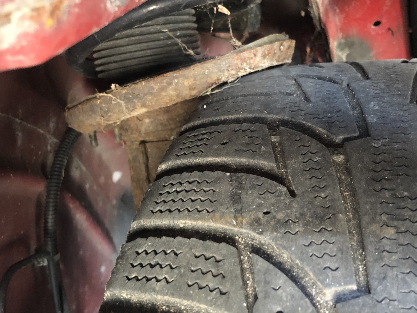

For what it's worth, I'm running a 17x9.5/+20 in the rear, with Conti ExtremeContact Sport 02 275/40 tires. I have maybe 1", at most, between the wheel and BC strut. Running 17x8/+38 in the front, with Conti 245/45 tires.

So not a lot of flex room for street driving. I might look into a 15" 0 offset for street tires. An inch or less is worrisome.
Nah, even with an inch it should be fine. However, I have cam bolts for the strut/knuckle connection, and they haven't been properly clocked yet. Further, I've not had my alignment done beyond eyeballing it, so in the end I expect to gain another little bit. Even if it does become a problem, I'll throw on some half inch spacers.
Ya when you are all said and done might give you a little extra, that would be legit. Hope it all pans out.
No rubbing with 1 1/4” clearance at autocross and track. I could run a camera to see how close they get, but it’s probably plenty fine.
