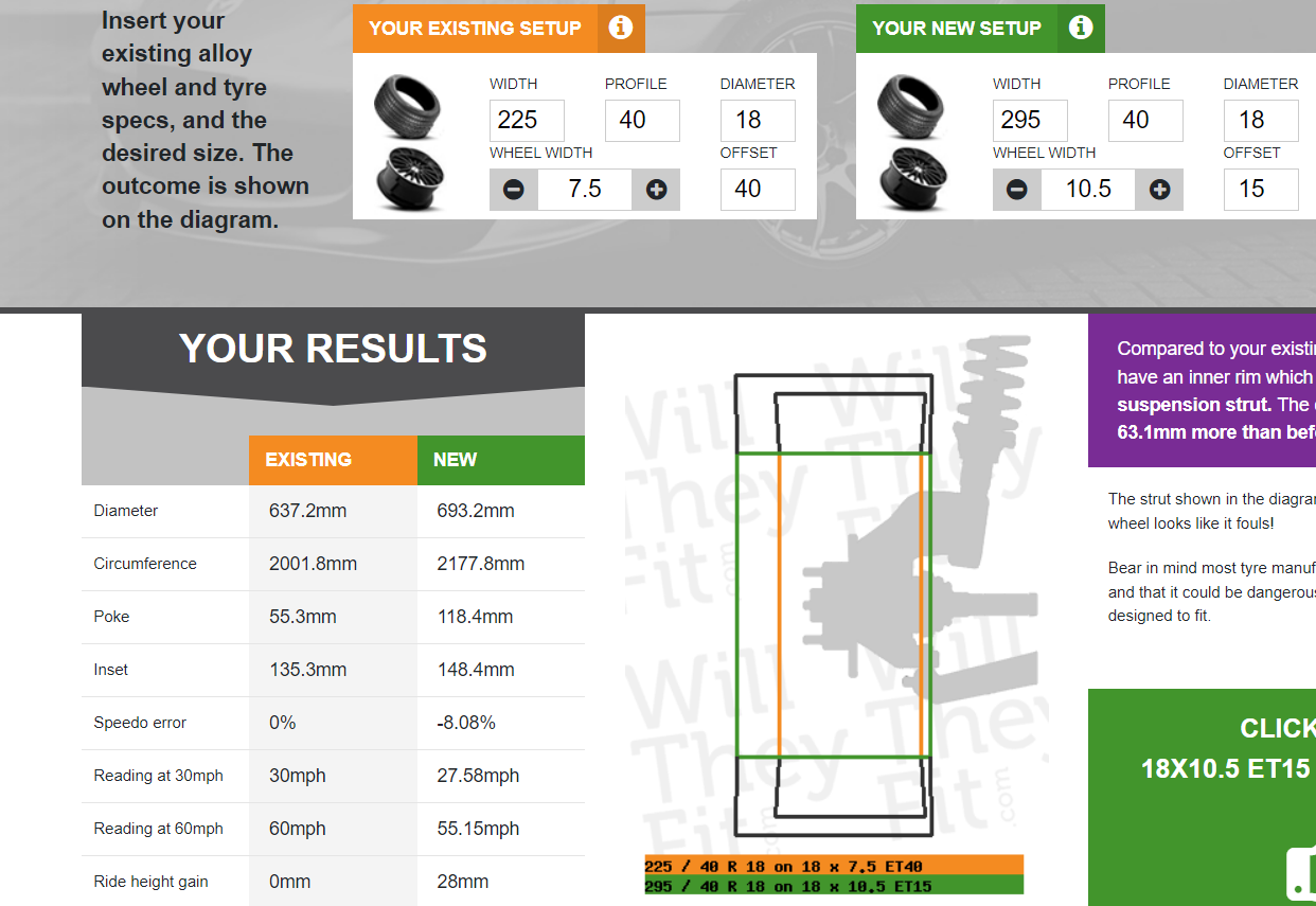

My goblin will be primarily used for street use with the occasional track day. From what I read, the NT05s should fit that purpose pretty well. Tires should be pretty close to flush with rims. According to the fitment calculator I used, the setup will be 13mm (0.5") closer to my struts but I will also be picking up 1" spacer adapters to convert it to 5x144.3 Speedo error is showing to be 8%

#1, I would double check rear wheel fitment. a +15 offset for a 10.5 wide wheel is going to be awfully close to the strut I think. Just make sure it won't rub. If you're running wheel adapters/spacers it probably isn't a problem, but if you have redrilled hubs it might be. Nevermind, looks like you checked this. I didn't read carefully enough.

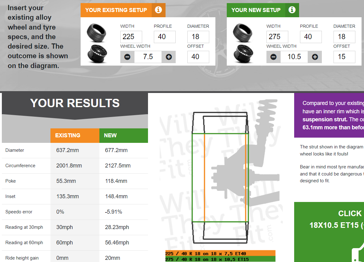

Thanks for the detailed response, I can tell you really know your stuff. The aesthetic I am looking for would be more of a square to meaty look. The calculator that I used https://www.willtheyfit.com shows the 295 to fit close to flush with the 10.5 rim. Picture below. I understand that the 295 will be too much tire for peak performance. If I do end up getting more into the autocross scene I can see myself purchasing a smaller setup, but for the time being, I am comfortable sacrificing a few seconds on the lap times. I have also considered dropping down to a 285 but some of my tire choices were limited in that size and going down to a 275 would give me more of a stretch fitment according to the same calculator. See second picture. With my front being square, I'm not sure how I'd feel about a slight stretch on the rear

I think the last set of wheels I got were 17x9.5 and had 275's pinched on them... they looked pinched but I think that's what you're going for. So going up 20mm and 1" would give you a similar pinched look if that's what you're going for. 275 on a 10.5" is technically square, perhaps with a hair of stretch. Compound also makes a huge difference.. you may want to try googling pictures of X size tire on X size wheel.. that'll give you a better idea than that calculator.

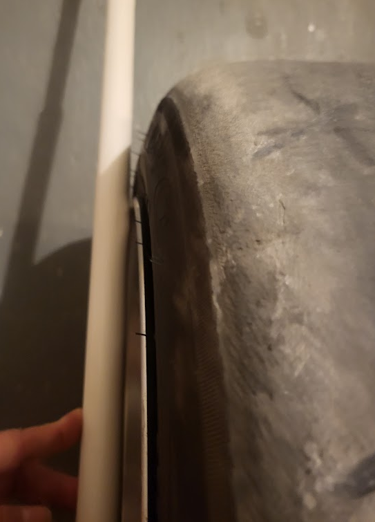

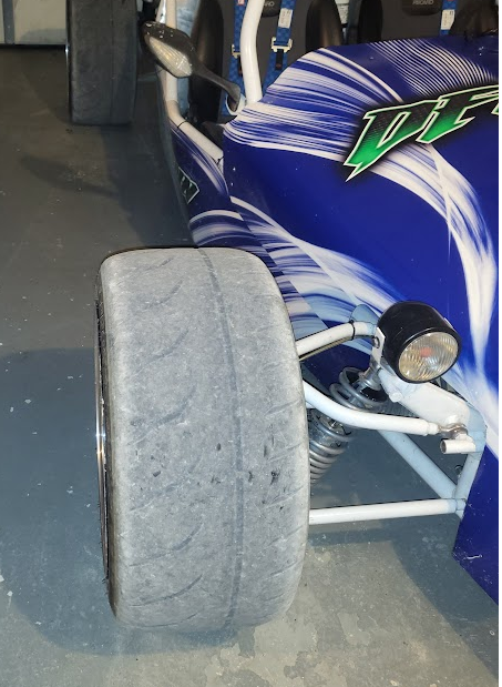

I'm running 275 R888R's on my 10.5" wide Cobra wheels. The white pipe is set against the wheel to show the little bit of stretch there is. Someone has completely worn the corners off of my tires, and they are almost bald at this point, which kind of accentuates the stretch. The tires looked barely stretched when they were new.
