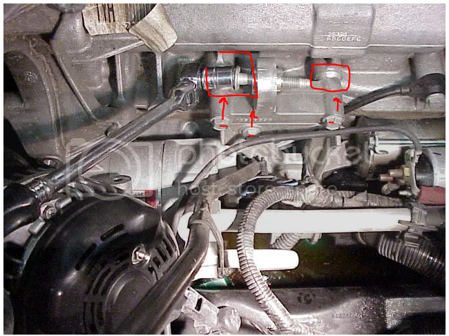

Is this the correct spots, all three go behind this bracket? To push this mounting block away from the engine to help support the manifold now that the phenolic spacer has mad everything about 1/2" further out?

I did previously, but that makes more sense now after finding the photo I posted. It looks like I may be right in my assumption of where these 1/2" thick washers go. One of the bolts is very close to the IC pump.

Yes, they are used to space the IC pump bracket as the manifold bolts to this bracket. I did mine during the rebuild and I will advise to leave all the bolts loose until every bolt is started to thread in. That lower bolt on the manifold is a ***** if you tighten down the IC bracket first.

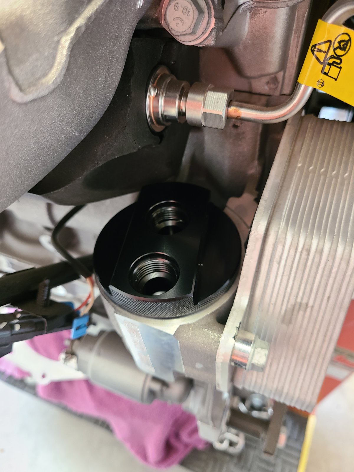

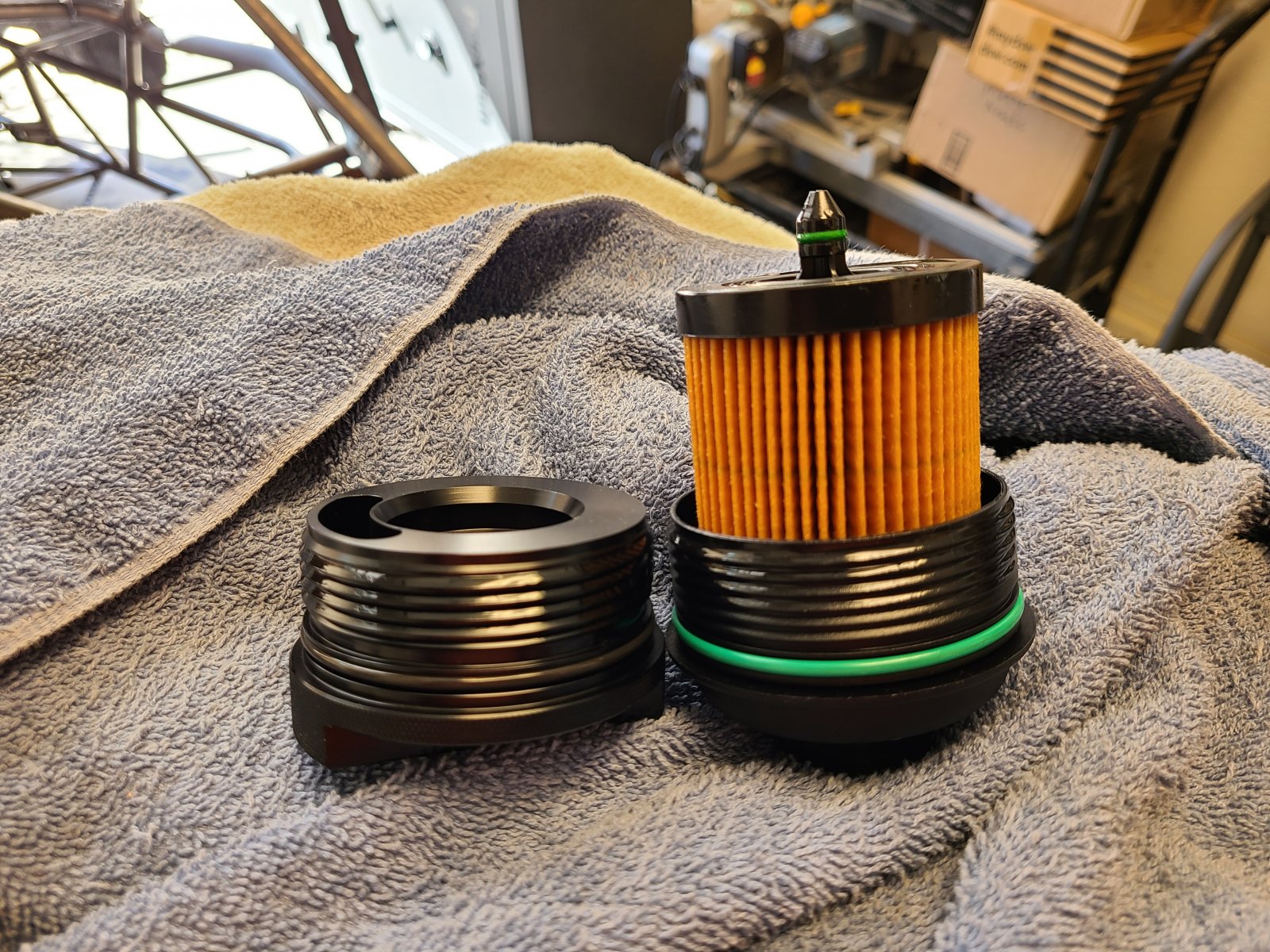

One thing I did notice, how is everyone changing their oil filters with the blower on the engine! It looks like a tight fit to get under that gargantuan chunk of metal.

Maybe you need one of these to set up a remote oilter?
After installing the phenolic spacer, it was very clear where the spacer should go. These space the bracket holding the SC heat exchanger pump away from the block by roughly 1/2" (about the same amount as the phenolic spacer). This is all to line up the 15mm bolt that supports the intake manifold underneath via this bracket. As mentioned previously, leaving the 15mm installed but loose helped with installation. I also ended up removing reinstalling the alternator and bracket to allow better access to this 15mm bolt. It could have been done without removing the alternator, but removal made the job a lot easier.

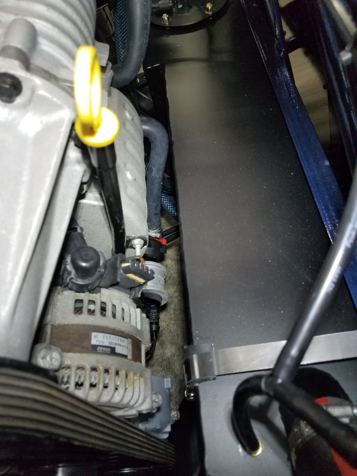

has anyone installed this spacer in the chassis? Reason I ask is I recall the gas tank being very tight to the intake while removal but I cannot recall how close.
I installed mine with the engine out. I will say it is very, very tight from the gas tank to the whole SC setup with the spacer in place. I'll snap some photos when I get home, if that'll help you at all? If you can even unbolt the engine and subframe to slide it back a few inches, it would help you out tremendously.
