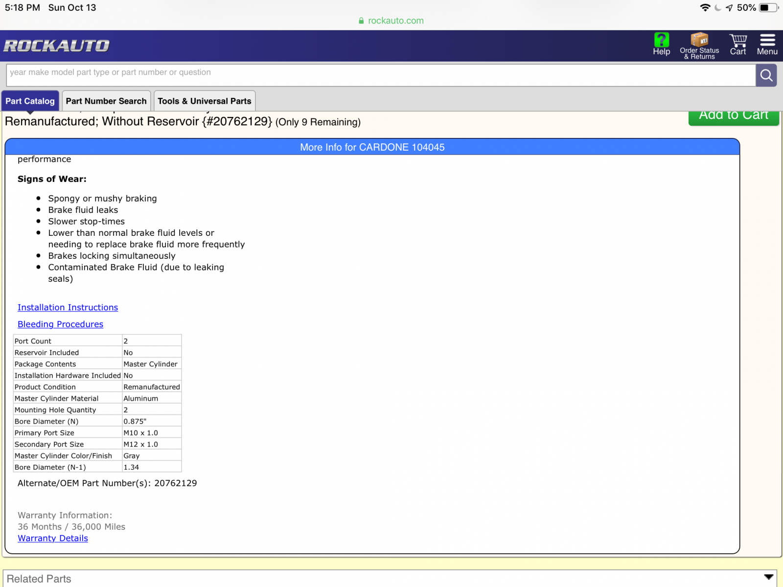

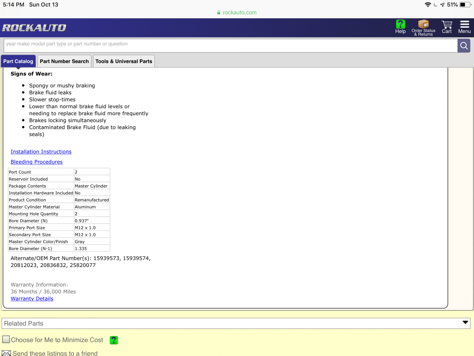

I have locked up the brakes several times now and the front seems to be very easy to lock before the back. My donor was a 2009 SS. I see the master cylinder is different between the standard and the SS, and the Brembo brake volume. Would this make a difference? I am wondering if I need to persue changing the master cylinder... or go another route. The attached is from Rock Auto.

Next only to the turbo the Wilwood manual master cylinder was the best upgrade I have done to my car. Incredible amount of additional brake control. I was smoking them fairly regularly, haven't locked up once since.
BAR-AIR
The Wilwood manual master cylinder works great (definitely not locking up the front like it used to). The only thing I have noticed is that I’m getting some movement on the pedal (brake and gas) mount.
