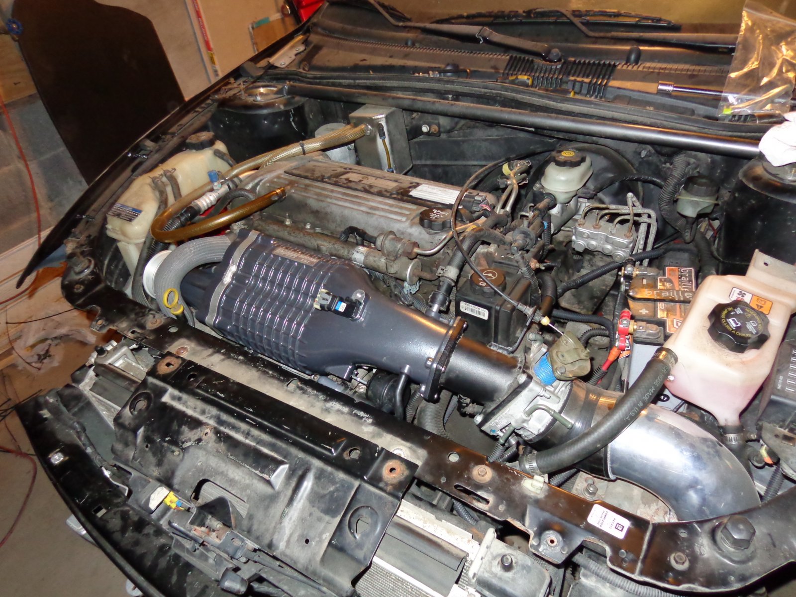

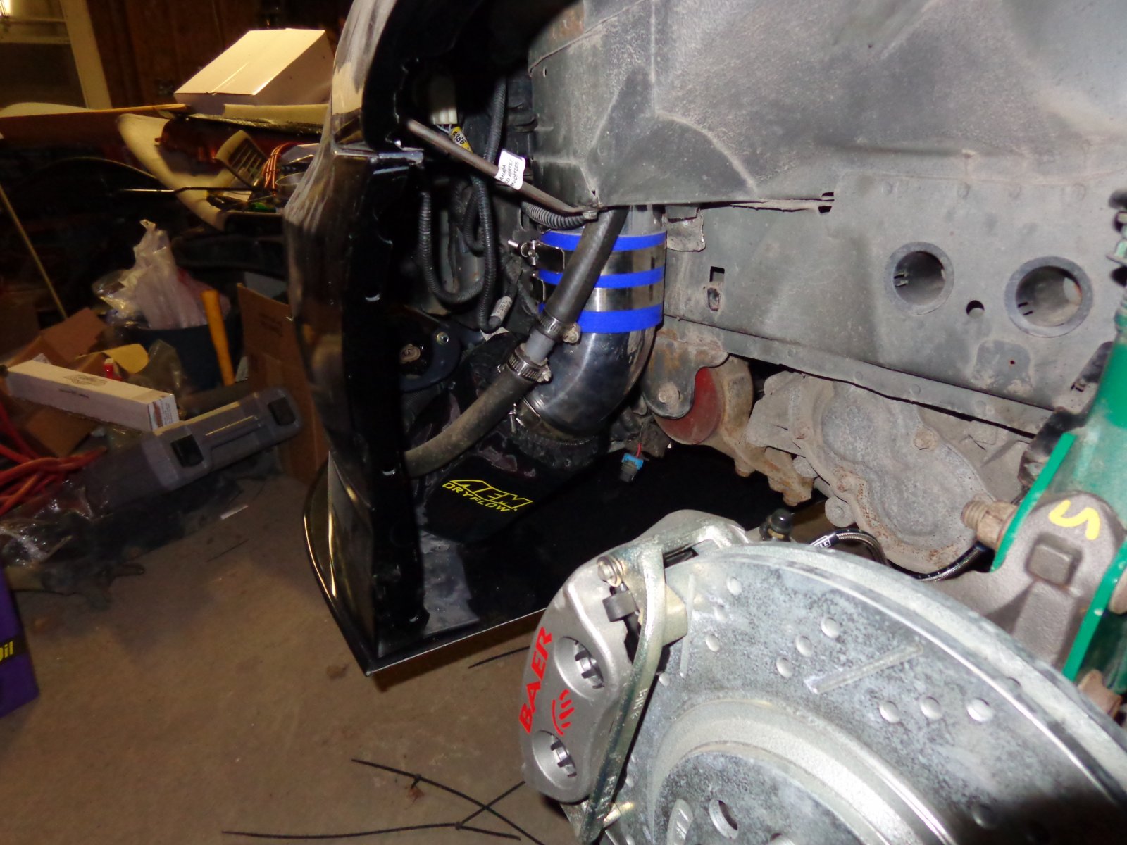

On my Cavalier I kept with the 4" diameter of the LS1 throttle body and shoved the biggest AEM filter that I could into it. I plan on doing the same with the Goblin.

Nope, LS1. Cavaliers are not drive by wire. It has been almost 10 years since I had the custom throttle body adapter made, but if I remember correctly the throttle blade on the LS1 is 3" and the opening of the TVS is 3", so just toss an adapter with a 3" I.D. in the middle and you have no reduction in flow. The opening of the LS1 flairs out to fit a 4" coupler nicely.
I have an LS2/LS3 to LS4 throttle body adapter and plan on using a cable drive converted LS2 throttle body on my Goblin.
