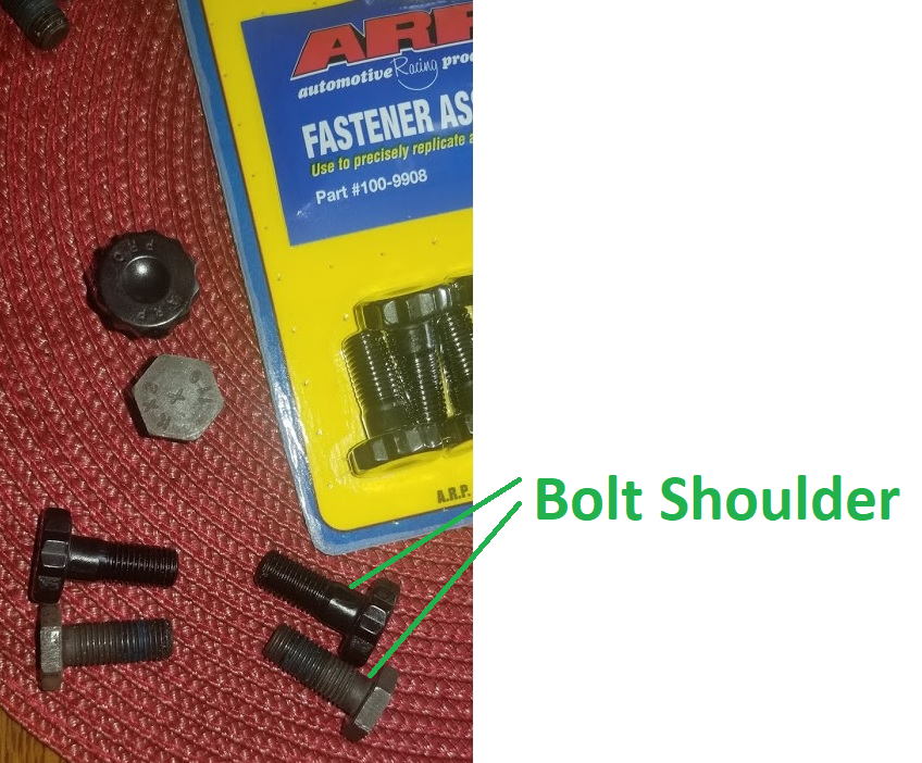

I found grade 10 (actually the metric =) bolts of the right thread x length at autozone (in the misc help section) and ground the heads down on a bench grinder.
Not to be argumentative but be careful, grinding on graded bolts can reduce their tensile strength if done improperly. The heat from grinding must be removed/cooled very slowly to keep the graded strength. Air cooling is sometimes too quick and quenching will make bolts brittle. I would opt to pay a few $$ more and get the correct bolts for peace of mind - IMO.

Did you get flywheel bolts with a shoulder on them?
The ARP bolts have an 8mm shoulder before the threads start... better for the flywheel to rest against, my flywheel is 9mm thick at that spot.
The stock flywheel bolts are at the bottom of this picture, with the ARP bolts above them. I too had to grind the heads down on the ARP bolts, but the Polaris bolts should be the right GM size.
