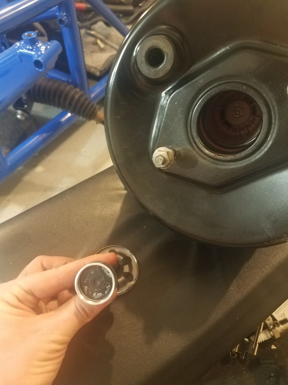

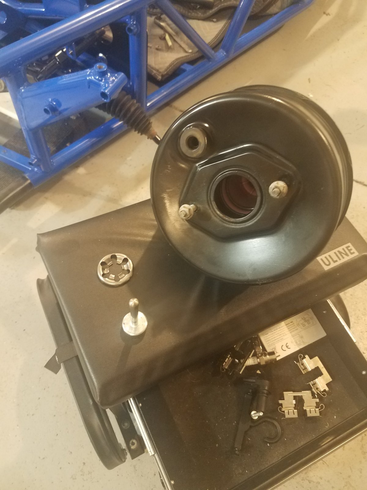

I learned something about brake boosters tonight that I would be happy not knowing.
While attaching the push rod from the brake booster to the brake pedal I pushed the booster with no master cylinder attached. This detached two parts inside of the booster. I managed to fish the parts out of the hole.
Is there anyway to reattach these or am I stuck buying a new one?
I'd really like to avoid another $100 surprise expense. I have had too many of those lately.

I’m not exactly sure which part of the booster that is, but I can tell you the booster won’t separate without pretty much destroying it.
The other option is to throw it in the trash like I did.

So is this fixable, my two parts are also disconnected and completely lose inside?
lksohm
I did manage to get this booster back together after this. It has been a while but I think I just kinda pressed it together by hand and it held. It has been on the car and on the road for 3 years since with zero signs of issues.
