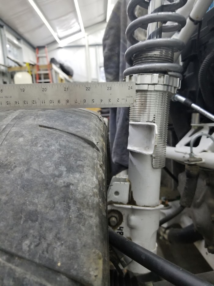

That extra 18mm wouldn't rub my goblin when going straight...
My goblin has stock shocks, and a coil over kit on it.
My wheel spacing is about 6mm wider than stock with the aftermarket wheels,
so your wheels would be about 5mm away from my shocks.... might rub when cornering.

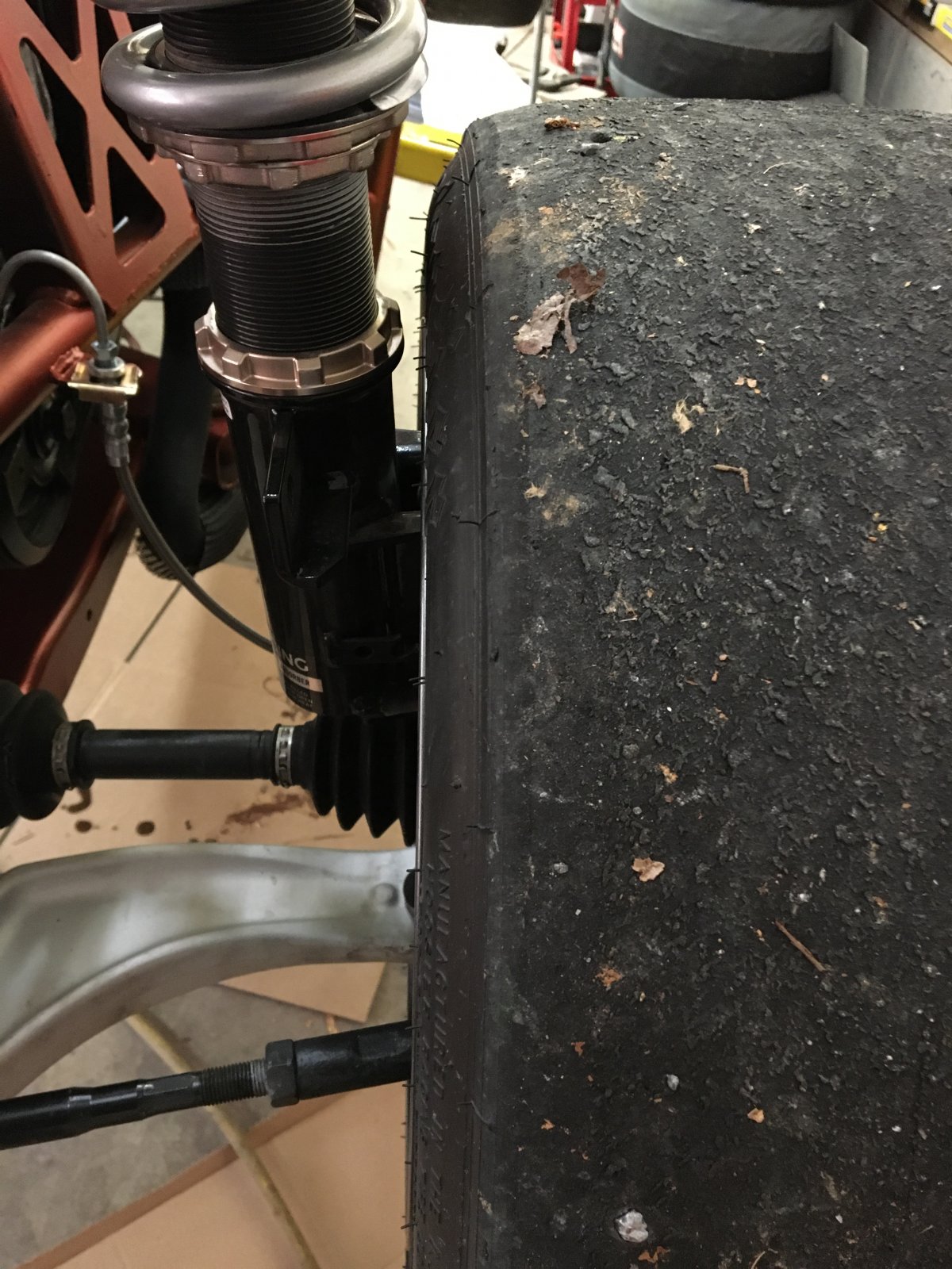

I have 15x10 et 25 with BC coilovers " https://www.good-win-racing.com/Mazda-Performance-Part/61-2422.html "on all four corners no rubbing in the rear but rub front control arms close to full lock. I think a 16 or 17 in the front could solve this issue or narrower front control arms. By looking at the 15x10 25et wheels your problem would be making contact with the spring with the taller tire.
