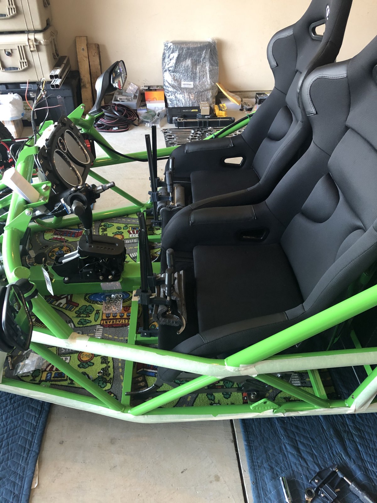

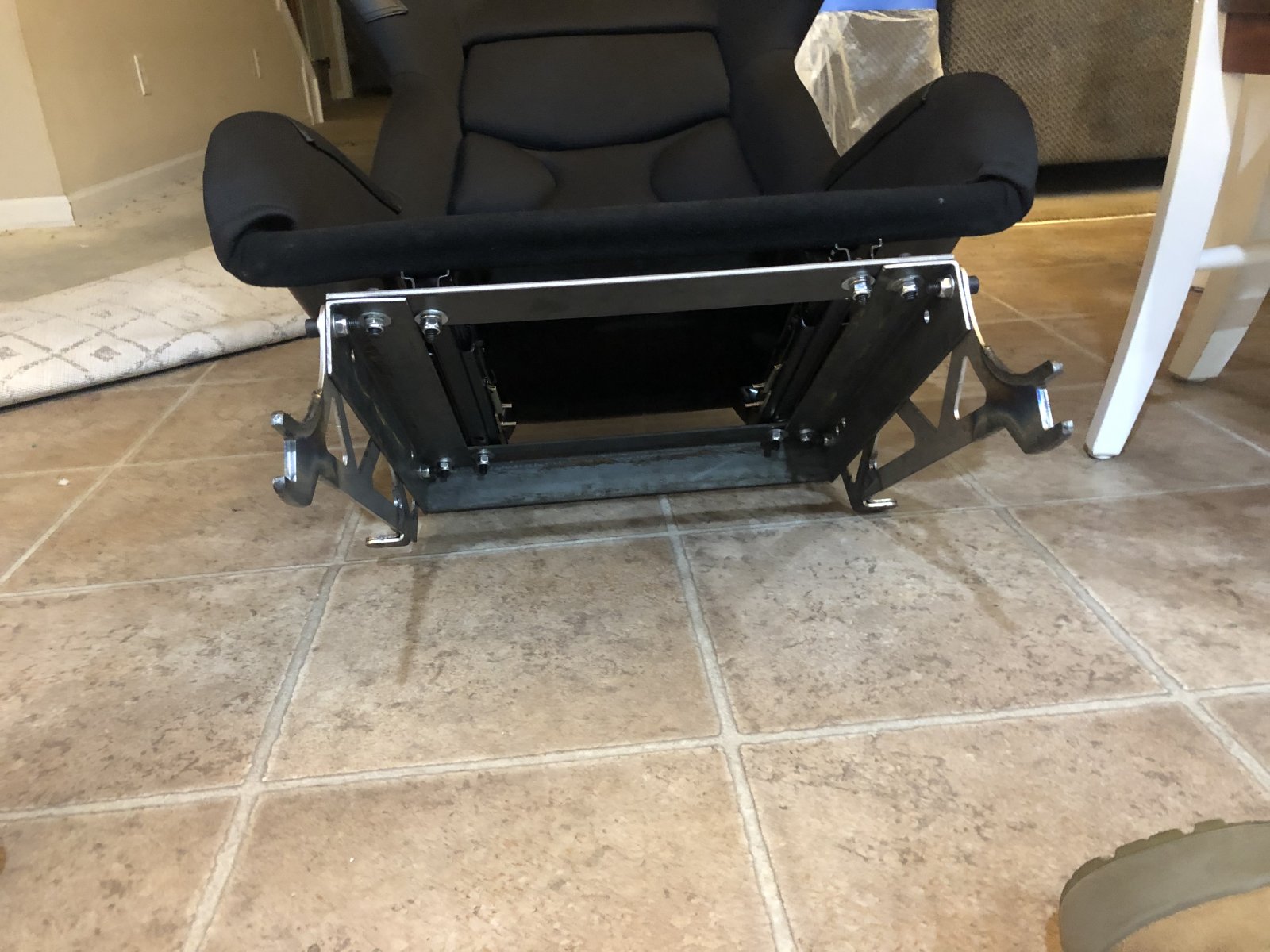

I got the Corbeau FX1 Pro Wide seats and I can't seem to get them to fit. The upper outer bolster hits the chassis and the lower inner hits the parking brake handle. They also don't fit between the seat brackets on the widest setting.
Do these not fit? Do I have the wrong brackets? Chassis is standard length track configuration.

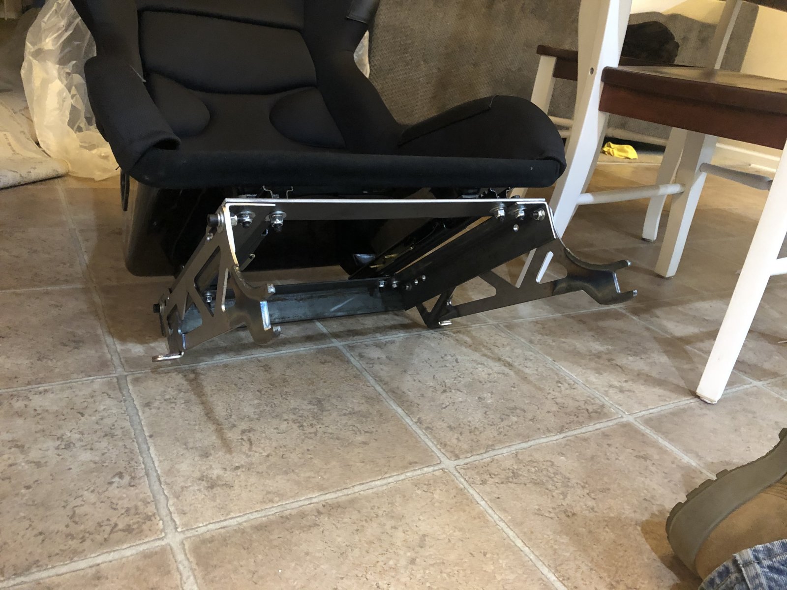

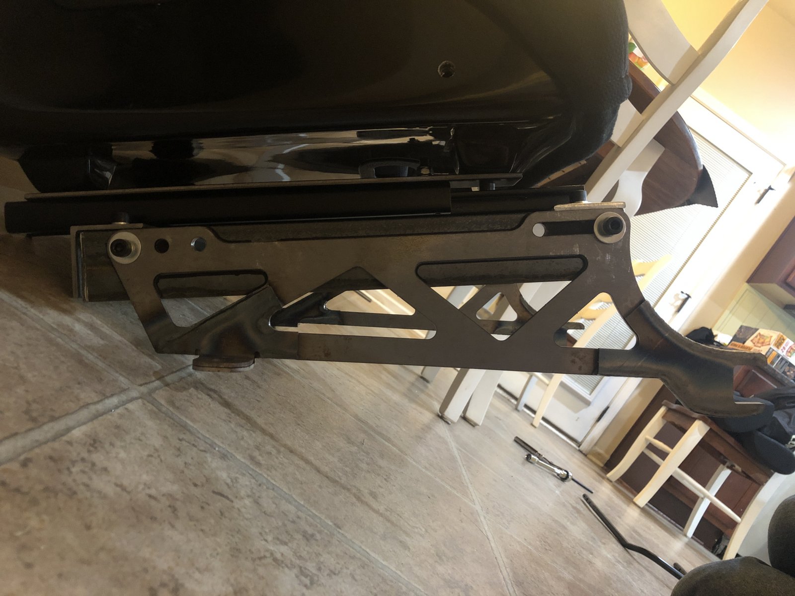

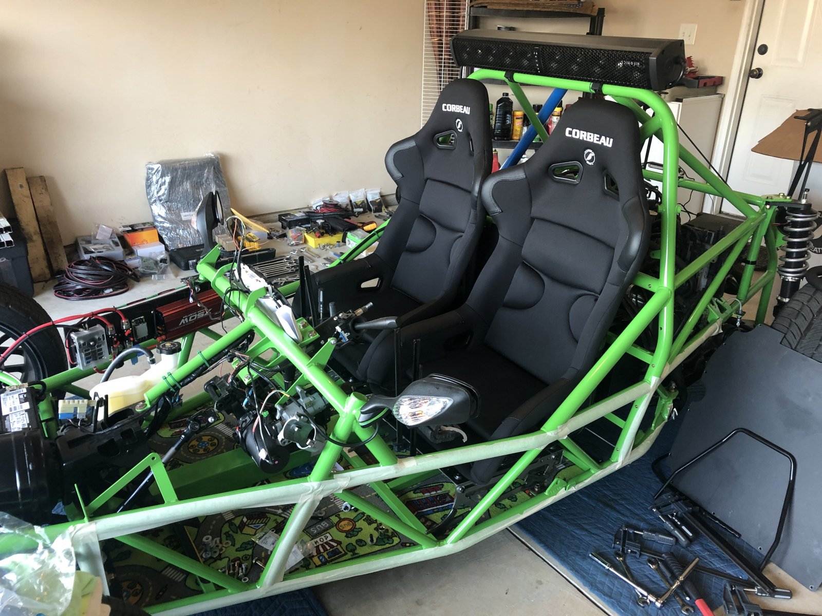

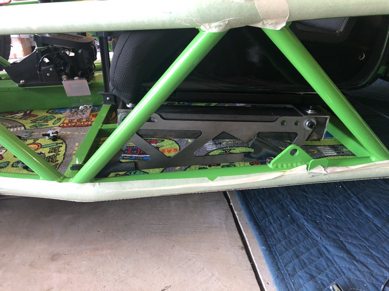

I HAVE SOLVED the FX1 Wide issue. I used the DF mounts at its most narrow position, added 2”x2” (2”x3” would’ve been better) angle iron to the inside flush with the DF bracket, bolted a cross bar (wouldn’t need if used 2”x3” angle) to mount the slides, on top of the slides I have a 15”x 1.5” flat bar to mount the chair to slides since my slides are too short.
