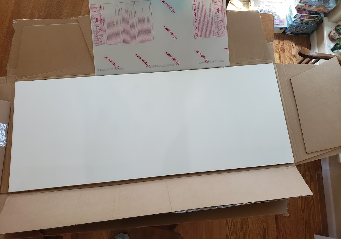

Yes, I used a bandsaw on my polycarbonate prototype windshield.
The 4 windshields just came in the mail today. The little sheet at the top is the scrap piece left over from my prototype, and the white is
the protective coating on the TUFFAK AR2 (Abrasion Resistant, 2 sides) UV protected sheets, 2 feet x 5 feet. I still have 1 sheet for sale.
