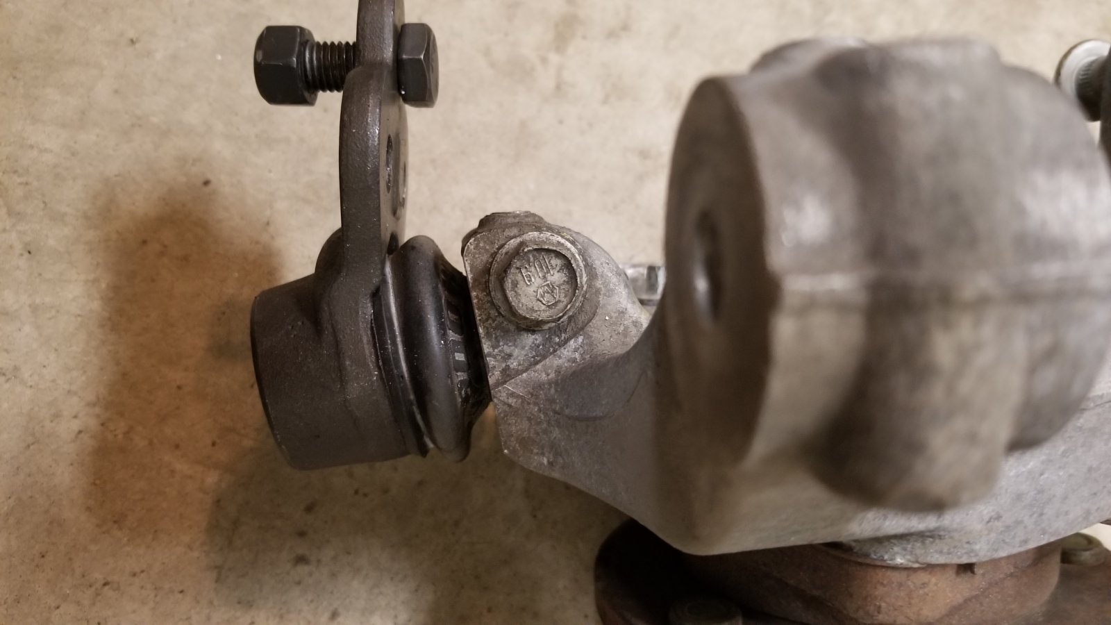

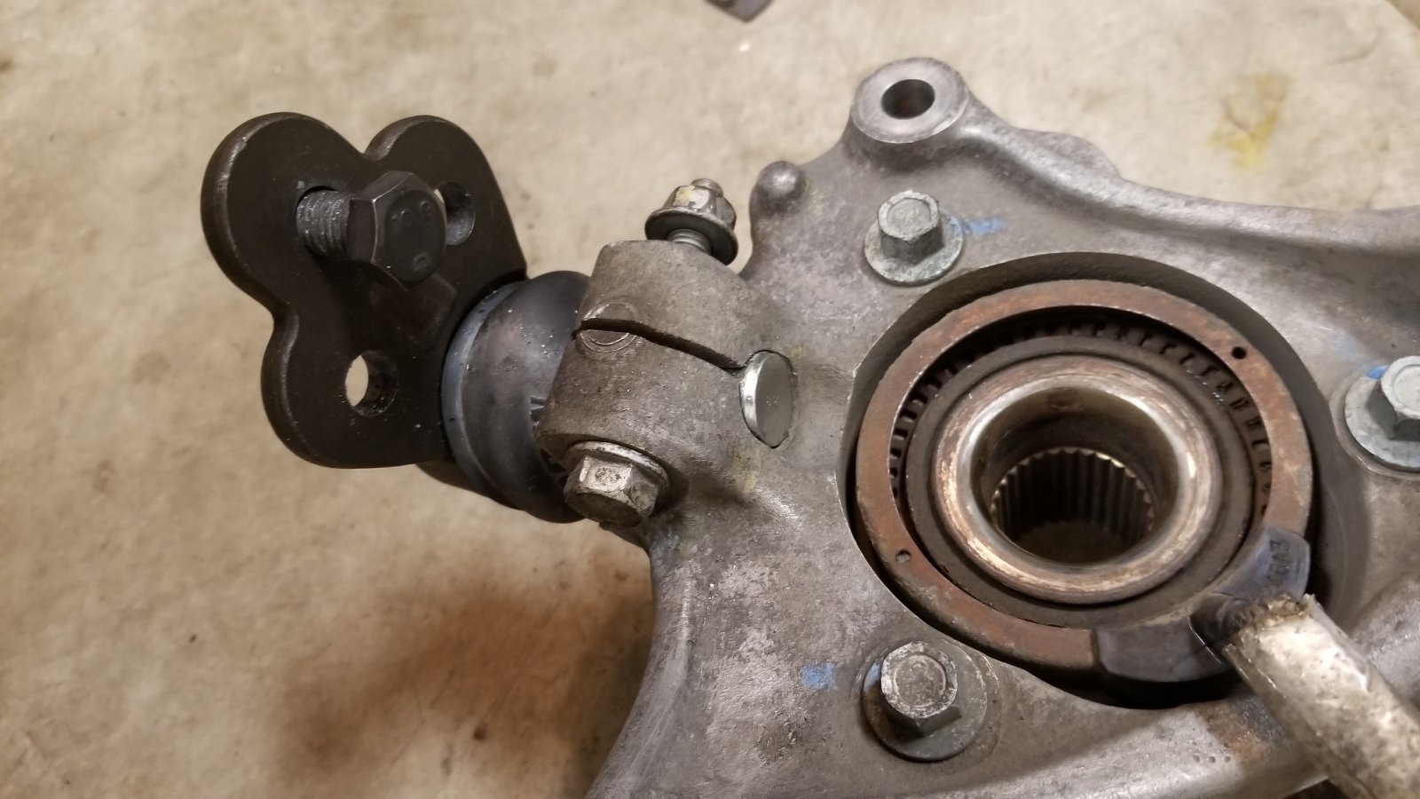

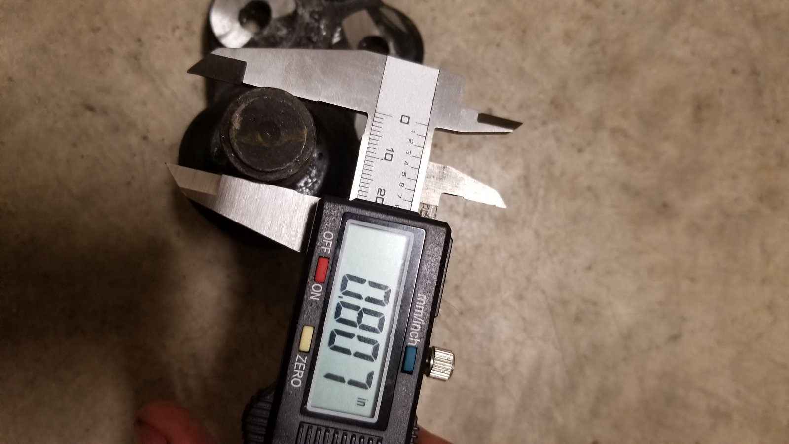

Anyone with the FE5 TC suspension having trouble locating things like ball joints? I ordered a set of Moog ball joints (K80567), stating they fit the FE5 suspension - they do not. The post in the ball joint from the Moog is 0.785 inch diameter and is gapped in the suspension upright mounting location. The post on the TC FE5 ball joint on my donor is 0.805 inch diameter and it obviously fits the suspension upright correctly, since it was removed from it during my teardown. I have looked at several different ball joints at O'Reillys, Autozone, NAPA and all are the 0.785 inch diameter posts, but all stating they are a replacement on the FE5 suspension - nope. If someone has replaced their ball joints - on the TC FE5 - and has a source, please let me know.

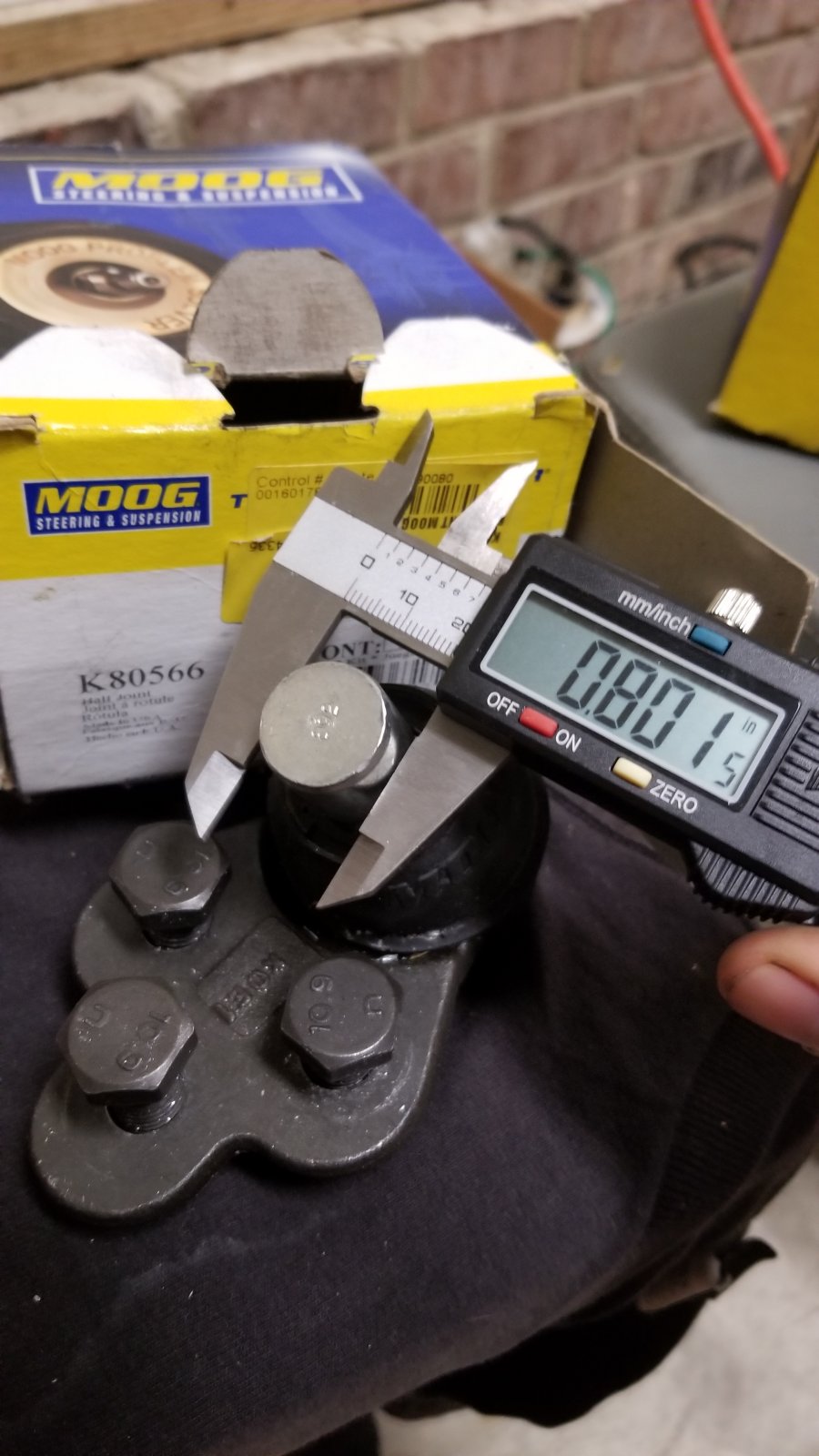

Thanks for the info. I ordered a set, will check them when they arrive to be sure of dimensions. Interesting that these parts are not advertised as FE5 specific, but show as being compatible to the FE3 and FE1 suspensions. If these are truly the 0.805 dimension they will not work in anything but the TC uprights - unless the mounting hole is drilled out to a larger size. :rolleyes:

Finally got around to looking at installing the Moog K80566 ball joints and they have the wrong size stud. They have the 20mm stud not the 20.5mm stud needed. Are these possibly just missed labeled?

It looked like the parts above would have worked, at least they seemed to measure the same. One of my ball joints is pretty loose so since the K80566 ball joints didn’t work, all of the parts will be returned and GM control arms will be ordered.
