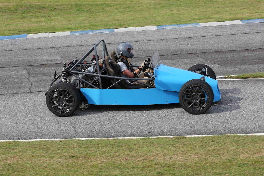

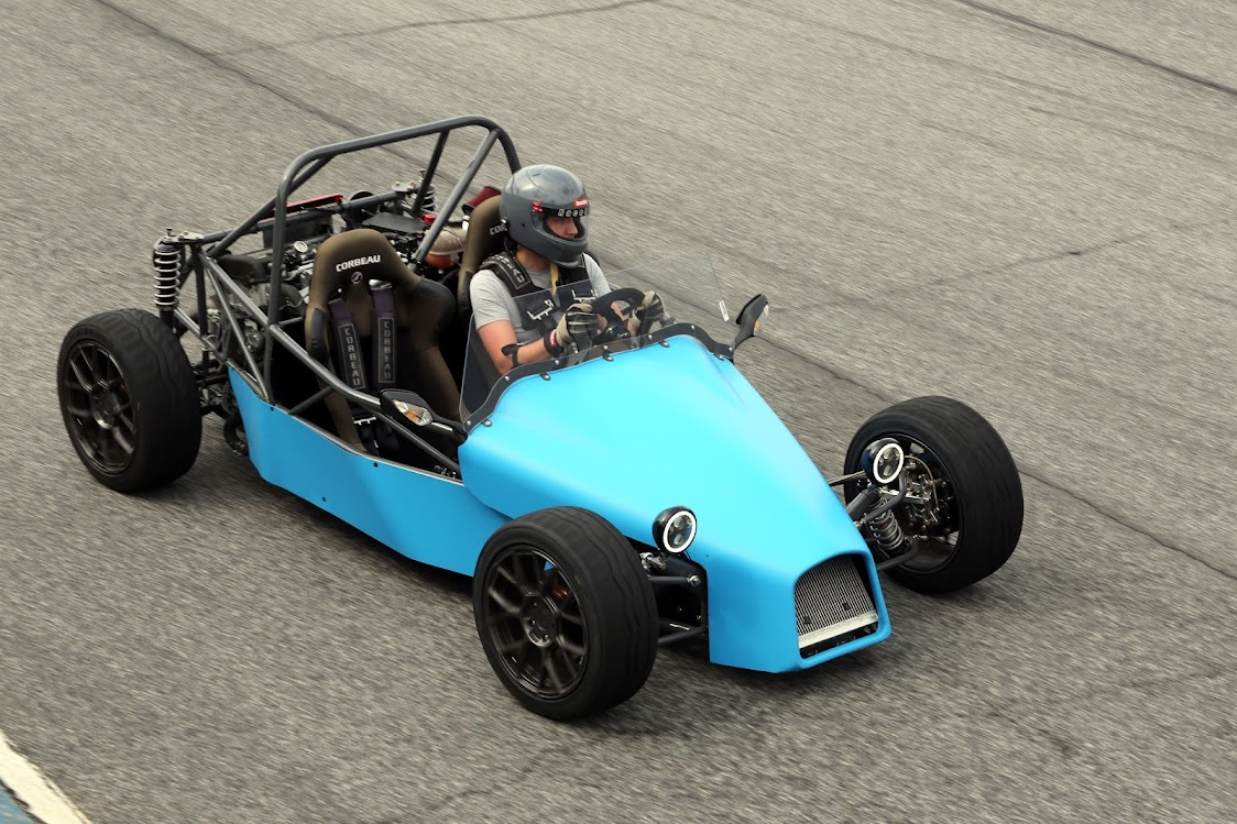

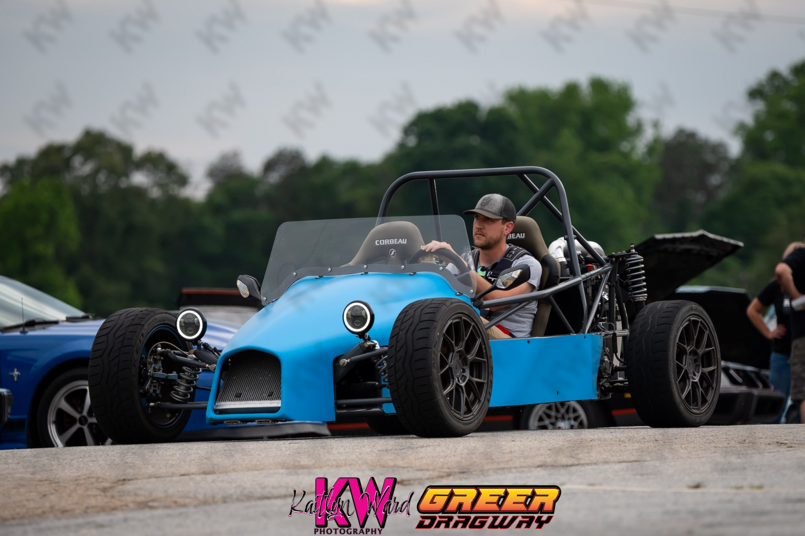

Awesome, that's great intel. Well, I am looking at 2 used ones from the forum currently. I will find out what chassis they have. The seats are less concern to me, worse case I change them. But the length is important. Do you have a picture of you sitting in the car?
41321
41322
41323
Best I got on-hand. You may be able to find a Goblin near you, although this list doesn't stay super up-to-date: https://dfkitcar.com/forum/index.php?threads/official-builders-thread-where-are-you-located.3418/

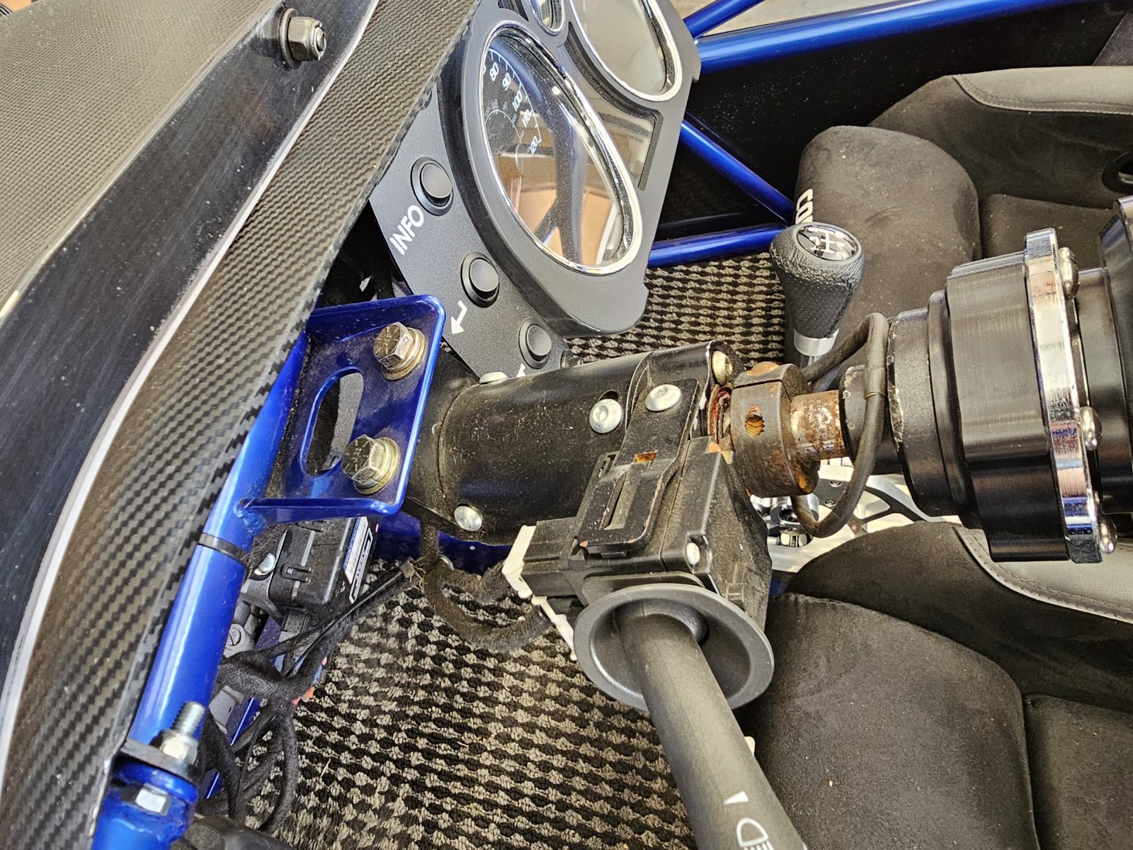

6'3" and 230lbs. I have a track frame with full door bars and I'm comfortable driving it. Getting in looks a bit like reverse birth but a detachable steering wheel would help me a lot. My biggest gripe about being a bigger guy in a goblin is that 13w shoes and the cobalt pedal setup get a little tight you've got to be right on otherwise you end up just mashing all the pedals at once.

I’m 6’2”, 280lb. I have an extended track frame (extended frame is the standard nowadays), with double door bars. Detachable steering wheel is a must, and I fit great with my Kirkey 55 Series 20” wide seats (Planted brackets with 2.5” aluminum square tube spacers).

a detachable steering wheel will help you get in and out. Different types of wheels can help with spacing.
