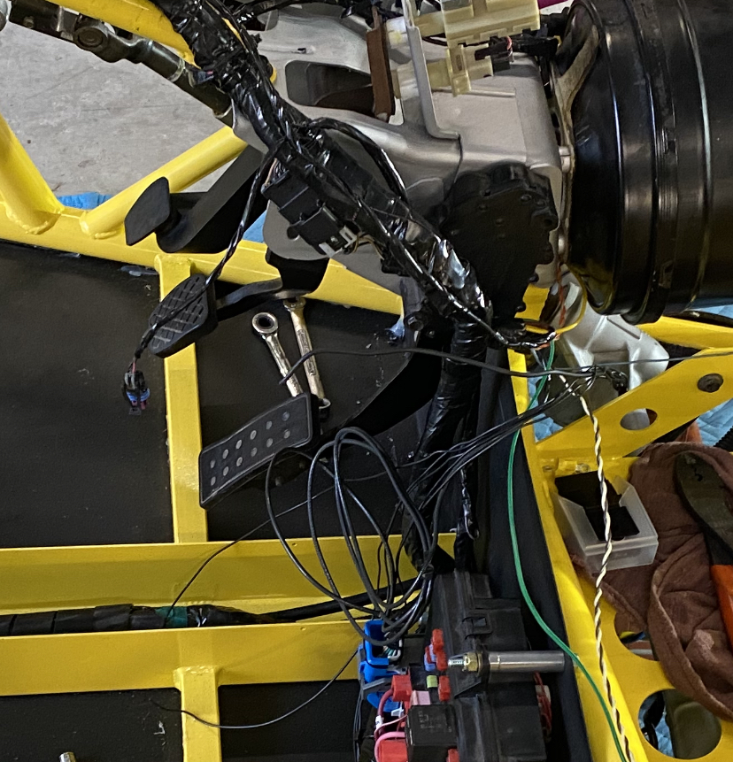

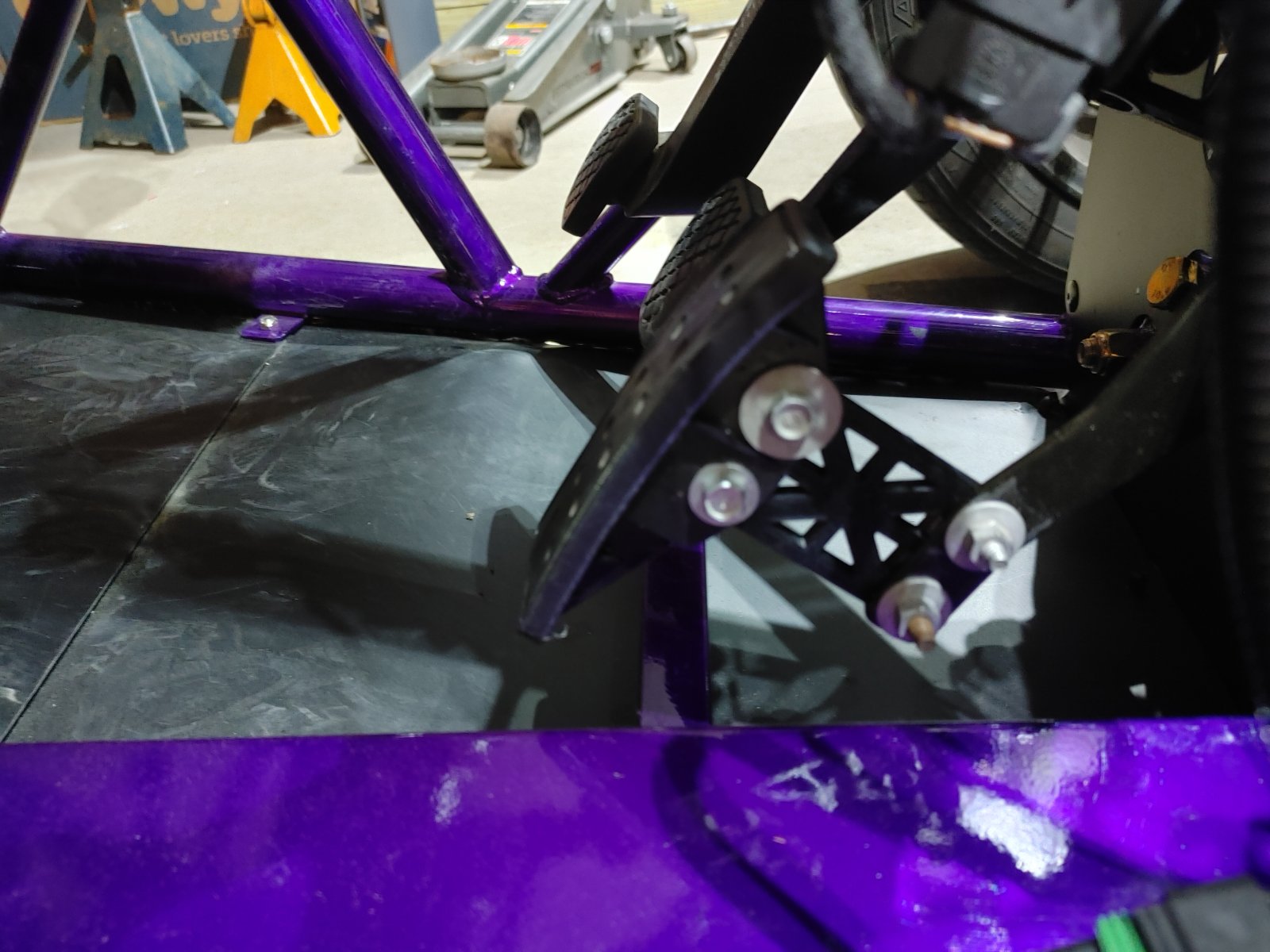

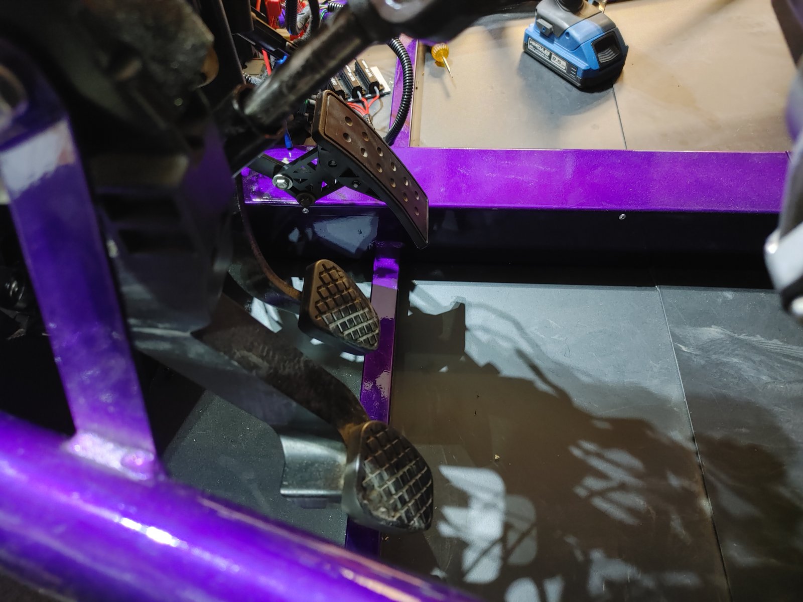

We mocked up the seats today and noticed that the gas pedal is much further away from the brake and clutch pedal, this also means it is much farther away and harder to press when in the seat. Is it in the correct spot?
36439
Just realized I probably should have got a photo of the top half of the pedals, I will get that tomorrow.
I'm the same height and have no problem, but I have the "old standard length" frame, you don't.
If you got the Corbeau seats offered by DF, then it's likely in my opinion that you'll need to stretch to reach the gas pedal.
There are people here who extended the reach of the gas pedal via 3d-printed extension. I highly, highly recommend pausing for a bit to read through some build threads, even if you only skim. They can answer a lot of questions before they are even thought of!
same here. Mine is also the shorter frame and I use NRG seats, adjusted all the way back. I’m 5’9” with 11.5” shoe size. I use race shoes to be more comfortable. I have driven a few extended frame goblins, with various seats and all of them I had to adjust the seat forward to get comfortable. Not sure if your seats are adjustable.
the throttle and brake are in the same configuration as a stock cobalt.
