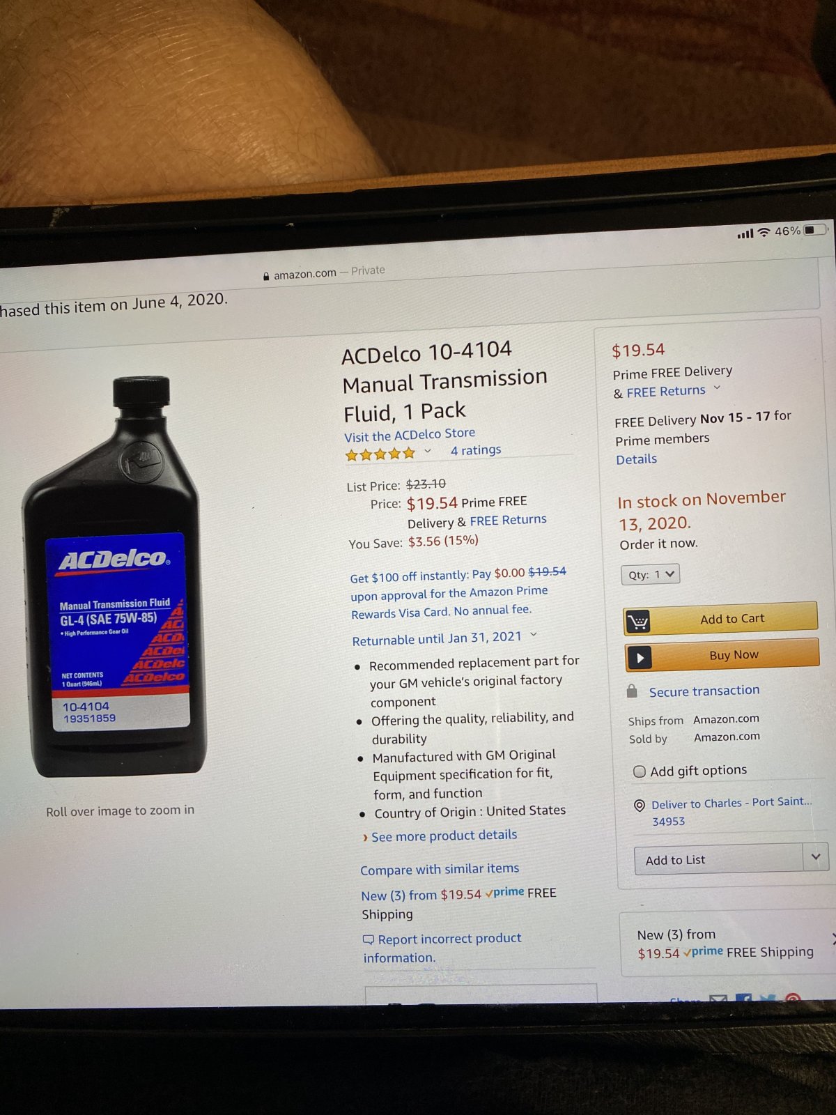

Post 12
I read that you should only use a specific GM trans fluid, not redline or royal purple. Your mileage may vary, though. I don't think it's as dramatic as the cobalt folks portrayed but I followed their advice.
I got two of these 75x85 P# 10-4104 from Amazon for my 09 SS/TC.
That’s what I did out of fear. Ordered from the GM dealer and got it the next day. Wasn’t even that expensive. It’s been updated a few times also.
