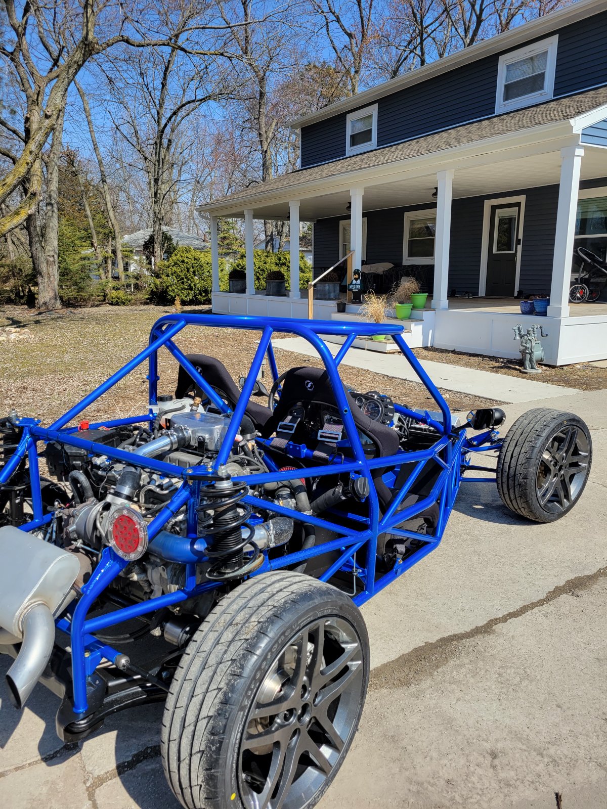

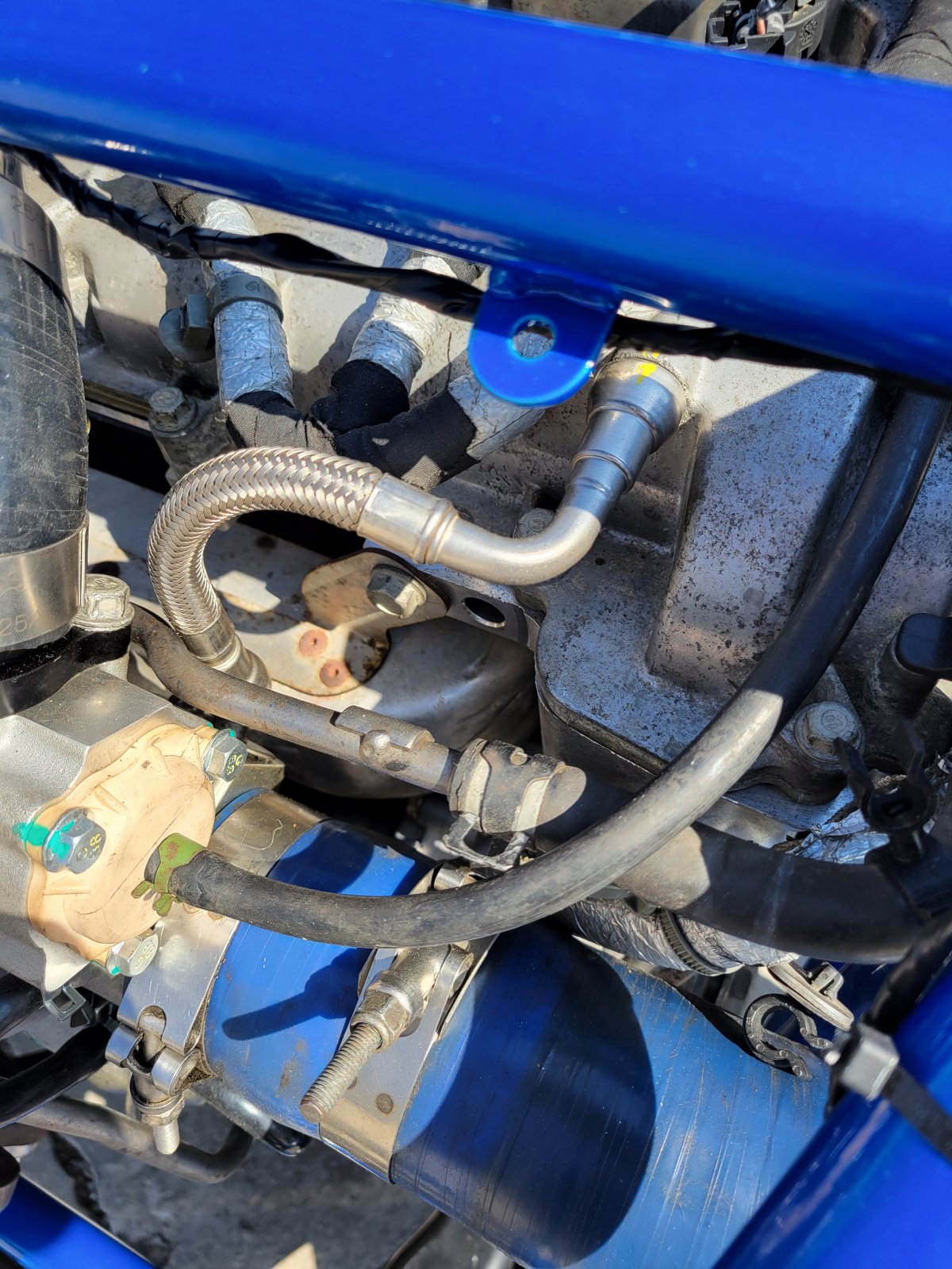

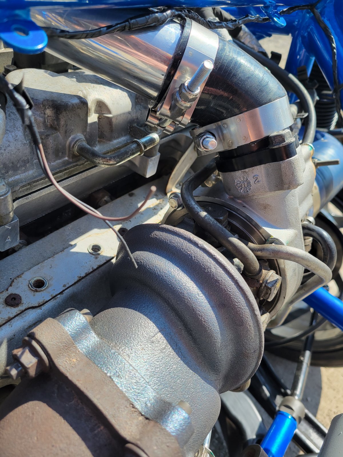

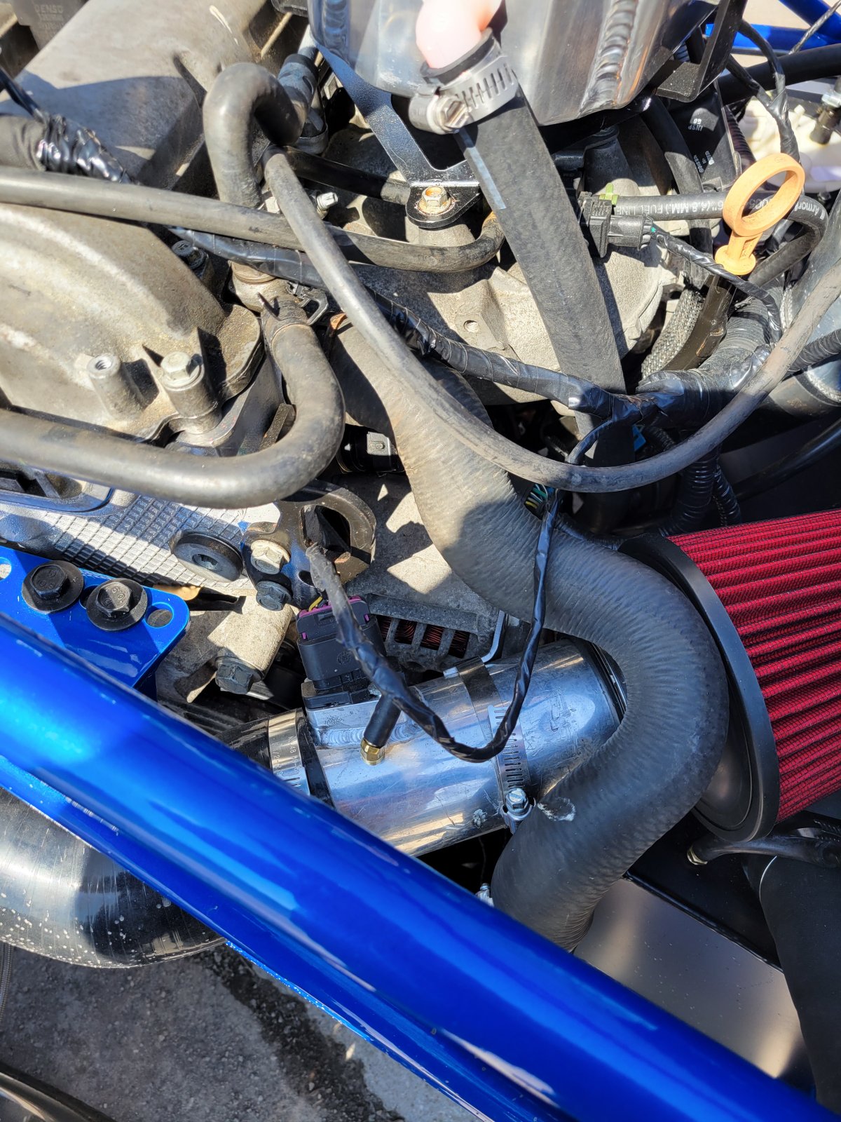

I've got the car almost road ready. I need to dial it in and finish up a few things. Take a look at the pics and let me know if I have the vents and plumbing right. It runs very poorly, seems to straighten up a bit one it warms up, but it isn't healthy, and is very jerky in gear.

Any codes present? Did you make any changes since removing it from donor? Valve cover vent behind turbo should go to intake tube but I doubt that is your problem.
Any chance your MAF is installed backwards? O2 sensor connected properly? Might be worth checking for vacuum leaks too, although that's probably not going to make it run rich.
