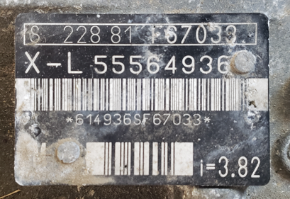

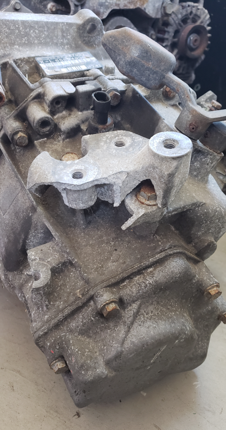

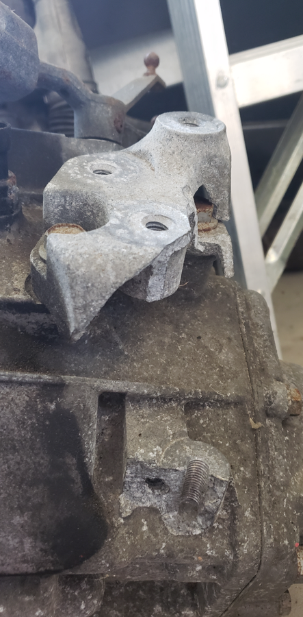

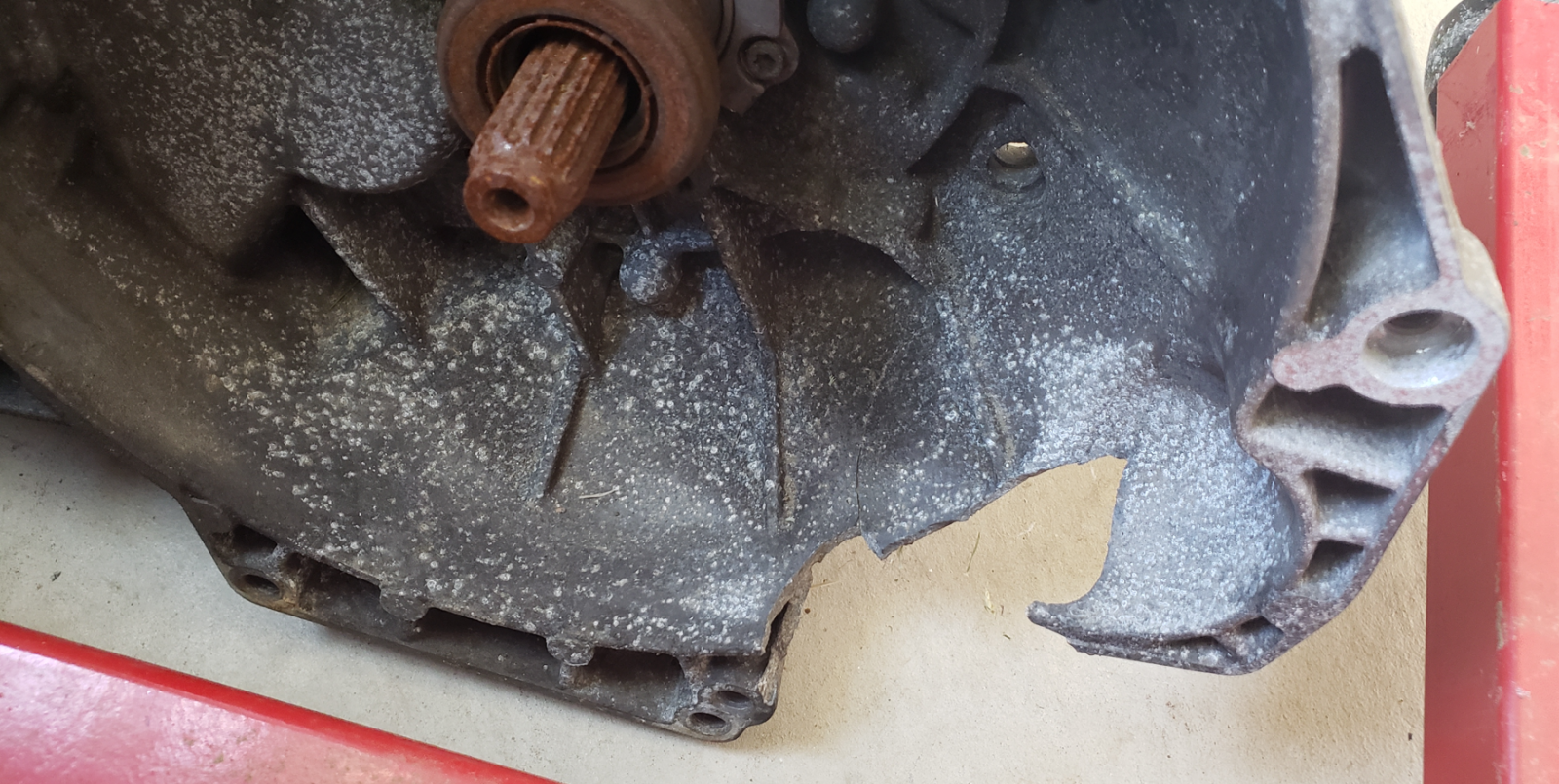

This transmission fell into my lap but it is in rough shape. When it came out of the donor it had a cracked bell housing and mount from what I am assuming was the accident. It has a LSD but with F35 transmissions being expensive/hard to work on I am wondering if it is worth trying to fix?
I have the piece of the mount that could be welded back together but the bottom bolt hole on the transmission itself is also broken. I also have a large piece of the bell housing that has the bolt hole in it but I am missing some chips from the inner part of the hole.

Unless you know for sure how the transmission is internally, I wouldn't pay someone to weld it up unless you can get a super deal or weld it yourself. Having the LSD makes it desirable for parts; don't junk it.
M
I am certainly not going to junk the whole thing. What is the best way to go about sourcing another F35? Even if it is not a LSD I could swap the internals of this one into another shell.
