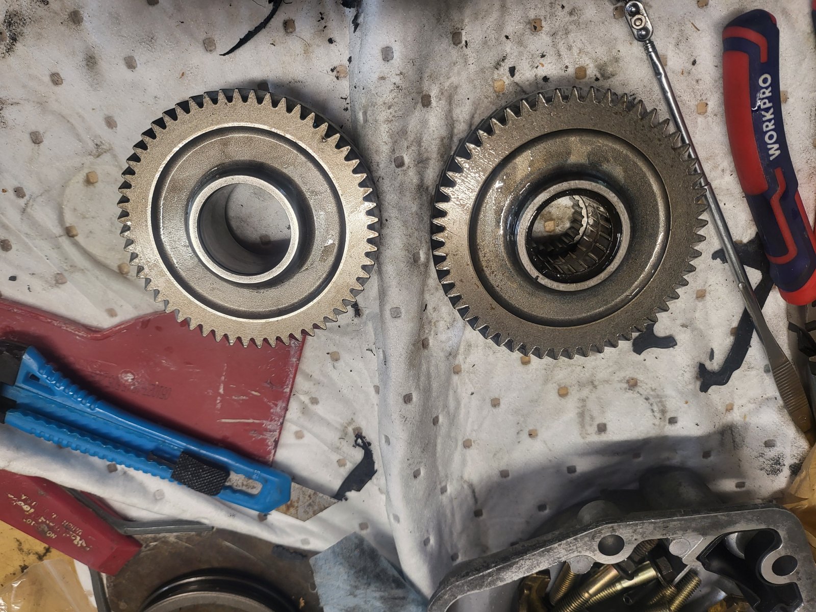

5th gear on my goblin is toast. It keeps popping out while cruising down the highway (i have already disassembled to verify). I ordered part 9117777 from esaabparts.com, along with the "sleeve ring" (90511264). The sleeve ring is perfect, (as are the synchros, retaining ring, little spring clips, etc...all the same) but the 5th gear itself has 53 teeth, and is ever-so-slightly larger in diameter than the 54 tooth gear that came out of the transmission. I assumed all F35 saab transmissions would have the same 5th gear.... a bad assumption on my part.
So, I'm looking for part 90541200, which is a GM part number. I cannot find it in stock anywhere though. Further, I have no way to verify if it has the 54 teeth I need.
Does anyone know where I can find 90541200? Or, do any of you have a spare F35 5th gear laying around they can sell?
C

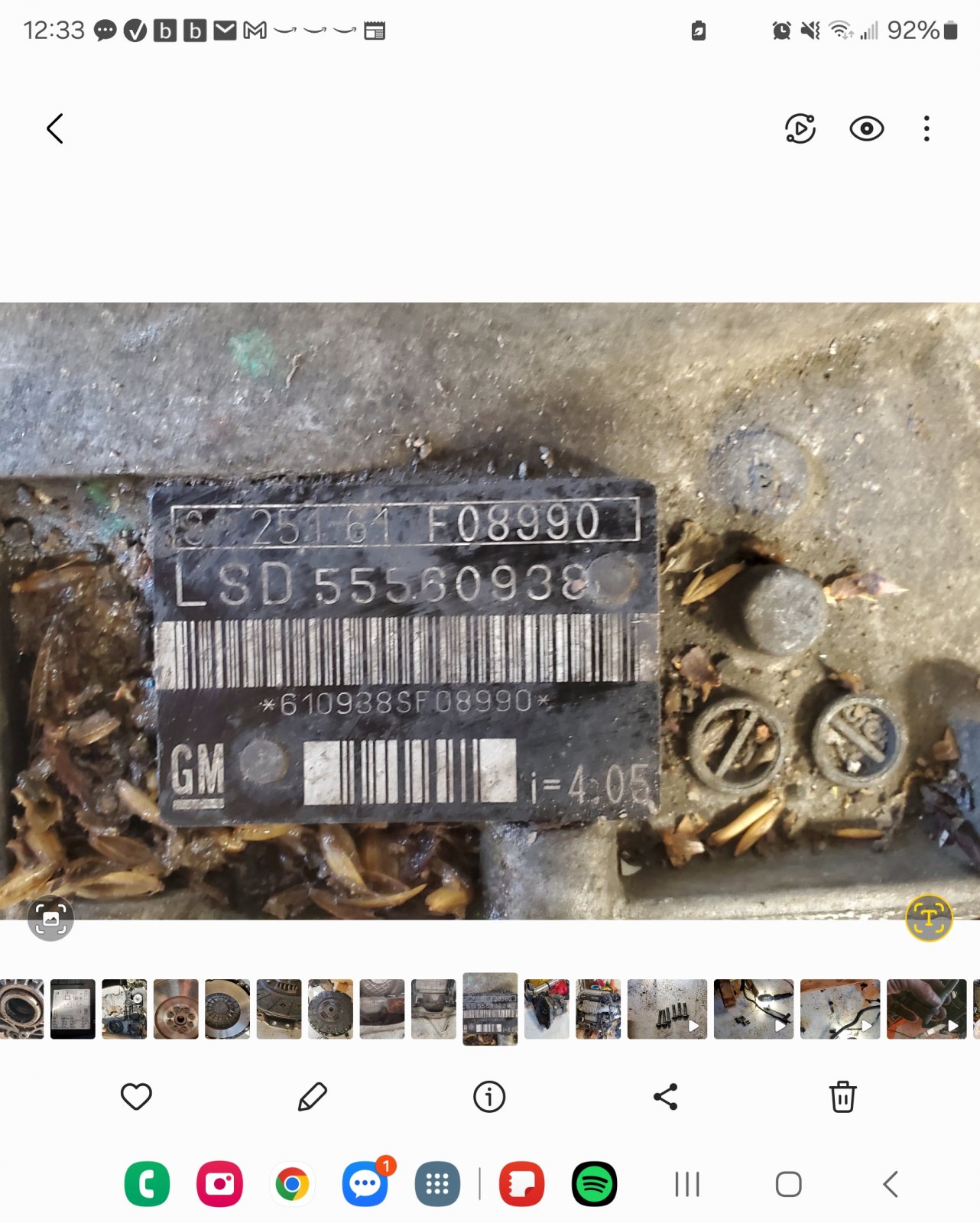

Photos included. The two gears are not quite the same despite looking identical. Also attached a photo of the transmission data tag.

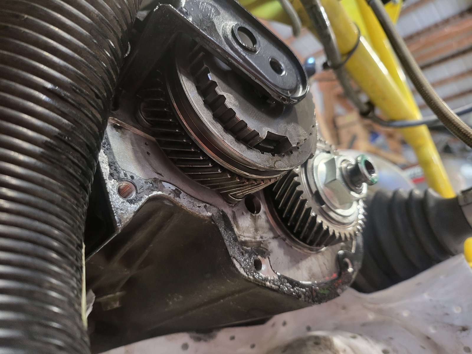

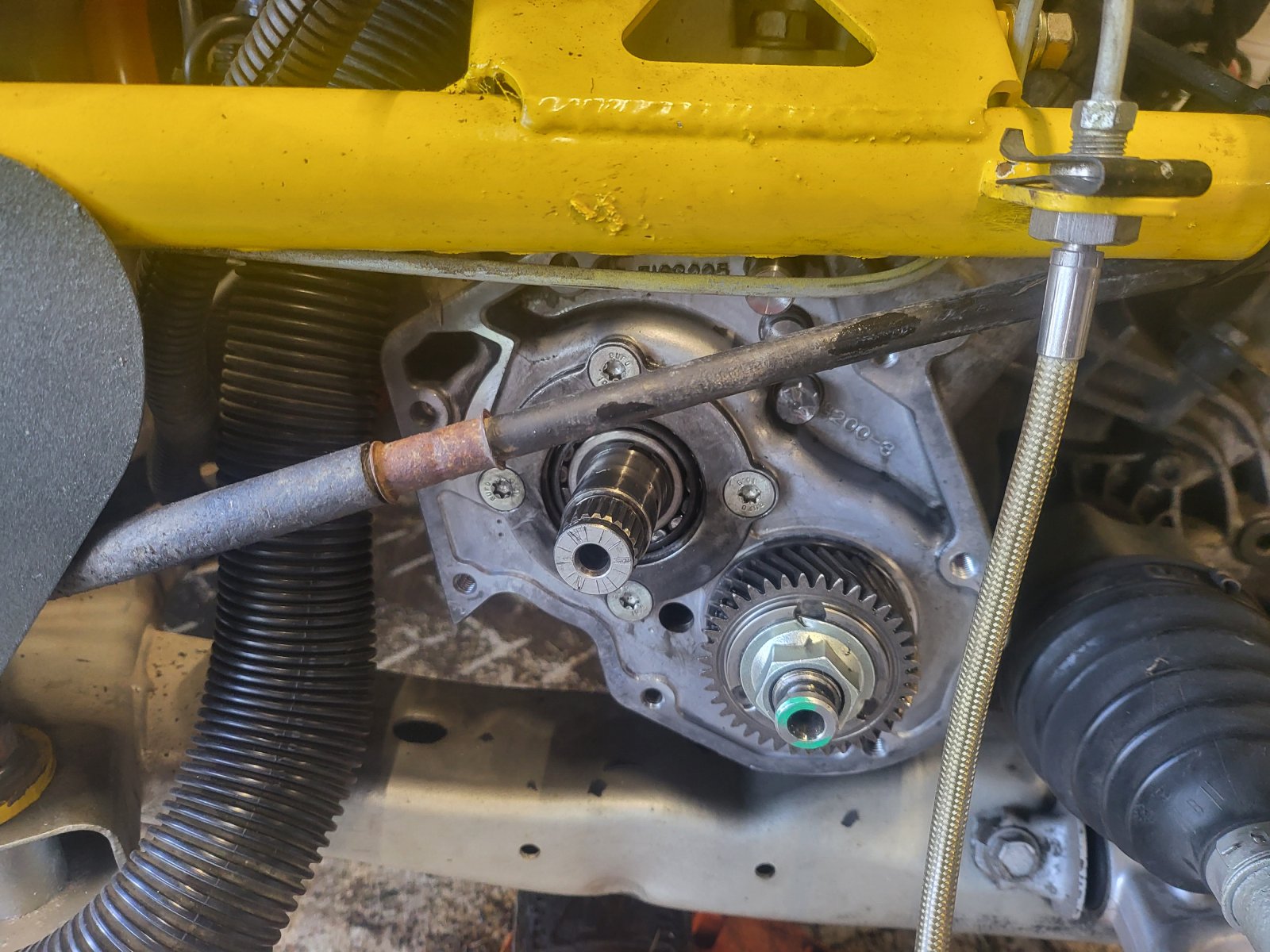

To elaborate a bit on what the problem actually was, and maybe to help someone else having trouble....Here's a few photos of the disassembly, and what went wrong.

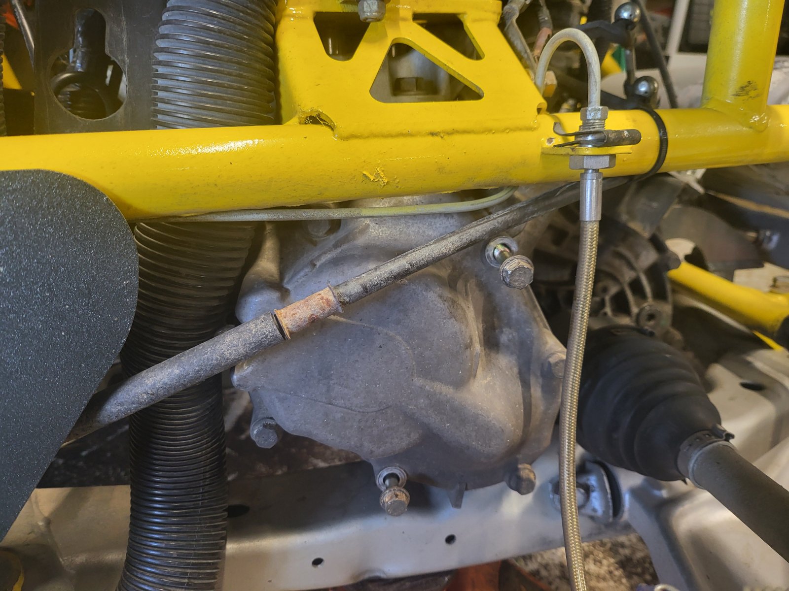

As you can see, 5th gear is just under a cover on the left side of the transmission. It can be accessed just by removing the left rear wheel. Recommended to jack up the left side of the vehicle, otherwise you'll lose all your trans fluid. After lifting the left side, I probably lost a pint or two of fluid.
48474

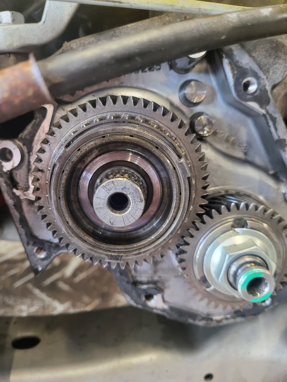

A few bolts and it pops right off, exposing 5th gear on the ends of the input and output shafts.
48475

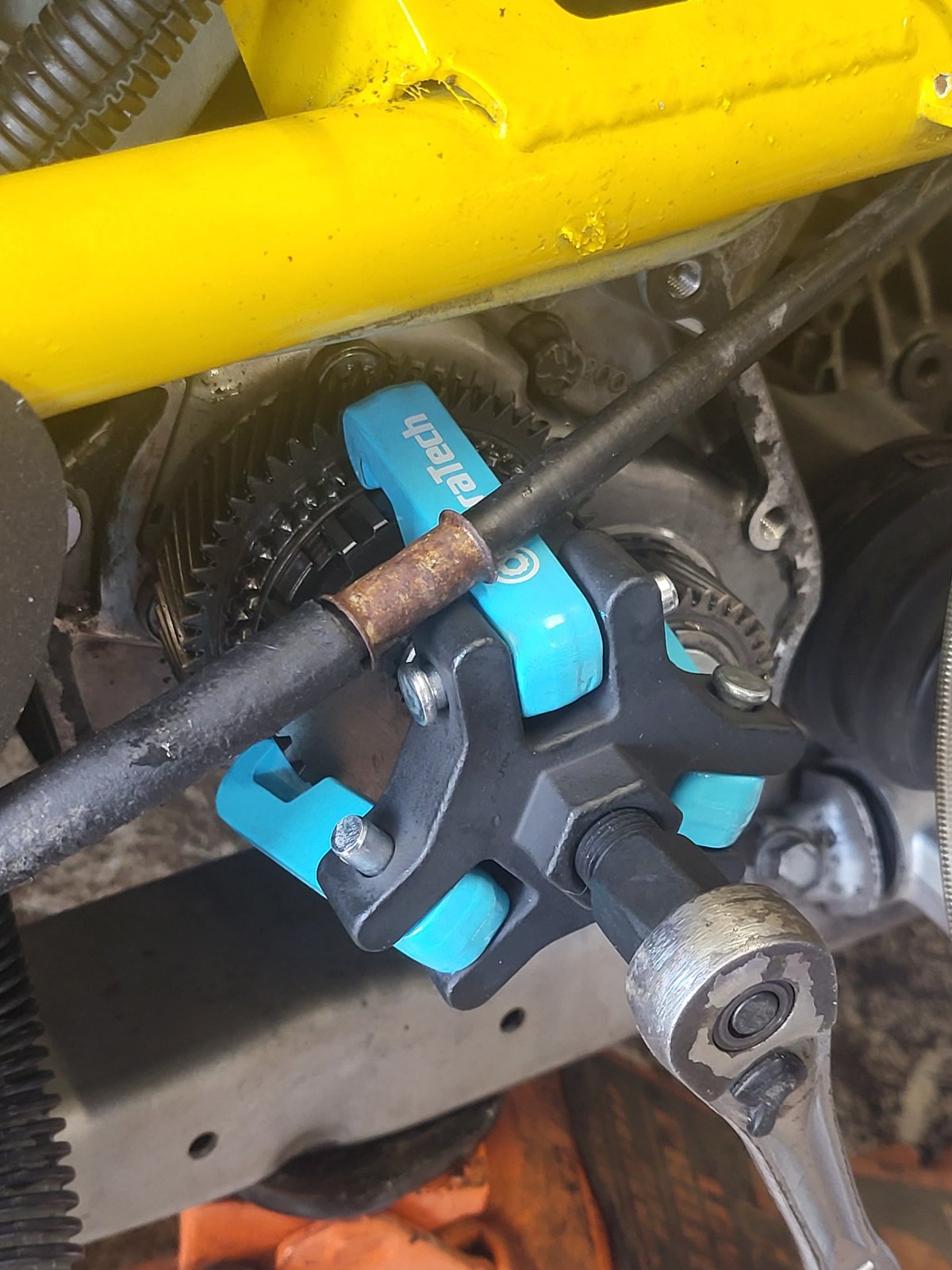

I don't have a photo of it, but the shift fork needs to come off next. It's held on with a roll pin, but I didn't have much trouble punching it out with a proper roll pin punch (get the right tool....we aren't going to use a screwdriver on a transmission). after that the "sleeve" slips off easily. The end gear hub is press fit onto the splined shaft, and requires a puller to get it off. There are 3 small flexible pieces of metal under there that act as springs. They are supposed to be secured by a metal ring, but when removing the hub, chances are all 3 of them will go flying. Try to keep track of them.

The hub removed, exposing splined shaft. The synchro is the next to come off, it just slips off.

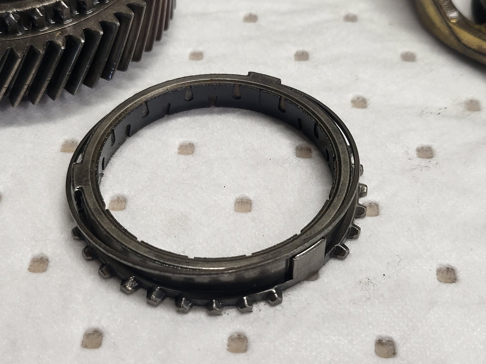

5th gear synchro. In my case, it looks great and is undamaged. It doesn't even seem to be worn.

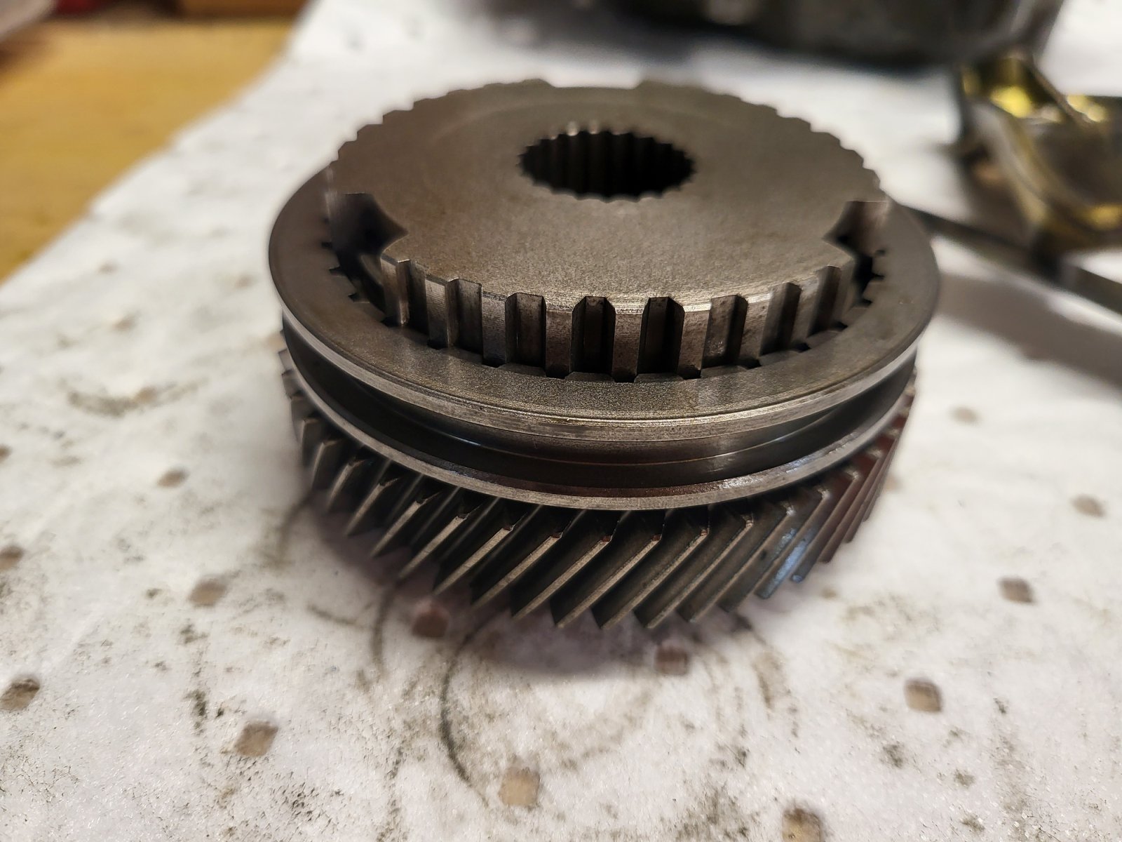

Here's the whole assembly, reassembled on the bench. That ring around the whole assembly (looks like two rings) is the "sleeve", though I've also heard it called a "dog". The shift fork rides in that groove and slides it back and forth, engaging the internal teeth of the sleeve and the gear. It all makes perfect sense in real life when you can play with it, though I understand photos and words probably are hard to picture what's happening.
48479

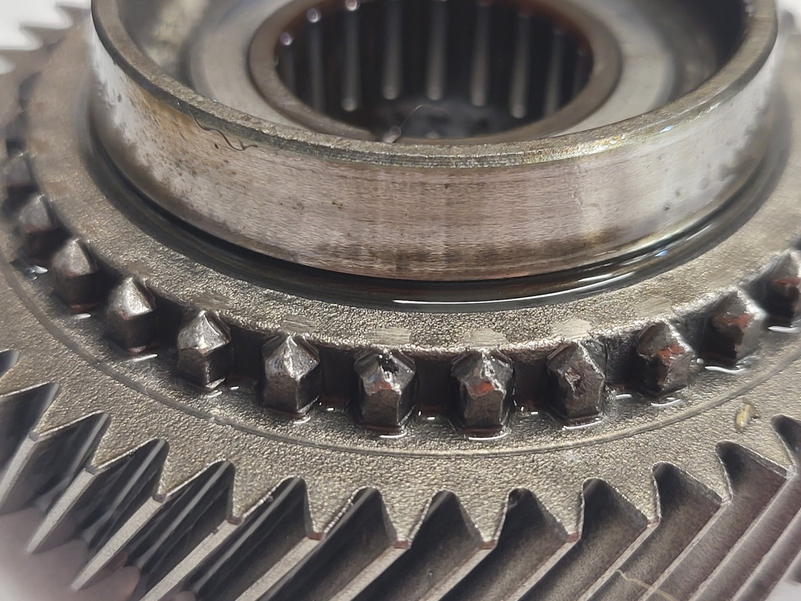

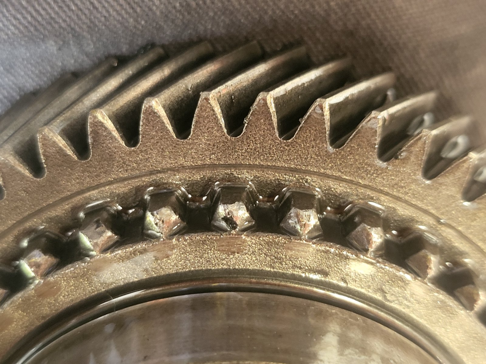

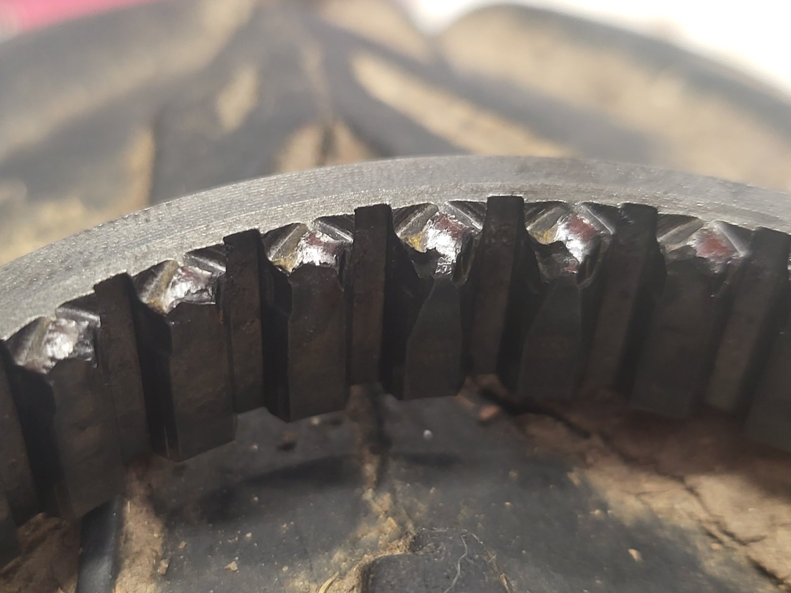

Here's the problem. A closeup of the sleeve teeth:
48480
And here's a closeup of the teeth they engage on the gear
48481
48482
As you can see, both are pretty chewed up. Both are supposed to have little indentations in them, or valleys in the teeth, so that once engaged they wont' disengage without effort. My "valleys" are all gone at this point. So the gears just slide apart without constant effort from the shift fork to keep them engaged (not good, it'll wear out the shift fork).
I can only speculate as to why this happened, as 5th gear isn't a high-load application at all. Nor have I beat on it. However, the donor car was rolled into a ditch. I'm guessing it was in 5th gear when that happened, and the shock loads associated with rolling the car chewed up the teeth. I don't know how else to explain it.
