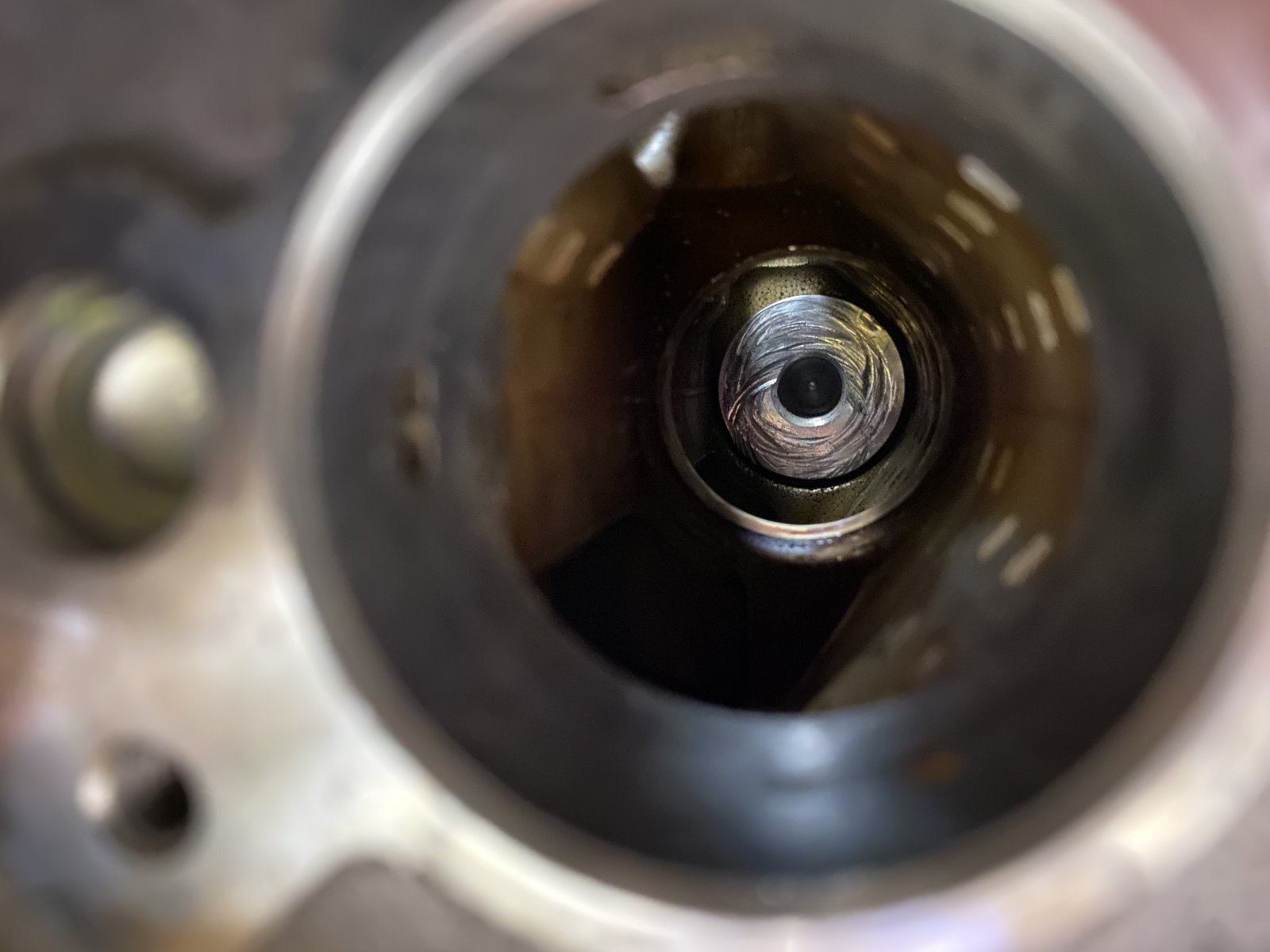

I'm not sure that would bother me. It may lighten up some when you hone it.
What does impress me is the mileage on these engines and the cross hatching still being visible.
I thought the same thing. There’s nothing to indicate it’s ever been opened up. Usually you’ll see silicone where it doesn’t belong, or at least grease pen markings and such. I really am impressed with this series of engines. Especially since they were such an low end/economy offering

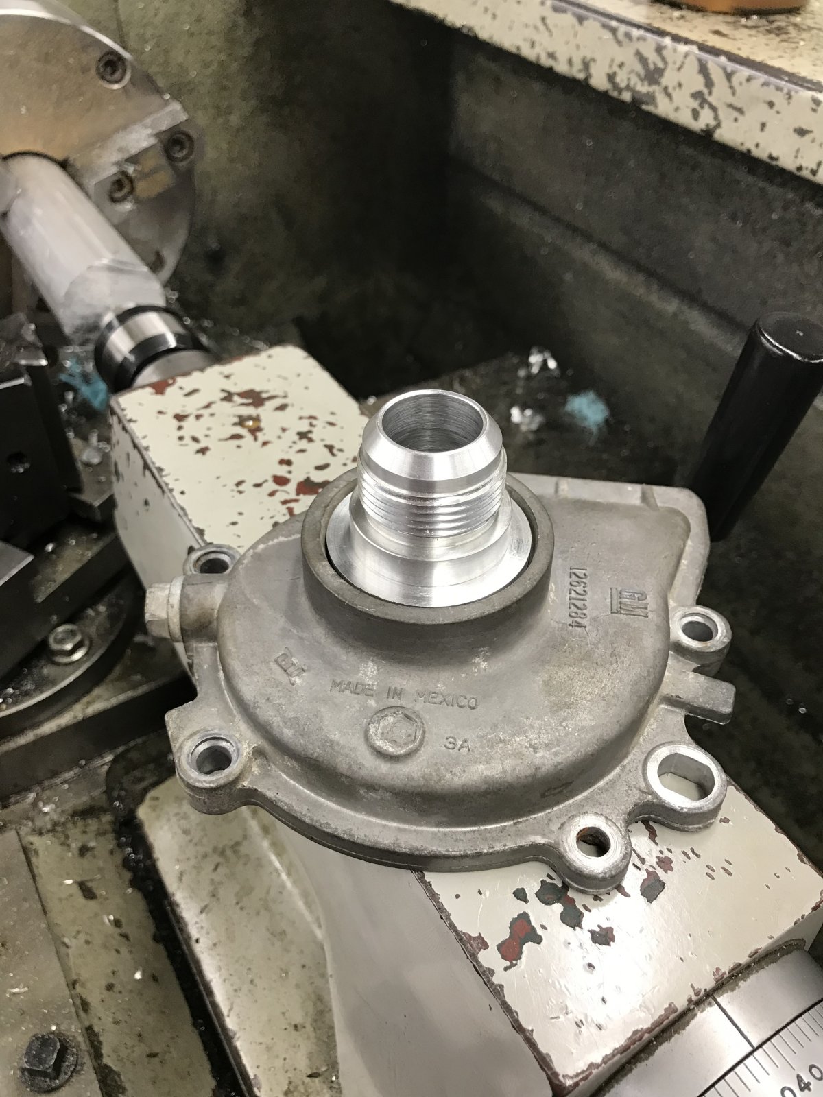

One of the goals of this build was to remove the balance shafts and mechanical pump.
There’s basically two ways to run an electric water pump with our setup. The first is to remove the thermostat and use an electrically controlled water pump which bases flow on water temp. This would probably be the better and easier setup. But to get the pump and controller from Davies Craig it’s $400.
I decided to start with just the pump, but set it up so that I can either run it whenever the key is on, or I can add the controller if necessary later.
I’ll do that by removing the water pipe that spans the back of the engine under the exhaust manifold. I turned two adapters and used Weld-on 16AN fittings on the water pump housing and thermostat housing. It’ll run whenever the engine is on, the thermostat will regulate it, pretty much the same as stock except now not as much parasitic loss on the engine.

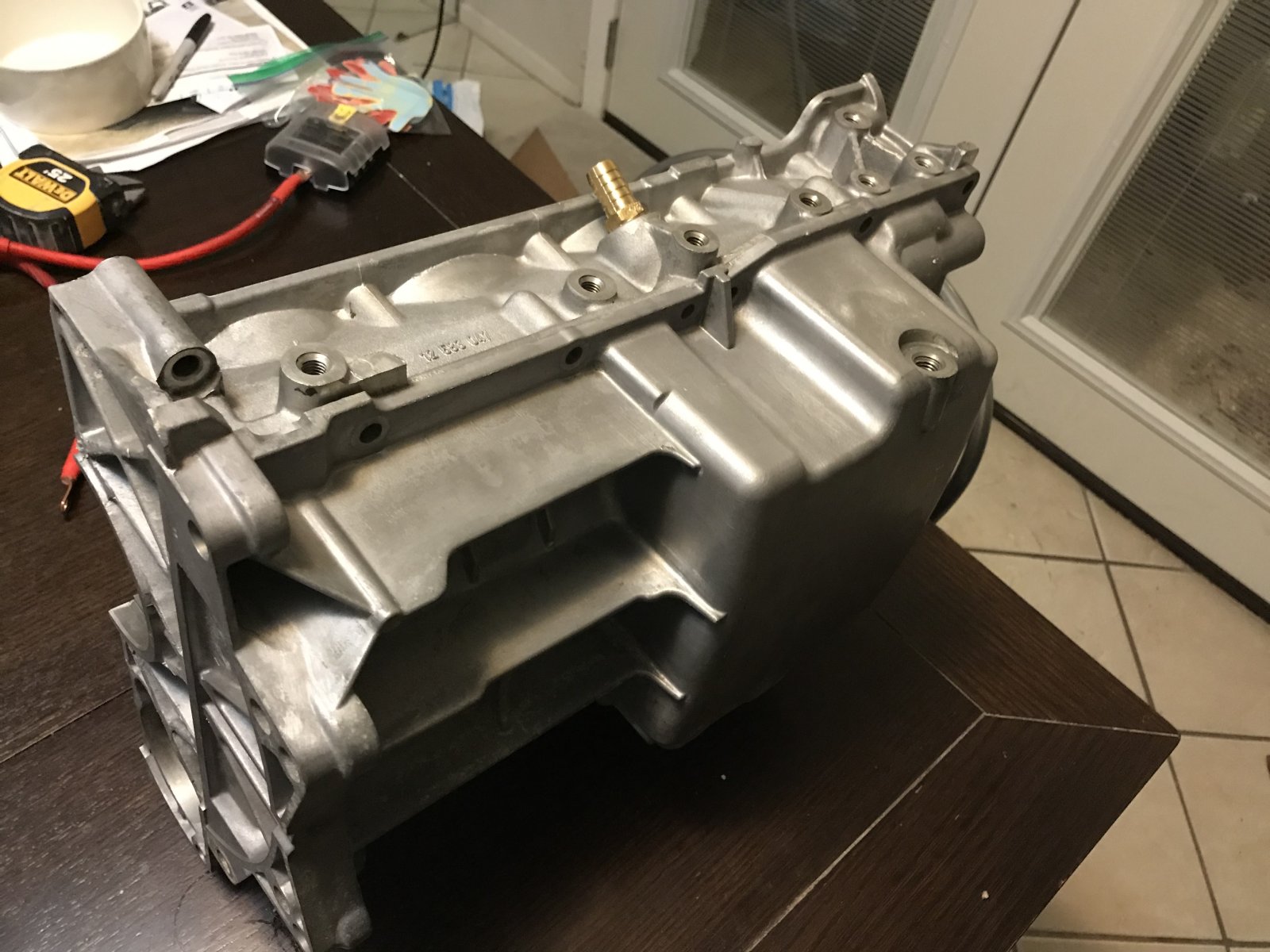

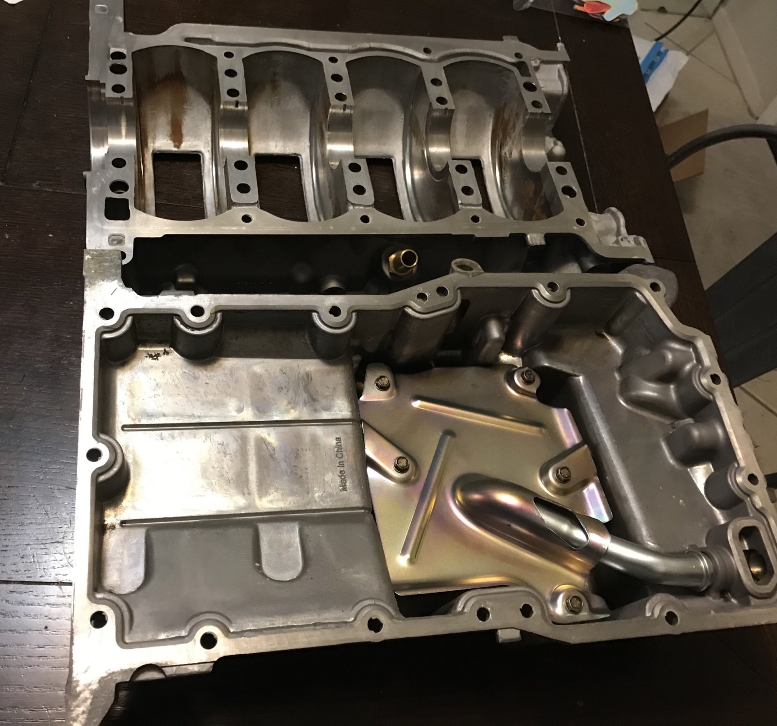

Just received a big package containing full upper and lower gasket sets, new crank bearings and new rod bearings. The engine girdle was just drilled and tapped tonight for the turbo oil return line which is 5/8" hose into 1/2npt into girdle. I installed the ARP head stud kit, sure is pricey but **** they make some nice hardwear.

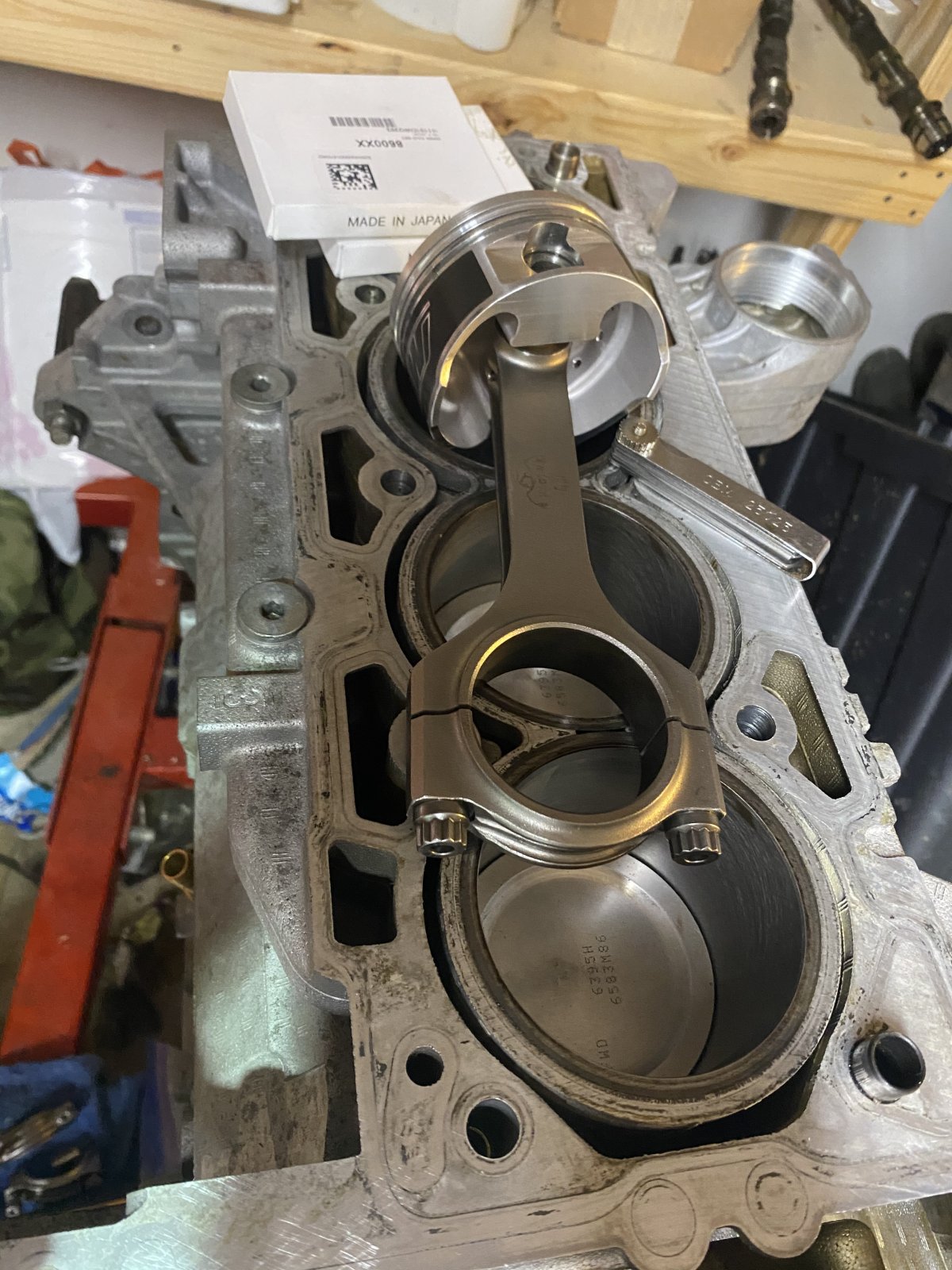

The new Wiseco piston rings are getting fitted to the individual cylinders. Gapping the top rings to .017 and bottom to .018. The new rods and pistons sure are pretty, and have about a 900hp rating!

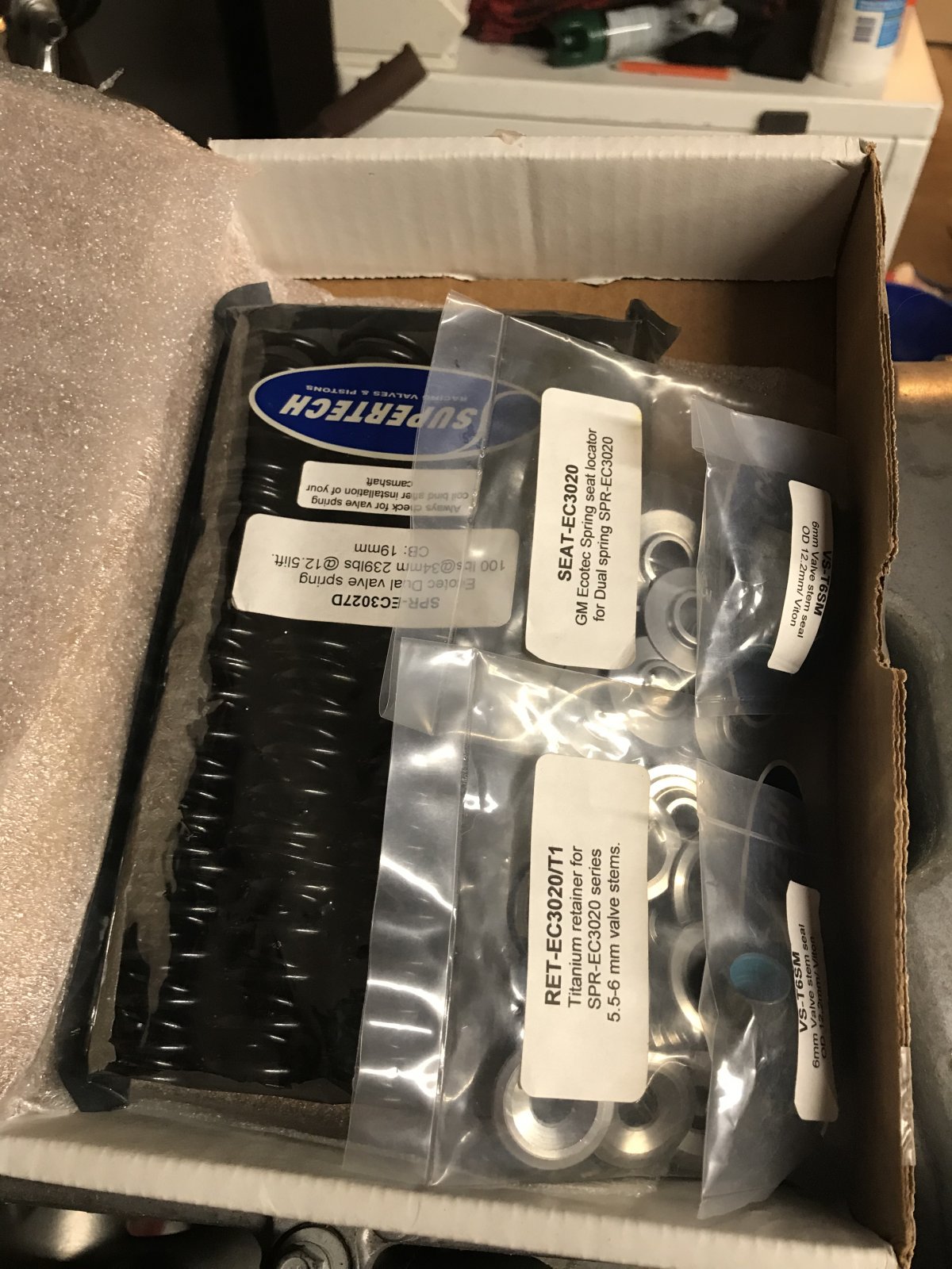

Next up on the order list is the ZZP 82# valve springs and LNF valves. Once again parts place is 2x-3x times the price for the valves compared to ZZP.

Focusing on cleaning and paint next, working from the oil pan up. 1 hour soak in ZEP aluminum safe heavy degreaser and then about three more spent scrubbing with all different sorts of brushes. All the mating surfaces polished with scotchbrite until no residue left. Looking **** fine for a 10 year old engine if I do say so myself.

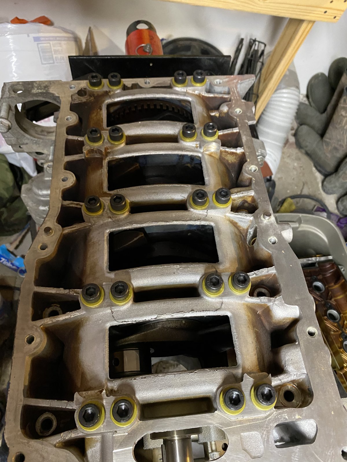

Today installed new clevite crank bearings And the crank. Using OTTP reusable main bolts. Also Installed The OTTP balance shaft eliminators. It’s kinda funny they sell them as if they’re removable...they ain’t. Had to beat the absolute **** out of them to seat all the way.

Gapped piston rings for the wisecos today. Man that was more tedious than I expected. I wish I would have bought a dedicated ring grinder but the file method works ok too.
Surprisingly the 2nd (lower) ring gap was quite large out of the box. The wiseco formula indicated I needed 17 thou top gap and 19 thou lower gap. Top gap out of the box was 13 and lower was 22 but apparently that’s not a big deal.
