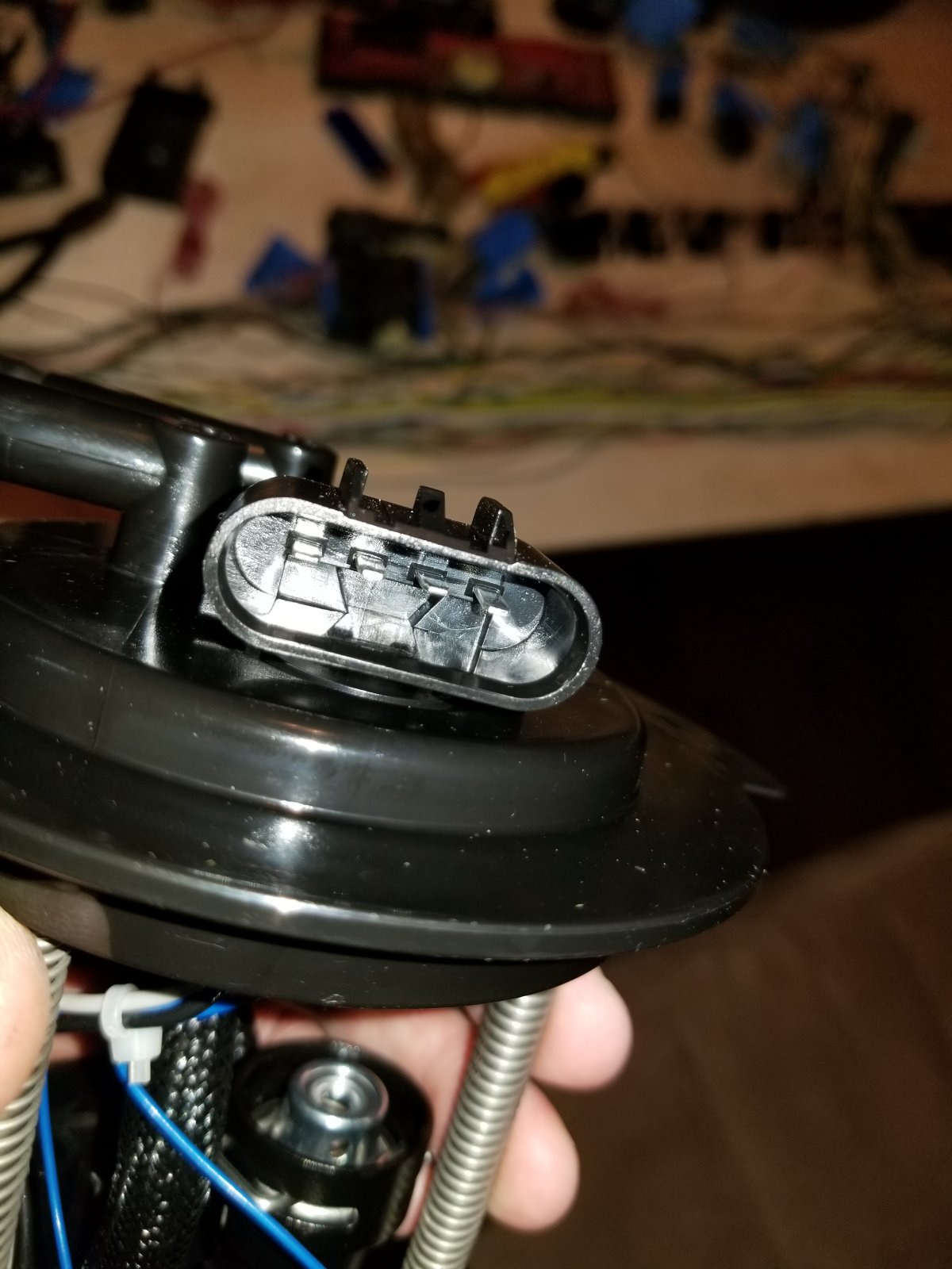

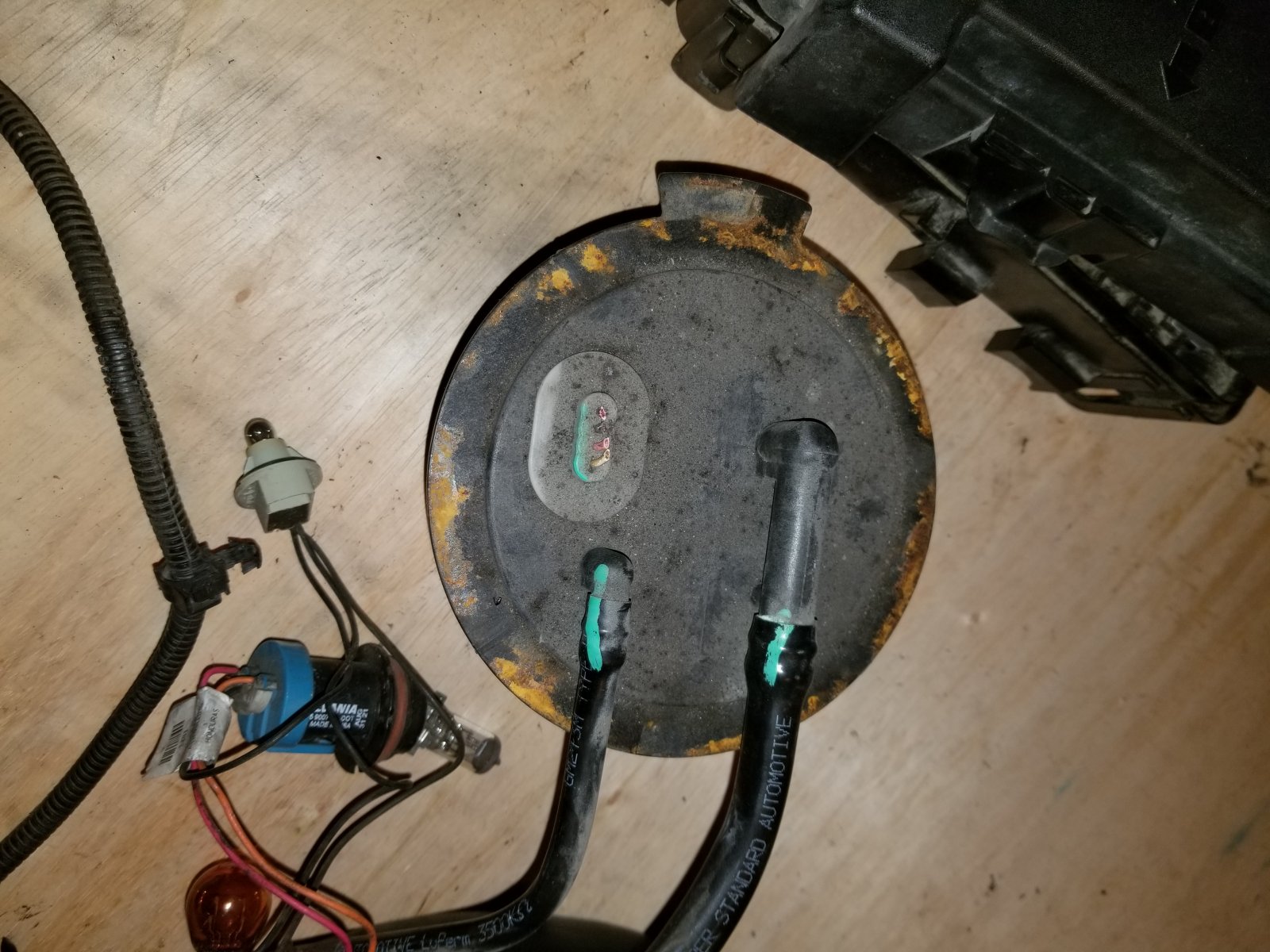

My 2009 had a different style float assembly. It was incorporated into the bottom of the fuel tank. The upper part that the lock ring held in, it's wires were hard wired in through the top of the sending unit. The 2006/7 unit ,about 1.5" smaller in diameter, than the 2009 has a plug that is supposed to connect to it.

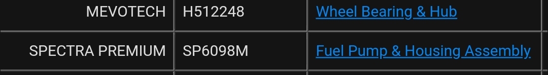

There were at least 3 fuel pumps for the 2009 Cobalts. The SS has it's own part number. The LS/LT had a standard and a California/Zero Emissions version. Rockauto has pictures of the various options.
D
This is my fuel pump. It was like $105 from rockauto back in 2020. Direct drop in.

You are correct!!! yesterday I was going through ,,,many different numbers on my NAPA site. ordered a FA10003 (FPW6) Delphi harness for a 1999-2003 Silverado. it is the one I need for the 2006-2008 Cobalt fuel pump harness!!!
