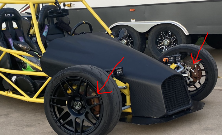

You might also want to consider the front brake calipers. You may have to disassemble and reassemble but they will never be this clean and easy now.
After all, you don't want to pull a Russel :p
