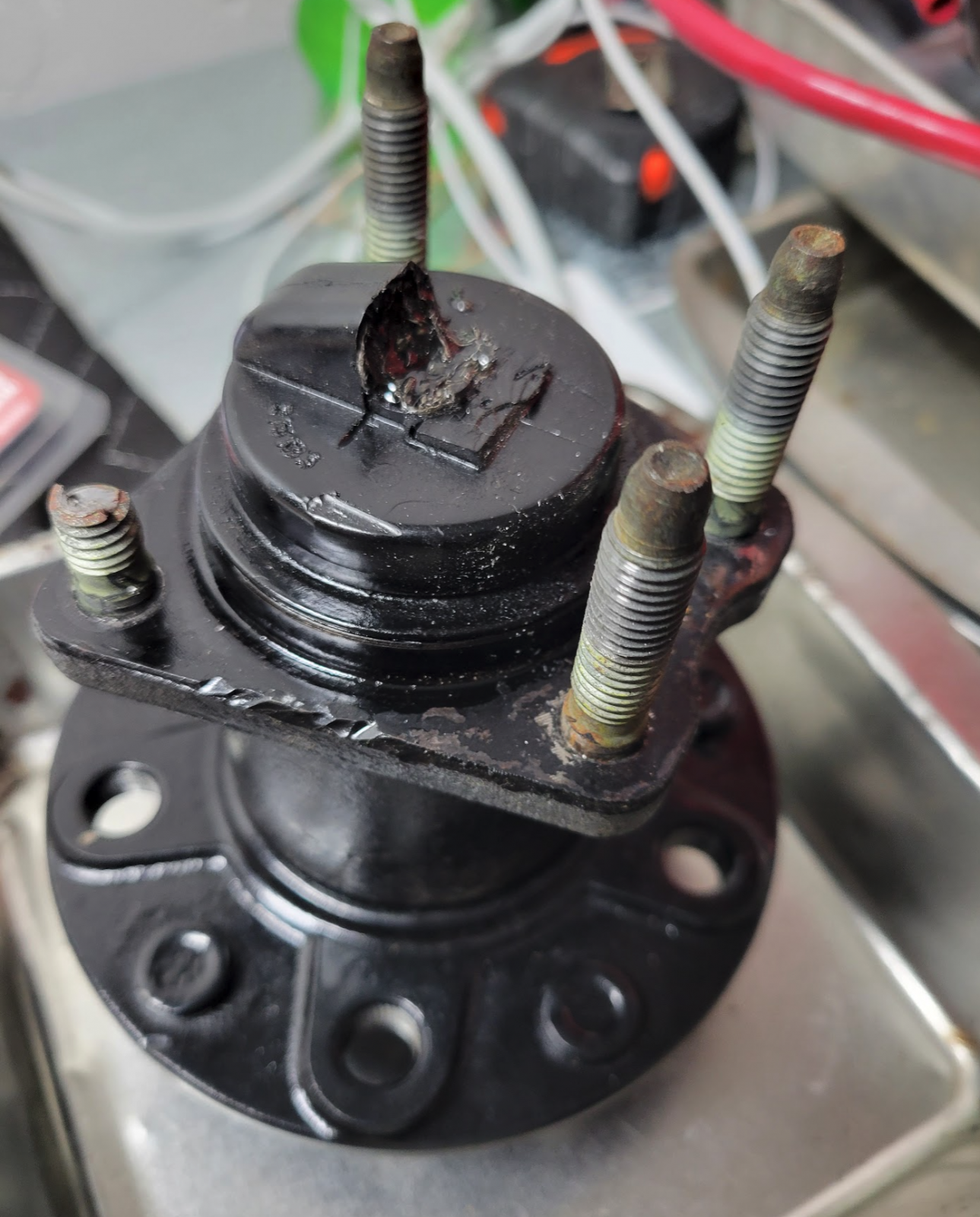

Dusting this thread off for a couple questions. I bought a work-in-progress car and it came with 5x114.3 hubs. I'm going over the work done by the prior owner re-checking everything, verifying torque, etc. I found this fail, left front, where the hub bolts to the Goblin suspension:
33300
So my questions are:
  1. Are those studs replaceable? They look screwed in, but I'm not sure
  2. If the studs can't be replaced, is there an orderable part number for 5x114.3 hubs that fit our cars?
  3. Does the 2009 Cobalt SS (TC) use 5x114.3 rear bearing hubs?
Judging from the comments here and elsewhere, looks like I need to source hubs direct from DF, I was hoping there was a Moog part number I could just order.
Thanks for any help and clarity!

I have only heard of custom redrilled hubs for 5x114 for our cars.
Usually studs are replaceable. Sometimes people order longer ones.
R
That looks like a mounting stud, not a rotor side stud. They’re usually pressed in, not screwed in. But I’ve never tried to replace one of those studs so not sure if any local auto parts stores have them.
If you can press it out you could probably just replace it with a bolt that fits tight in the hole, if you can get to it with a wrench. If not you might be able to tack weld it in place.
WYGoblin
I am pretty sure mine were screwed in. If I am recalling it right I had some the stud came out before the nut broke loose. (I could be wrong. It has been a couple of years now) I would definitely take a close look at it before trying to press it out.
I looked at one of my hubs and it looks to me that your broken stud is most likely screwed in. The back side of the stud has no head which means if it was pressed in, it could be pulled out if the nut was overtightened. Wheel studs, which are pressed in, have a head which prevents them from pulling out when the nut is tightened. I would heat around the stud before screwing it out as it may have thread locker on it.
Probably even better if the old stud can be removed. If the threads are the same on both ends then a bolt can be cut or you can buy studs. If different threads on each end you can buy studs that way or maybe someone on here can pull out their olds ones if they are replacing their hubs. I used new hubs but put the old ones on the donor when I got rid of it.
