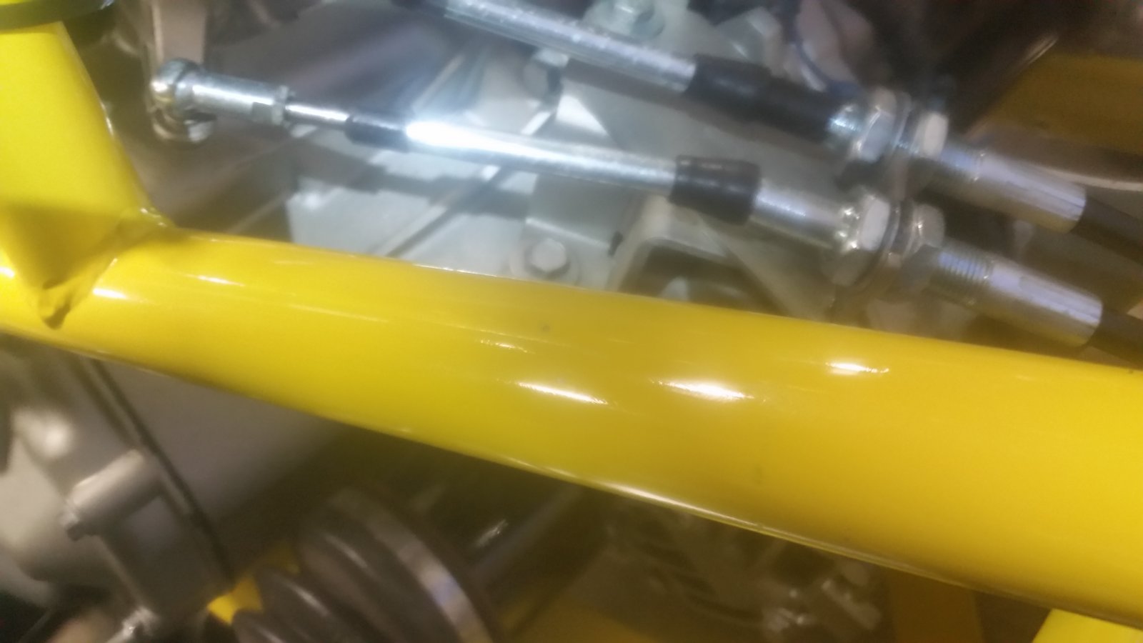

Just for the forward/aft linkage or on both linkages? Do you have a photo of your setup?
I did both ends of both cables. Adjusted cable at shifter pulled back as far as the lock nuts would allow then use the transmission end to adjust.

This is how much was removed. Left just enough thead for end and lock nut.

On the cables I received both ends had to be tried to make it work. Could be a batch that was at the long end of design spec
Brad
I just cannot see how to get the side-to-side cable to even attach to the transmission without having to shorten something like what Brad did. I'm going to try the lower hole in the bellcrank and that should pull the cable (shorten at the rear of car) but at the same time this will cause the side-to-side overall through to be shorter (basically making the horizontal shifting closer and a more narrow pattern). The only thing that I can see that will help it to shorten the overall length of the cable by trimming the threaded ends like Brad did. I'm just very cautious about cutting, you can always cut more but not cut less.

Your car and mine were completed at DF about the same time. So I beleive The cables were in the same production batch. Even after you shorten them the housing has to be pulled back to about the limit, in my case any way.

After shortening the threads on the transmission side to the bare minimum, did anybody find a need to shorten anything on the push rod side? The reason I ask is my reverse is still slightly annoying to get into. It's definitely easier after I cut the threads down to like what Brad posted, but it's still not nearly as smooth as gears 1-5.
I think it will be something I can live with, but I was just curious if anybody still has this "issue" and if they tweaked anything else to smooth things out a bit.
