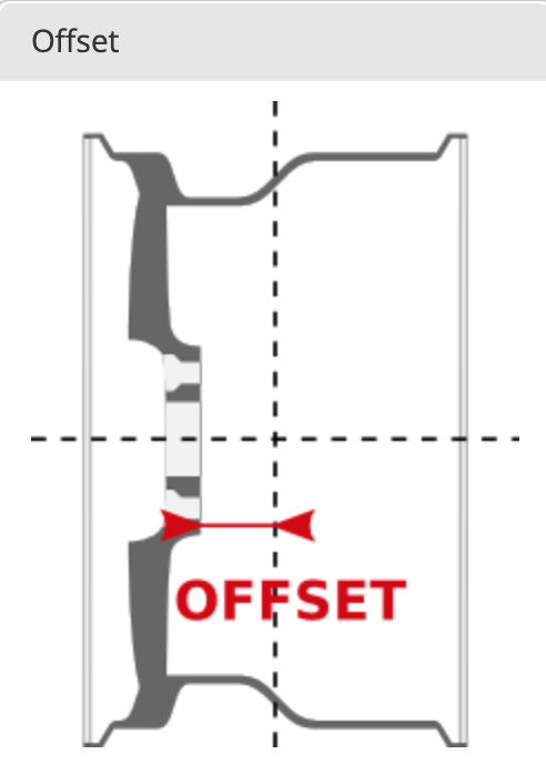

And how does one know what the correct offset is?
34216
I found a lot of good info on Wheel-Size.com. Ross has lots of good info in his post above and others, and the website he uses, BigWheels.net seems pretty good. Also lots of good posts in the Tire and Wheel section on the forum. The correct offset will depend on several things like wheel width, spacers/adapters (if you're using any), and even appearance, and it may vary front to rear. In the front the steering geometry like Ackerman is affected by the offset. In the rear its mostly track width and strut clearance.

The website and Ross' linked post do the same thing. You can find the offset and back space for a stock Cobalt wheel online and you know that wheel fits. From there you can use the offset and back space of your new wheel to calculate spacer thickness to have the inside of the wheel in the same location as the stock wheel.

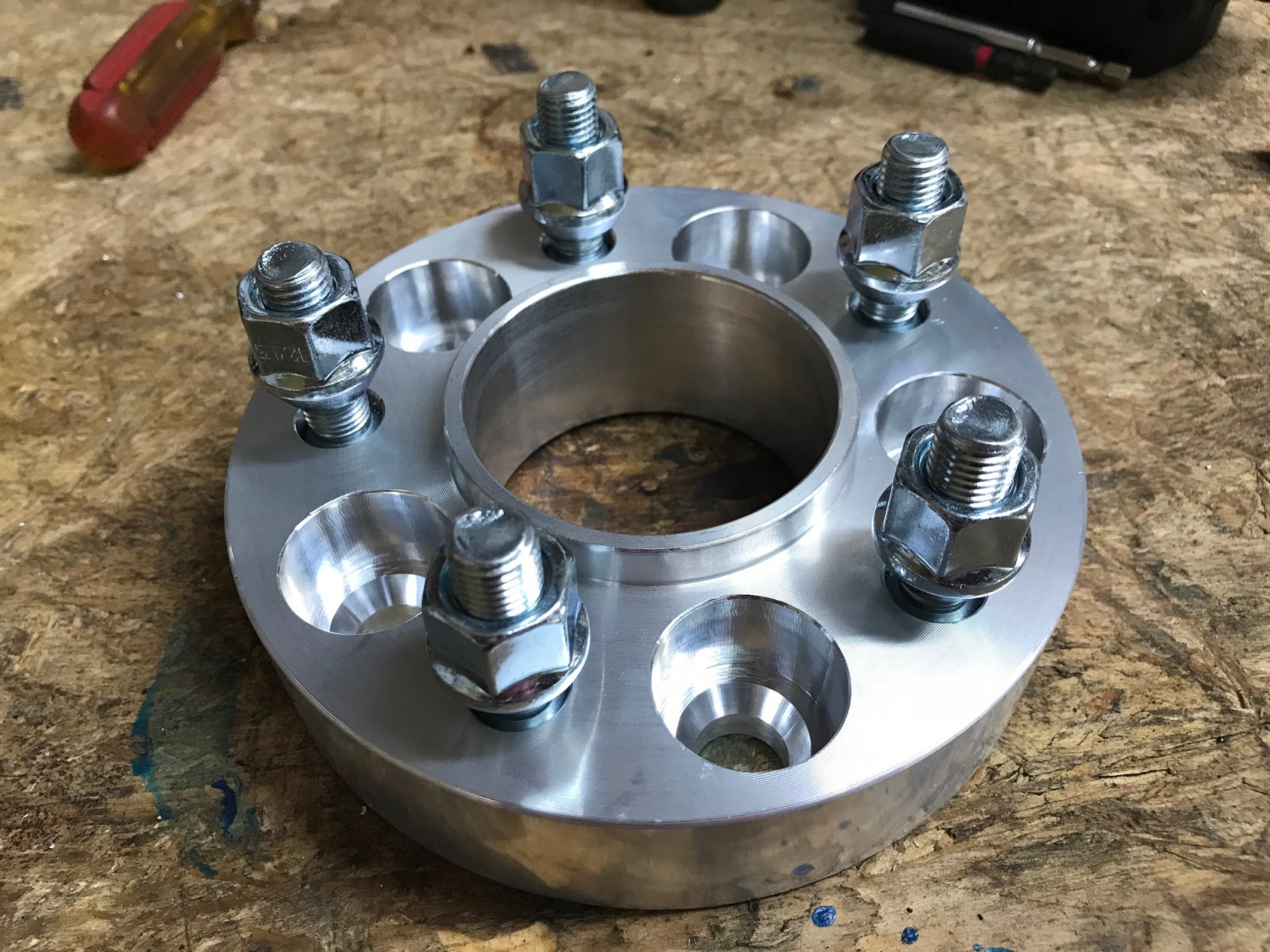

What company did you get the spacers from?
This is the data I supplied to them:
  • HC to Car WC to Wheel
  • Studs: 12x1.5
  • Car Pattern: 5x110
  • Wheel Pattern: 5 by 114.3
  • Car Bore: 65.1
  • Wheel Bore: 73.1
  • Thickness: 32mm
