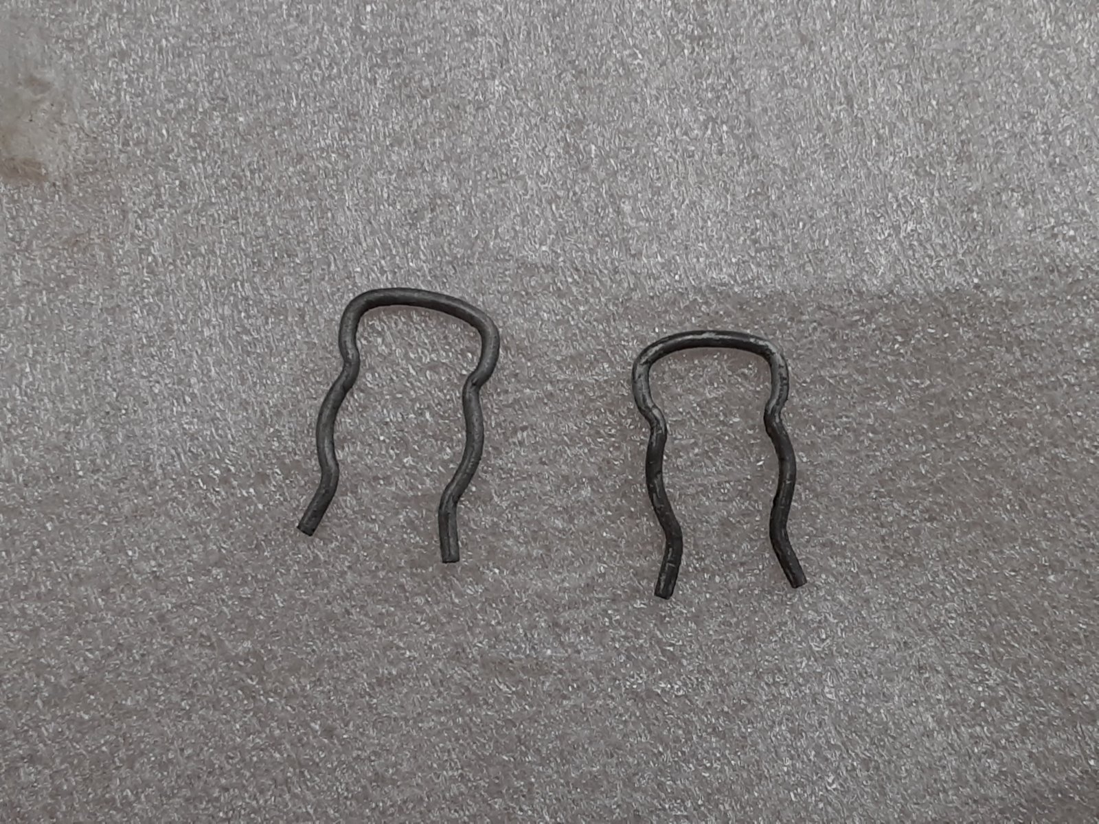

Greetings all,
Trying to button up the suspension, brakes and clutch and bleed the lines before moving on. Ran into a snag trying to clip in the clutch line into one of Lonny's new F35 transmissions. Do any of the Gurus out there recognize if the clips below are the correct versions (one is from the donor, one is from ZZP)? and, more importantly, what is the closely guarded secret to assembling the line, clip and fitting on the trans?

You are putting the clip on so the dents go thru the slots, right?

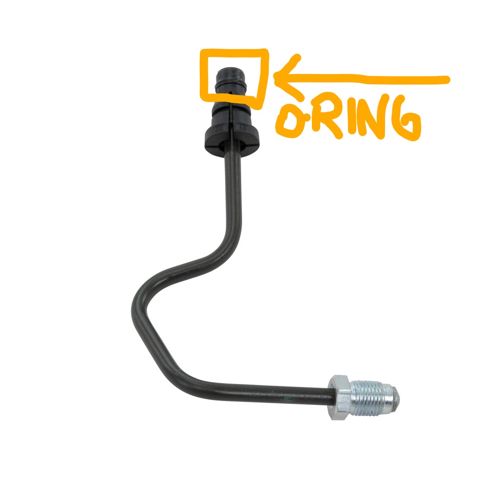

There is a rubber grommet/o-ring at the top of the TOB pipe that gets stuck inside the clutch elbow and leaks. Make sure its on the TOB pipe before you mate the clutch elbow to the pipe.

@Ross, I appreciate you operating as the "Easy Button" when it comes to Goblin/Cobalt questions. Your drawing showed me what I was doing wrong - I was trying to force the clip down vertically through the slots. My feeble mind couldn't come up with an alternative configuration. I give myself partial credit for saving the clip from the donor (and finding it after 8 months) and 10 demerits for not remembering how it gets used.
The O-ring on the DF-supplied clutch line is in good shape and I've lubed it with brake fluid each time I've inserted the line into the elbow.

You can put the clip in first and then push the pipe in.
If you are mixing old and new components, make sure you don't end up with 2 o-rings at a connection. I chased my tail on a leak for several days before I realized I had an old o-ring still in a fitting.
